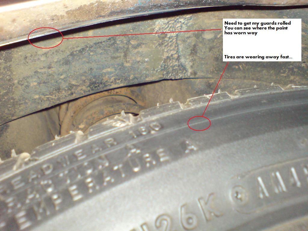

Here's a problem on my rolla thats getting worse.
Does anyone know where i could get my gaurds rolled (eastern suburbs) and a guess on how mush it would cost?

Dunno about a place to roll your gaurd lips, I hear it isnt very hard to do......
Can I roll the gaurds my self? What would i use? A hammer?

all i used to roll my guards on a ae82 sdn was a rubber mallet (not to heavy tho)
it bends really easy where it comes in towards the wheel because there is a bend already there.
cheaper than paying a panel beater to do it.
Thanks, i want to do it this weekend but i wont have the time. :lolcry:

I rolled my guards myself. Heated up the paint a little bit with an old blow heater, then used a little vice with 2 blocks of wood and a rag. Just tightened it up and went around gradually. Didn't turn out amazing but it did the job. It also flaired the flats out in line with the angle of the lip which I thought was cool.

did it only start rubbing when you put the new mags on there????
i don't know what there formal name is, i call them folders or duck bills, they are a proper sheet metal tool. they might do the job if there is enough room. also because there is a fold already there it will be easier, just go nice and slow don't bend to much or you will put an ugly crease in it. If you were in adelaide i would do it for you. they look like this all hardware shops sell them
