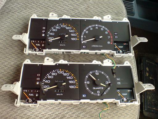

Johno Posted June 23, 2008 Author Report Posted June 23, 2008 Doesn't it annoy you to not have a tacho? CSX dash clusters are a straight swap, no wiring for the tacho necessary, looms are identical between the cs and the csx. Just unplug the old one and plug in the other. Hardest part is the speedo cable can be a bit fiddly. I rolled my guards myself. Heated up the paint a little bit with an old blow heater, then used a little vice with 2 blocks of wood and a rag. Just tightened it up and went around gradually. Didn't turn out amazing but it did the job. It also flaired the flats out in line with the angle of the lip which I thought was cool. Interior trim looks awesome :( Yeah it does give me the shits about not having a tacho, I was going to put one in but i thought i need to put in a rev cable from the dizzy or something. The CSX that i got the seats from still has the dash and it's in overrated condition. i might go there next week and get it. Thanks :) Quote

Johno Posted June 24, 2008 Author Report Posted June 24, 2008 Doesn't it annoy you to not have a tacho? CSX dash clusters are a straight swap, no wiring for the tacho necessary, looms are identical between the cs and the csx. Just unplug the old one and plug in the other. Hardest part is the speedo cable can be a bit fiddly. I rolled my guards myself. Heated up the paint a little bit with an old blow heater, then used a little vice with 2 blocks of wood and a rag. Just tightened it up and went around gradually. Didn't turn out amazing but it did the job. It also flaired the flats out in line with the angle of the lip which I thought was cool. Interior trim looks awesome :( I went to pick-a-part today and got a new dash, unpluged the old and pluged in the new one. can't beleive I didn't do this before! It works a treat. Thank you heaps! ;) :) Quote
