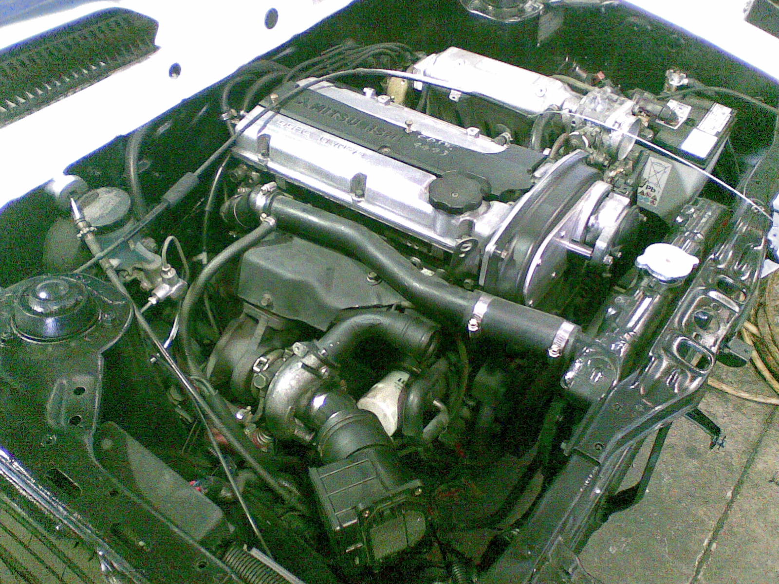

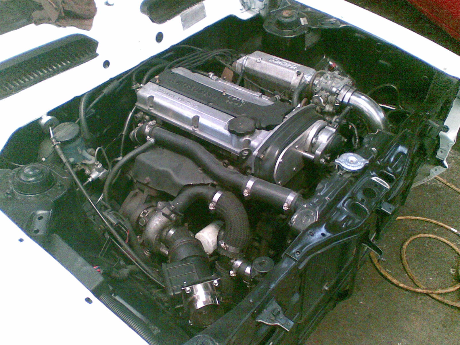

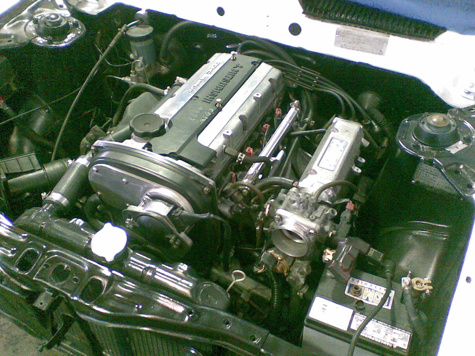

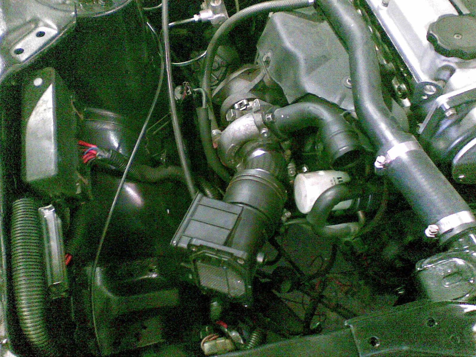

Ah now i have an update, i have done a little, bit of fiddling, and not seen in the photos is, the accelerator cable mount, the pod filter adaptor, and to be added soon is the inlet plumbing, getting some bits welded up tomorrow.
As far as progress goes, i have mostly been lazy and what you see in the pics has been completed for a while, just havnt taken any, most of my time has been taken up by fidely things like, coil mounts (rear of plenum), accelerator cable mount (not pictured) adjustable accelerator cable hammer thingo, air reducer, to take the 1.5" outlet of the turbo up to the 2.5" inlet plumbing (being welded into mandrel bend tomorrow, all stainless). Improved the CAS drive mechanism, made a seal for the CAS to prevent dirt etc from getting in the sensors.
All that i have left to do now for the engine side of the project to be complete is the inlet plumbing and the exhaust system.
I still have the interior to put together, and i would still like to get the body professionally done, or at least the drivers door, guard and bonnet tended to but a panel beater, the other dents and things on the car are hard to pick, and would be impossible to remove, old sheet metal.

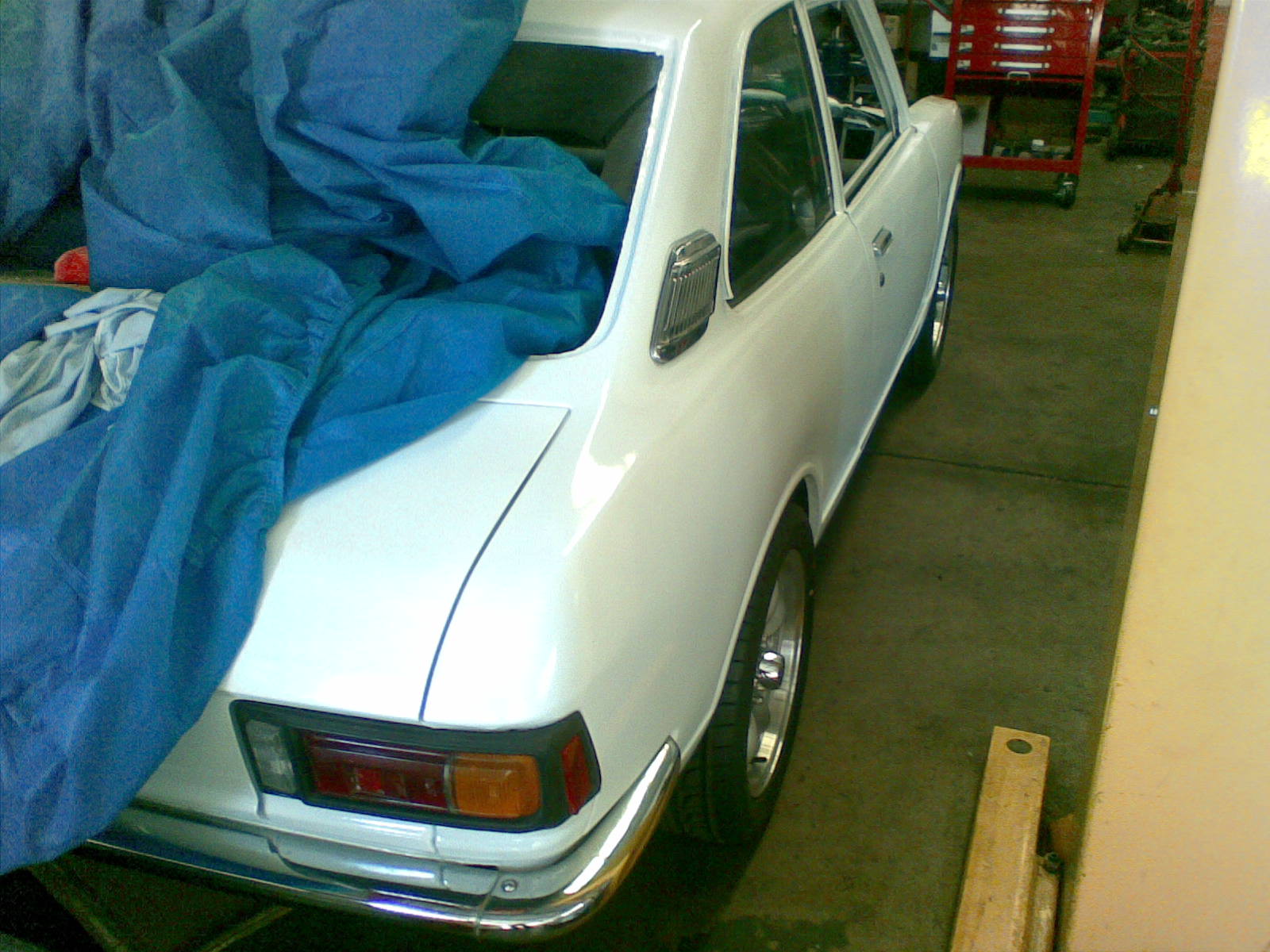

Quick update. Few pics of car at the moment. Have hung the drivers door and fitted latches etc.
