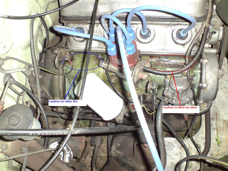

KE70-from-mt-panorama Posted June 18, 2008 Report Share Posted June 18, 2008 Hey all, been looking at a few 3k's lately and also had a few people look at mine that have seen a few aswell, and my engine number is located in a different spot as apposed to all other 3k's i have seen. What (if any) is the difference between the two? Pictures attached for reference cheers Jake Quote Link to comment Share on other sites More sharing options...
dfunkt Posted June 18, 2008 Report Share Posted June 18, 2008 the difference would be the early and the late blocks, your's being an early one...i have no idea if there are any actual differences. Quote Link to comment Share on other sites More sharing options...
Redwarf Posted June 18, 2008 Report Share Posted June 18, 2008 (edited) It's the difference between early and late 3K blocks. Early (generally green) blocks have them where yours are, and later (generally red blocks) have it in the other position. :) *edit: Bugger! SNAP! Edited June 18, 2008 by Redwarf Quote Link to comment Share on other sites More sharing options...
KE70-from-mt-panorama Posted June 18, 2008 Author Report Share Posted June 18, 2008 Ok sweet, Thanks for that. And here i just thought it was green to match the colour of the car. Damn! Cheers for the speed of your reply's Quote Link to comment Share on other sites More sharing options...
lappy Posted June 19, 2008 Report Share Posted June 19, 2008 Both are exactly the same internally just a different position. I have race with both types of blocks and had no probs with either of them Quote Link to comment Share on other sites More sharing options...
