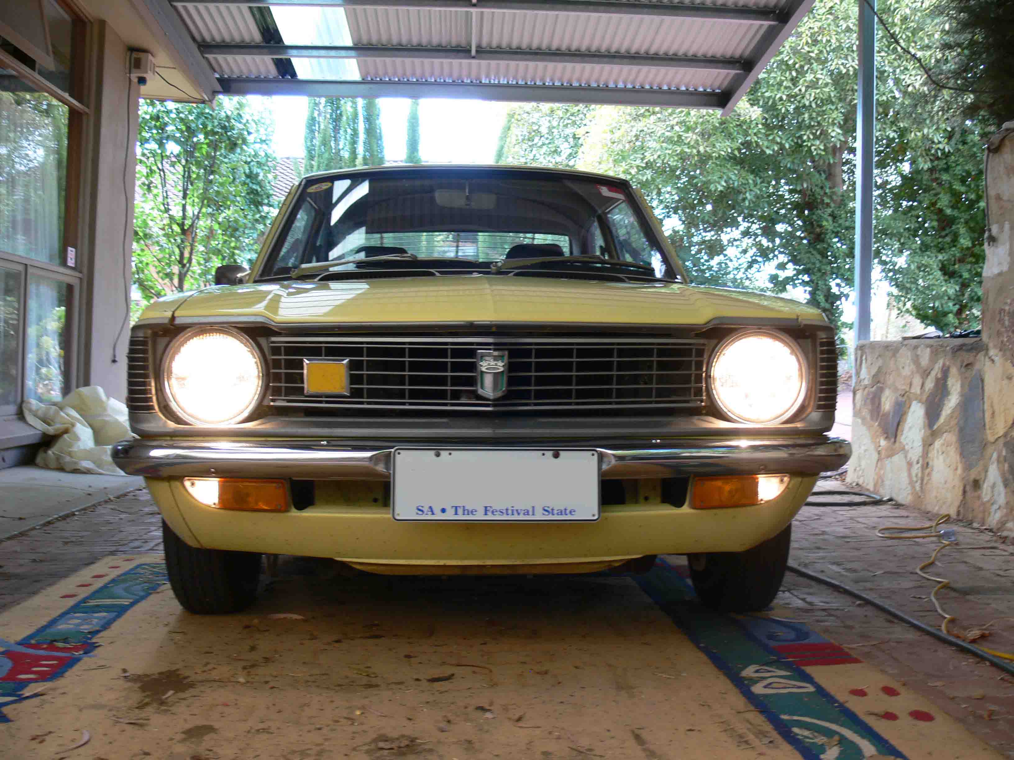

smeetsy1 Posted July 12, 2008 Report Share Posted July 12, 2008 (edited) Recently my 'normal' headlights have gone, its quite fascinating because my high-beam and parkers still work. So at the moment i have been driving around with high-beam on all the time, i feel sorry for oncoming traffic but I'm pretty sure my car is too low to bother them! Tonight when i was driving i was waiting at the lights to turn right, so i pop on the indicator and it flashes for a couple of seconds and then turns off, much like my 'normal' headlights... wtf? and it kept happening throughout the night :P So now i am having to throw my hand out of the car to turn the car whilst having the high-beam on - must look like a twat.... Summing up, has anyone had this problem before? what is the problem? costly? Any information would be much appreciated as this car is beginning to need alot of attention! yours sincerely, will Edited July 12, 2008 by smeetsy1 Quote Link to comment Share on other sites More sharing options...
