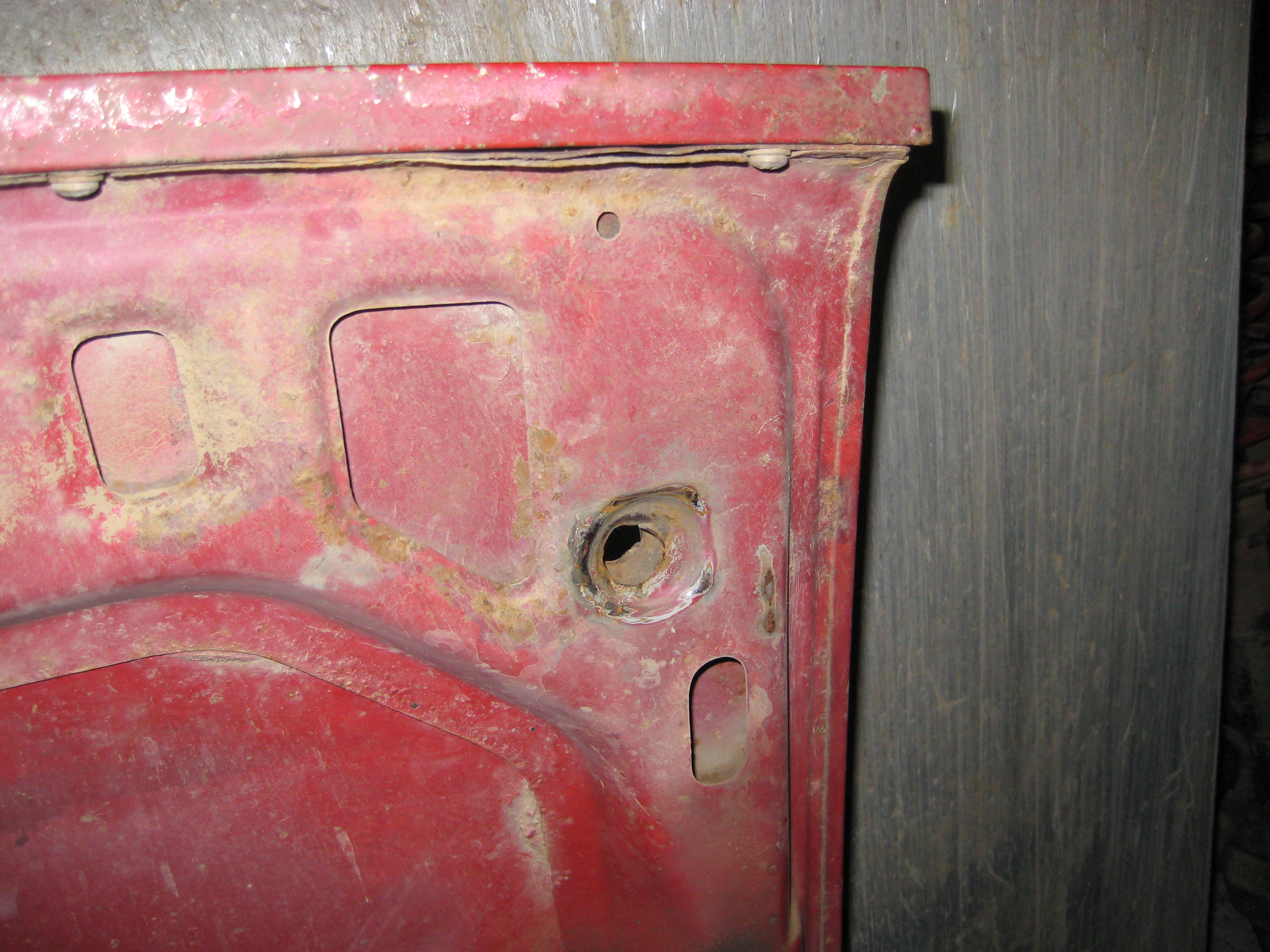

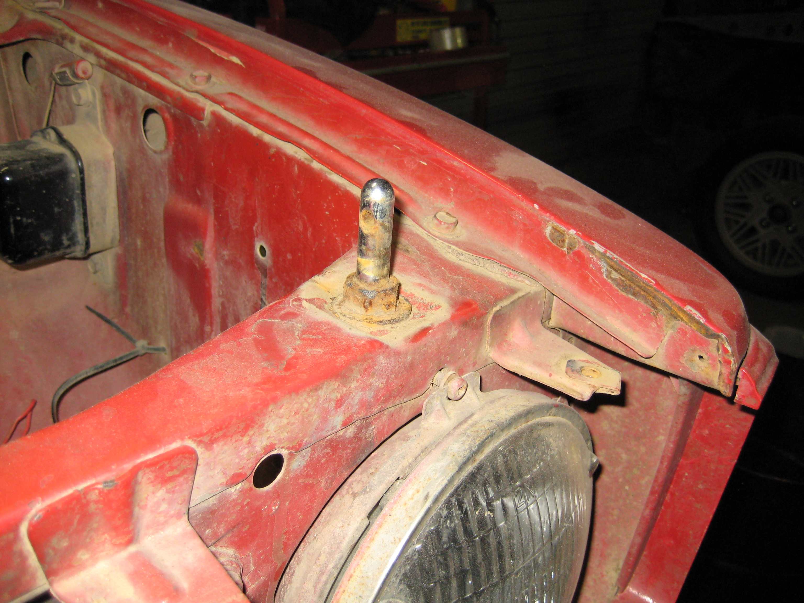

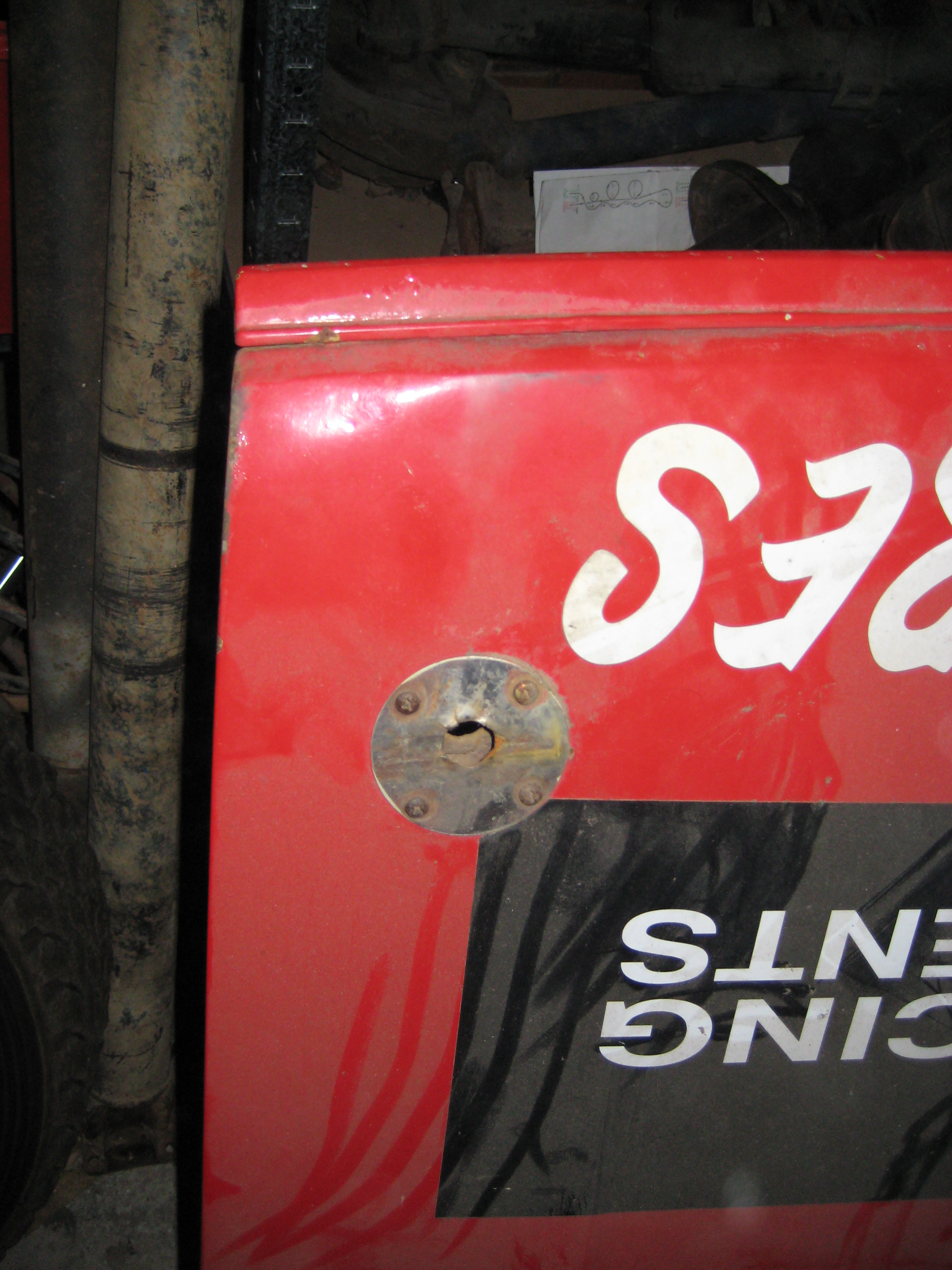

Here we go. Better late than never.
Drilled 1/2 inch hole through where the thraded insert/ nut was for bonnet support. Usually I have a thick piece of rubber over the pin to support the bonnet when closed, but I removed it for clarity.
Hole through bottom of bonnet, in indentation where the bonnet support sits.
Stainless disc on top to prevent paint damage around where the pin goes.
Hope this is of some help.
R
Mine were similar but I kept the factory rubber stops and fitted the pins next to them.
