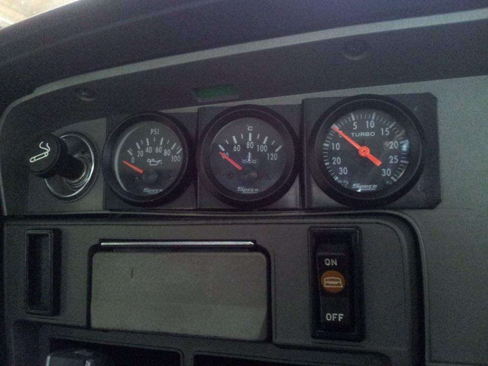

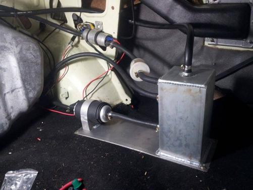

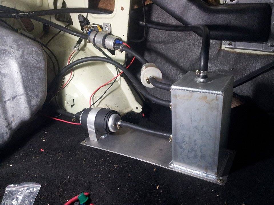

leigh Posted February 12, 2014 Author Report Posted February 12, 2014 Did abit of work on it today and bought some bits. Installed a boost guage and got the loom through the firewall also ran a fuel pump feed to the boot. Purchased a new headgasket and mani gasket for when I get the head off Si. Quote
leigh Posted February 12, 2014 Author Report Posted February 12, 2014 Caught up with Si (Taz_rx) last night and picked up the 4k head. going to clean that up today and measure the CC Printed out the wiring diagram for the Microtech D5 noticed that the fuel pumps are operated by a pull to ea rth Trigger, (you were right Si) So going need to run a few more wires now. Should of checked first instead of rushing into it! :oops: Quote
Taz_Rx Posted February 13, 2014 Report Posted February 13, 2014 Its still only one wire too the boot from the ecu (provided you have power in there) you just need to wire the relay differently. ;) Quote
leigh Posted February 13, 2014 Author Report Posted February 13, 2014 Its still only one wire too the boot from the ecu (provided you have power in there) you just need to wire the relay differently. ;) haha yeah I didn't think when I typed that befor. Got it all sorted now. Just measured the head. looks to be approx 32ml Quote

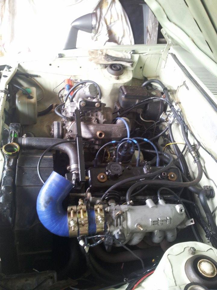

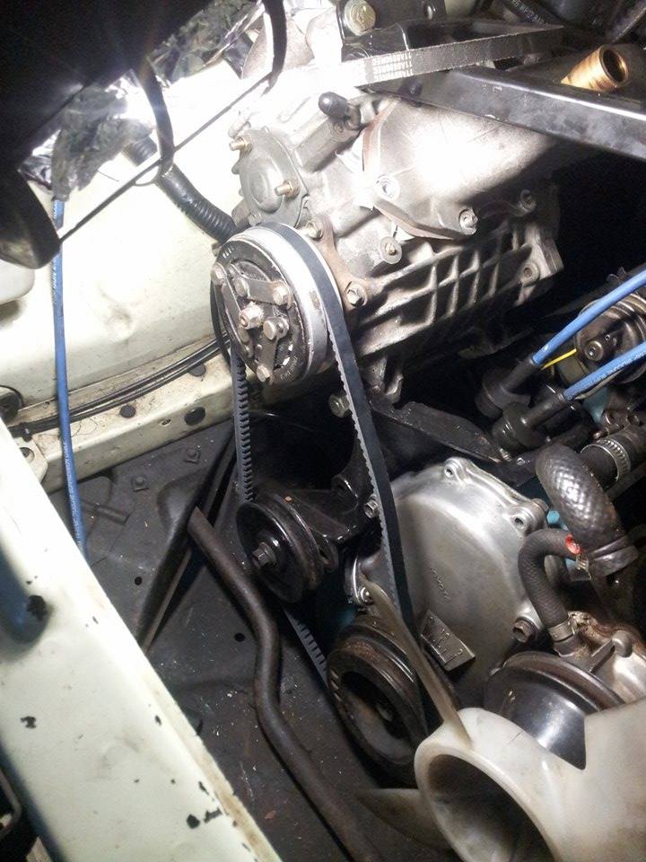

leigh Posted March 18, 2014 Author Report Posted March 18, 2014 Got the blower mount somewhat sorted, just need to tidy up a few things....... Efi hoses installed tonight and cleaned out the fuel tank aswell Removed my twin webers and started to sus out where I can install my wideband sensor, Hopefully get my 4k head back from the machine shop this week aswell after its freshen up Quote
kickn5k Posted March 18, 2014 Report Posted March 18, 2014 Looks like it sits a fair bit higher than it used to. Shouldn't be too much of an issue with the intercooler plumbing, should be able to just trim that 45deg silicone hose to suit. I JUST had enough room to get to the dizzy to adjust timing, but geez that blower can get a bit hot. Quote
leigh Posted March 18, 2014 Author Report Posted March 18, 2014 Yeah thats how it sits on the A/C bracket, Think I will make a custom one later on when I get the clear from the physio to use powertools etc (Stupid wrist) haha Reckon I bet it would get a little warm Stu. So keen to get it running! Quote
leigh Posted May 10, 2014 Author Report Posted May 10, 2014 Welded in my nut for the Air/Fuel ratio meter Annealed my copper manifold gasket Fuel system all sorted now, just need to fit off the fuel reg in the engine bay and efi filter Measured up and bought a v belt today also Turns out the local auto supplies shop gave me a 4k head gasket instead of a 5k one, so now have to wait to get that in before I can slap the head on and start it :) woo Quote
