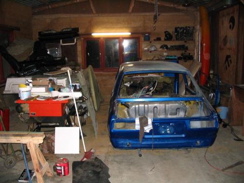

Pulled all everythign out from under the car to tar is and found this, haddent really looked properly under there, i knew there was fiber glass in the bottoms of the quarter panels but didnt bother touchign em till i saw this, so doing alot of cutting and plating now... here progress so far. no welding yet.
Here all the fiberglass/bog/rusted metal i pulled out of the rear quarters and a nice new sheet of metal ready to fill the holes :-)

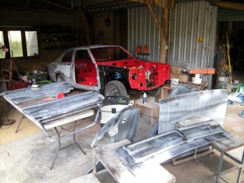

FInally got some paint on.....did some more welding but the gas ran out on the tig welder so have to get some tomoro. still a bit dodgy on the old welder but at least theres good metal plates in there instead of a shitload of fiberglass and bog.
heres so pics of todays work
Makeshift spray booth...didi the job fine for the engine bay, wont be doing that for the body though, bit of shit still got on the wet paint but nothing major.
blingen spray gun...1.4mm, recomended by the the main paint supplier in the area.
Paint look a little light here...is a bit darker and nice in real....its late model commodore "Red Hot" 2 pac

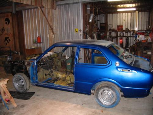

More p;ics.....I got busy today.

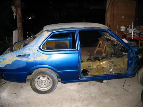

Put a nice set of wheels that are ment for the Ke30 when its done and gave the front left quarter panel a bit of paint where it was bent up adn straightened out again...paint had flaked off and had surface rust...looks better than before.
Also got the tar gun out and did the underbody on the front half of the car, gotta finish some welding on the rear quarters tomoro and then ill tar the rest. Built up most of the steering and suspension at the front, just need to get 4 new nuts for steering with the gaps in em for split pins. will do that tomoro or friday
