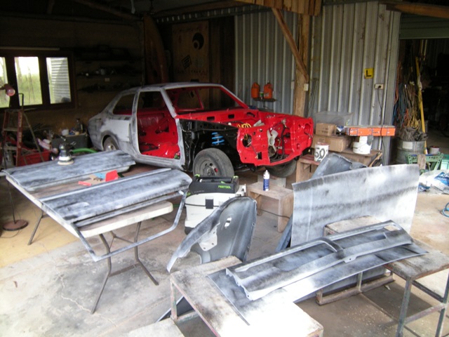

Okay so its been a while, thought ide put up some pics of rubbing back....this is a hit with 400 or the orbital (as advised by the pros) and next ill be in there with 600 going over the whole lot to get it super smooth.
Uni holidays start in about 5 weeks so I'm hoping to get it on the road then and sell the 55 as i can't afford 2 regos.
