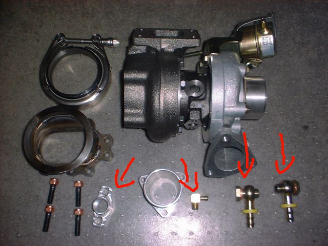

yeh it is an oil return
come to think of it, it probably wouldn't be all that hard to make one!!!
just make up a template with cardboard for the "bolt on" bit, get another fitting from enzed with a barbed end and a thread end, tap out the bolt on bit and screw in the fitting. :D
If its a Garrett turbo just get one off a slightly larger garrett turbo. I'm pretty sure the GT17 would use the same fittings as a T25/28 (they certainly look the same size). Grab the oil drain off a Silvia/180SX T25.
