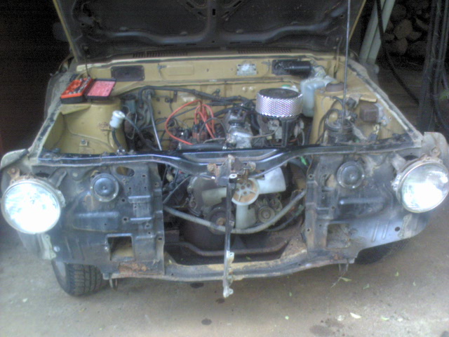

October 4, 200818 yr comment_278917 hey everyone, this is only my second topic ( you may remember dohc 4k) last august i saved a ke55 two door lift back from the wreckers with only its motor attached (no g'box, tailshaft or diff centre ) and seeing as dad knew the owner i bought it for scrap value-$100 i bought some mesh from super cheap and went crazy with it, cut my air cleaner box thingy and meshed the air cleaner and meshed the grill i also got some 5 spoke mags for $80 to replace the mix-match steel rims (you'll also see a racing seat in there, one of my ideas that didnt work) it took a while before i got a 5-speed box tailshaft and borg warner style diff then i got it running ive been using it as a part paddock-basher, part driving learning tool since then and it's soon to be pulled apart my plans are to:1. paint it (and get all the rust out) 2. take the engine apart 3. shave the head 4. put extractors on it 5. bore it out 40-thou i've bought the paint two days ago, it's a cool metalic blue nissan colour (probably from a n14/n15 pulsar) and it only cost me $610 (with thinners, hardener etc) which is cheap as chips seeing as it costs as much as a solid colour (thats the lid of the tin of paint in the sun) so all's well and this is something for me to do before i turn 16 :hmm: Report

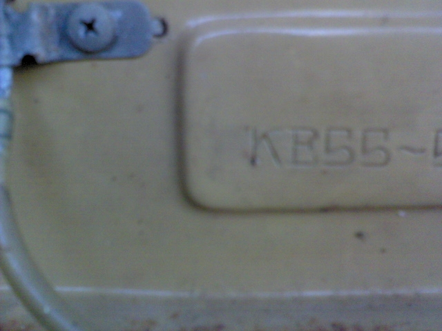

October 4, 200818 yr comment_278925 haha you a brave man admitting to being the creator of that thread!! :hmm: FYI - You have yourself a KE50, not a KE55. :y: Report
October 4, 200818 yr Author comment_278937 FYI - You have yourself a KE50, not a KE55. :hmm: well... chassis number says otherwise... Report
October 4, 200818 yr comment_278940 Weird.. Nice car man. Good colour blue as well Can't wait to see it done up. Report
October 4, 200818 yr comment_279016 Will look good in blue. I am also pretty sure thats a KE50, it sure looks like one. Did you get this off ebay ? It looks similar to one that was up on there a while back. Report
October 4, 200818 yr comment_279056 Okay, to settle this. KE50's were the KE30 equivalent. They came with a 3K and a black dash. The KE55-P was was the KE55 version. Came with a 4K and tan dash. And it was the only KE55 that wasn't built in oz. (only imported one) Report
October 4, 200818 yr comment_279058 So have you seen any other Liftbacks around?? Live even around at your local wreckers?? Very nice find there. Very rare machine you have. :y: Welcome to the Liftback club :hmm: Report

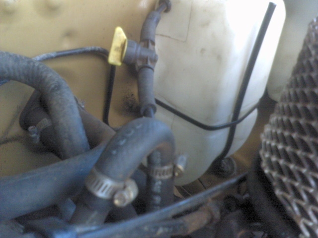

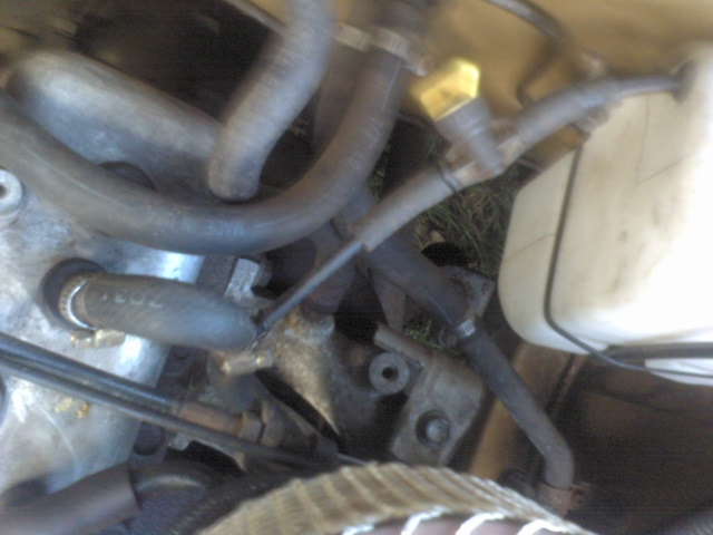

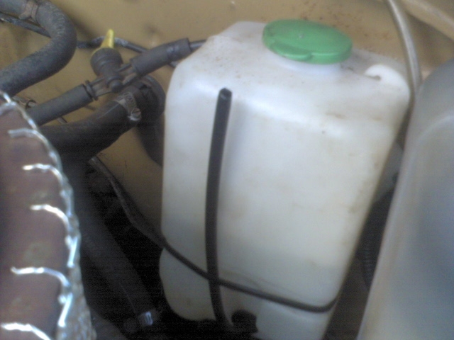

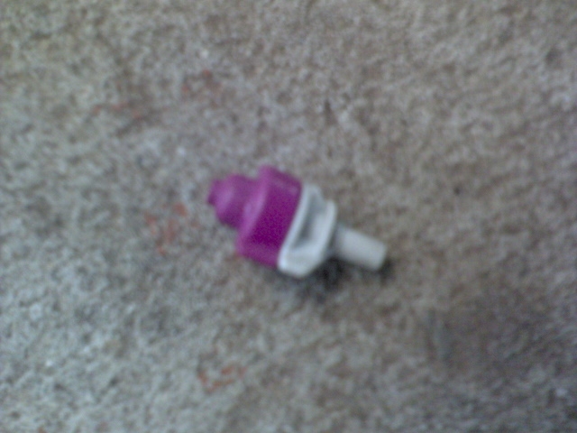

October 29, 200818 yr Author comment_285547 Update! sorry i didn't respond to these question's... i forgot so here goes: .i didn't get him off ebay-(from the wreckers if you read :D ) .i've seen one other liftback like mine, i saw it up in brissy, lovely orange colour, aparantly there's another liftback around ballina area more updates: i forgot to add to my list that i'm going to water inject it to stop detonating and at the moment i have a system relying on manifold vacuum, sucking air through the bottom of a washer bottle and it sucks the water droplets through the oil breather hose (it kinda works like a bong) that's the picture of the washer bottle with the air cleaner to the left that's a picture of the line with water vapour going into the oil breather hose that's a top veiw of the hoses with the vapour (and yes it is a bit hard to see) that system was based on this: www.greaseolineplus.com/page2.html my new system is one based loosly off these : http://autospeed.com/cms/A_110369/article.html and http://autospeed.com/cms/A_110368/article.html my dad is putting water injection in his wrx boat and he had some irrigation foggers left over that run at 50psi , i decided to try it with a windscreen washer motor which runs at 2-3psi, it worked... :) so i did some simple tests to work out how long my 1.5l washer bottle could take this flow i timed it with a stopwatch and a measuring jug and found it ran at 50ml per minute, that makes 200 minutes per litre which in turn is about 300 minutes (or 5 hours) for my bottle :P my other modification i am hoping to get is an efi setup-fingers crossed i'm looking to take him apart in another 3-4 weeks and painted over the chrissy holidays max p.s. if you noticed i was reffering to my car as him, yes he has a name, louie :argh: Report

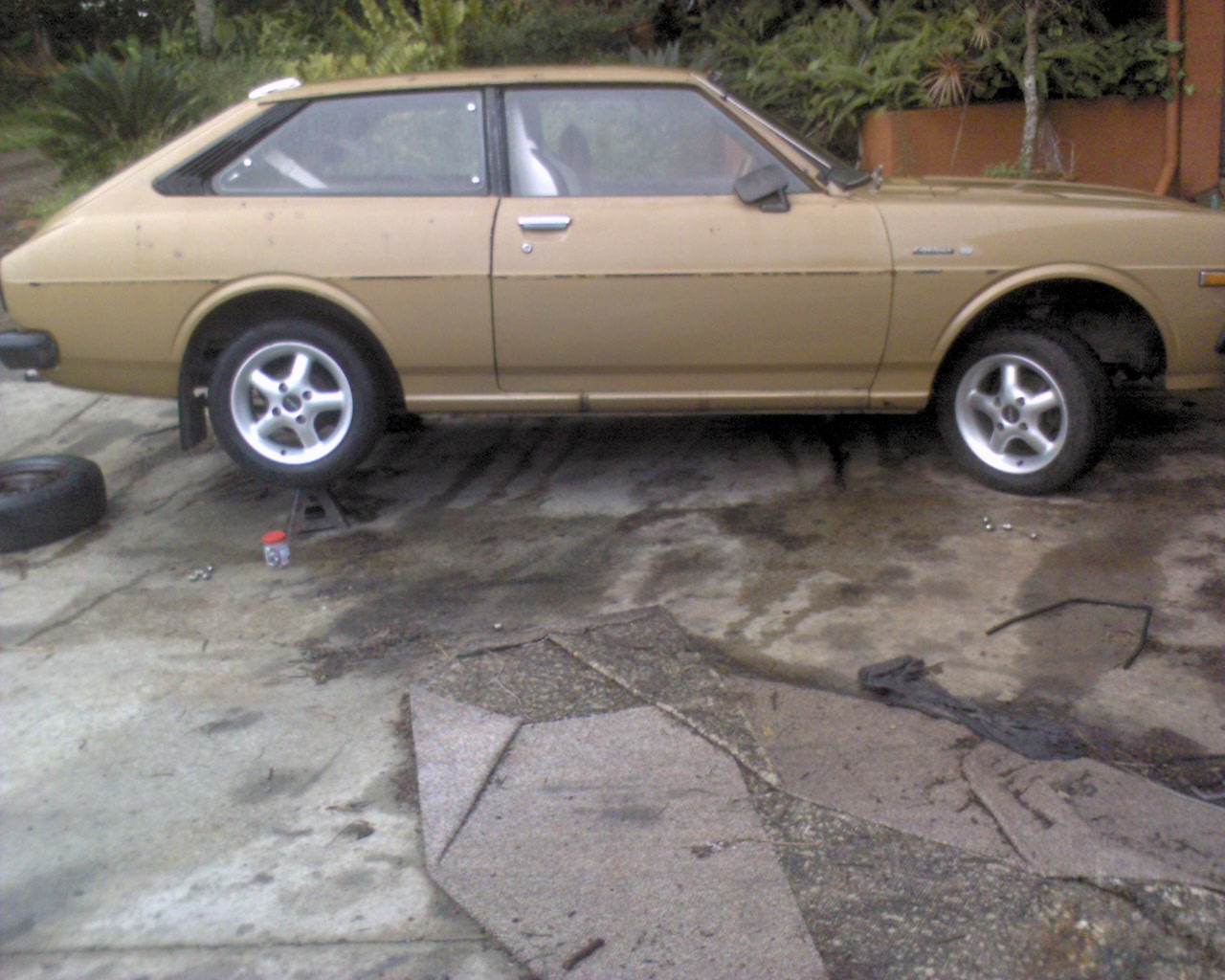

November 9, 200818 yr Author comment_288370 More updates took my car apart yesterday so i could get the panels into the panelbeaters :y: 873: DSC00290.JPG] dad's going to take them in on monday i've also designed a ram-air box out of aluminium to go behind the grill max Report

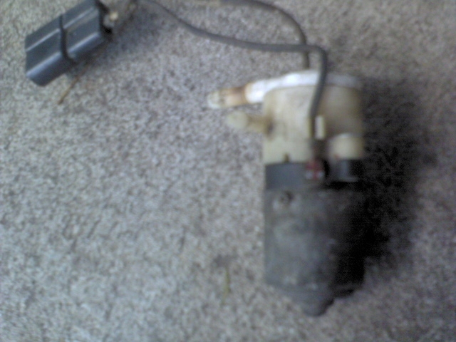

March 13, 200917 yr Author comment_327411 I decided to get off my arse and update this... i ended up getting the rebuild kit for less that $395 ($325 in fact) with 60 thou oversized pistons :no2: the mighty 4k is down at the rebuilders, getting bored out and i will take the head in to get shaved when i get back from my holiday. panelbeater/painter has taken my car away from me today aswell and hopefully should be done when i get back too I've also had some more innovations for my engine :y: I got 4k efi gear with a haltech programable computer, and tidied up the wiring harness, got a bigger throttle body (from a hyundai excell, lol) fine tuned my water injection system by running two windscreen washer pumps in-line to produce 45 psi and having that triggered by a vacuum switch on a relay designed a cold air intake with a commodore/liberty airbox I'm going to make an insulator spacer for my intake runners got thermo fans to replace the engine fan and i've also got a bigger radiator from a ae90/nova, which are cheap to buy new aluminium cored ones ($150!) and best of all, i got this copper one free max Edited March 13, 200917 yr by maxyboy55 Report
