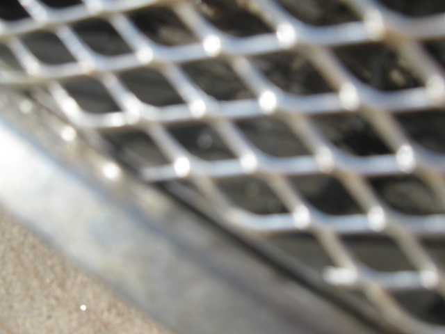

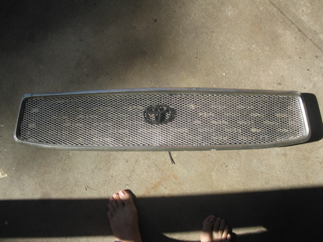

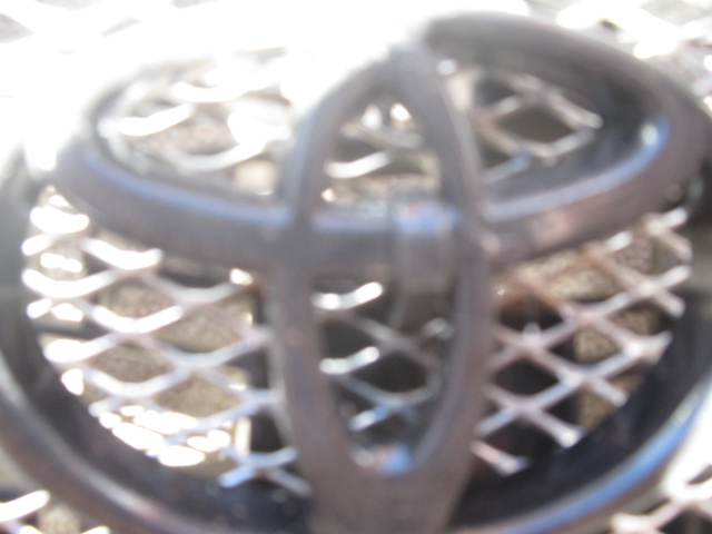

  18. i just bought the silver mesh that supercheap sells, $30 if i remember. that did my grill, filter, windscreen vents and i still have more left over max

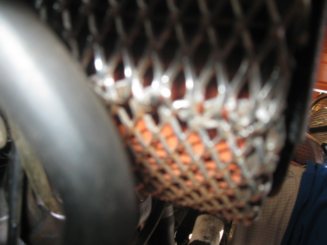

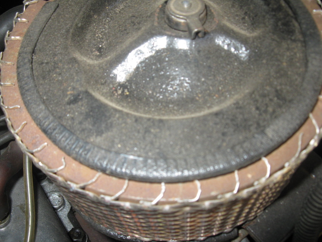

  19. i used a piece of butchers paper to get the rough shape so it would fit good and then cut it out of that shape it sits in the little gap between the chrome and larger part of the grill. I had to push it in there so that it clipped in and now it won't budge, i put a zip tie strategically placed in a modern toyota badge in the middle. and some photos of the filters bling :P max
  20. it's just some of that mesh you buy at supercheap, i used it for my grill aswell. all i did was cut the airbox apart to get the mesh on there, cut a piece to wrap around it and foled the cut tangs over the filter and joined it to itself by interweaving the tangs for an update: me and dad have been down to the panelbeaters and are starting to get the front half rust free, prepped and painted. hopefully (and i know i have said this a bit) it we be on the road by may. and i have some new (old) centrelines for it :P i will get some more piccys up in the following weeks. max
