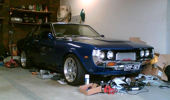

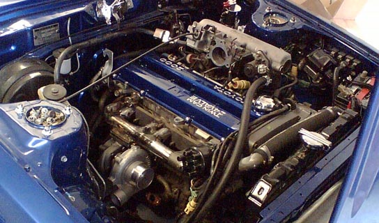

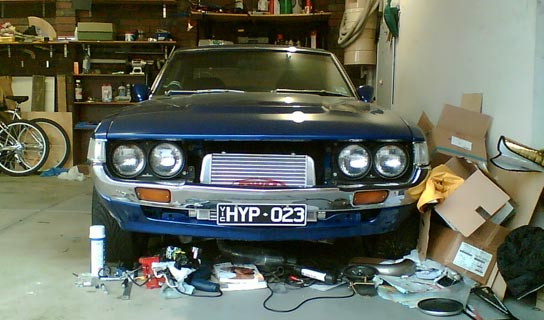

Off the top of my head, and adam will have to correct me plenty of times I'm sure, his Celica was an RA23, 1GGTE with a single GT2871R [or 76, can't f@$king remember], AU discs, VN rear end etc. Conversion-wise into an RA2X Celica you need the right version of 1GGTE - theres three apparently all with different sumps. Again adam will correct me but to go into a Celica i think it needed the sump with the bulge in the middle. Engine mount wise, as simple as cutting the mounts off the standard x-member and welding them 10mm lower, everything else apparently lines up [again, i can't confirm 100% - ive built plenty of Geminis but no early `yotas]. I don't think the standard CT12-twin turbo setup clears the steering box.
Sorry about the thread-jack with the pics, hotmail didnt like me today. I'm sure Adam can clarify any of the particulars. Worth noting the car was 100% Engineer approved.
Nick-
Oh man that thing is HOT
Looking at those pics I wonder why I ever sold that thing. :locked:
Nick is pretty much on the ball with the info he gave you, you can get the standard turbos to clear the steering box by having the motor sit on a angle towards the passenger side, you then get issues with it being close to the clutch master, as you can see I opted for a single turbo (GT2871R) because at the end of the day it was legal to do, solved a lot of clearance issues and the performance was like chalk and cheese, although there have been a few changes made to laws since so some engineer clarification would be needed.

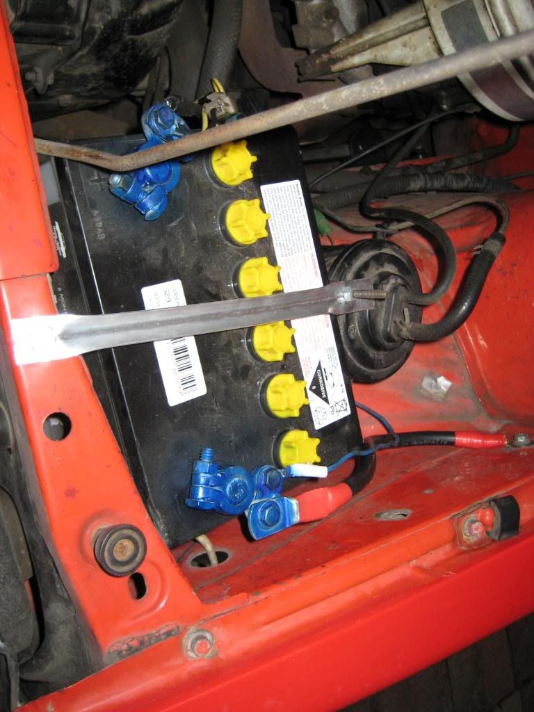

First thing I did in the past few weeks was to make myself a new battery brace out of a piece of right angled steel.

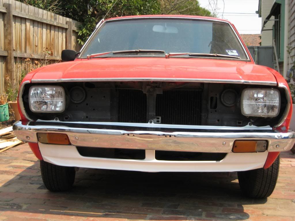

A couple of weeks ago now I went down to see Peter Robinson, to introduce myself and see if I could scrounge up a few parts. He was a big help. I bought myself a new drivers seat, bonnet latch support, overrated front bumper, wiper motor, front apron and a set of rear leaves.
The apron was yellow and a bit rusty so I gave it a coat of white kill rust before putting it on. Then fitted my new bumper and gave it a polish. Also put on the new bonnet latch support as my old one was bent. I think went to install my grille, but it wont line up properly. I think the headlight installation is to blame, the grille catches on them. So now I'll have to work out how to fix that.

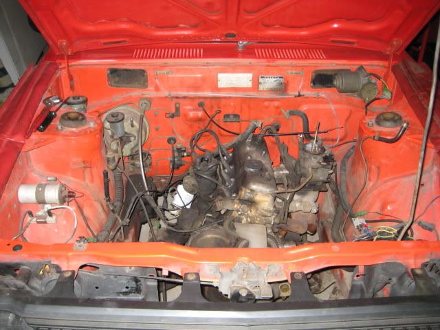

Well I finally got the car into the shed last night, and tonight went about stripping the engine bay and prepping the might 4k for removal. Feels good to be actually doing something with the car.
