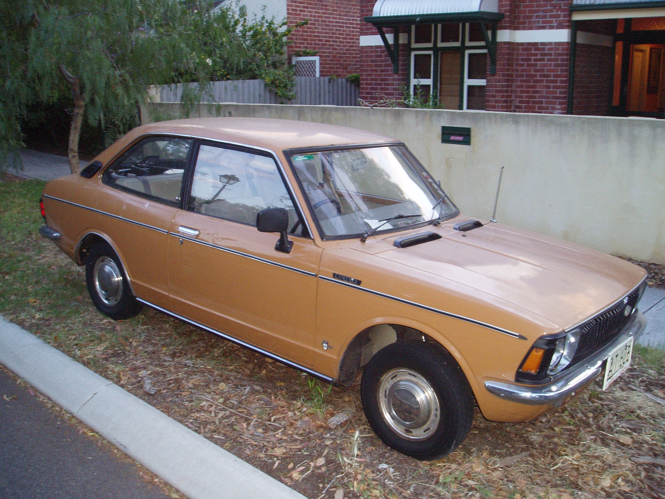

I'm in Perth, WA (Western Australia, I'm not sure how international this forum is). There's every possibility it's not at all what I said it was, I'm not much of petrol head - It's brown, has 2 doors and is an automatic.
As for a pic, this is the only one I have right now, but I'll try and take some photo's of the engine and interior then maybe someone can identify it properly.
nice work, that is a really nice example of an early ke20. not sure where the 9 came from...
maybe a typo on reg label or something?
love to see even more photos of this car when you've got a moment, maybe start a members ride thread?
