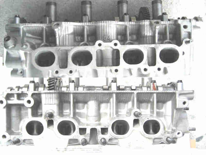

A bit of a tip for you guys I did the maths and looked at over 20 different piston designs to see whats ideal and I found the silvertop piston is the best match for its shape and dome size. The FE head has the exhuast valves protrude less out of the head so the exhuast side looks fine in terms of valve clearence even though the cutouts are 12 degrees out. So I was planning on just getting the twin valve pockets machined into the intake side, and yes it does look interesting to see 5 intake pockets in a piston. A week after I worked this out I discovered pictures from a guy in Thailand that did just this, if you like guys I can post all the pics I have found so far.

Top - Inlet, Bottom - Ex

beerhead: sounds interesting, its hard to tell but those ports don't look too bad a shape from the pics
