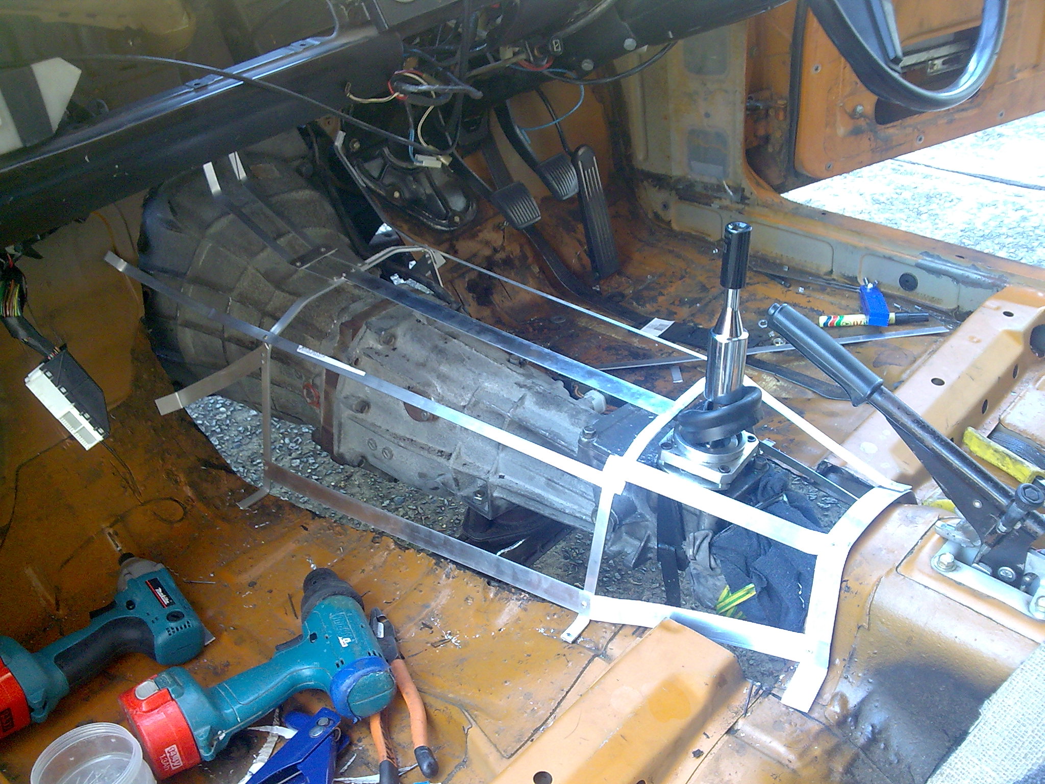

made a template for the gearbox tunnel and sent it off to a fabricator to make one up out of 1.5mm sheet metal.

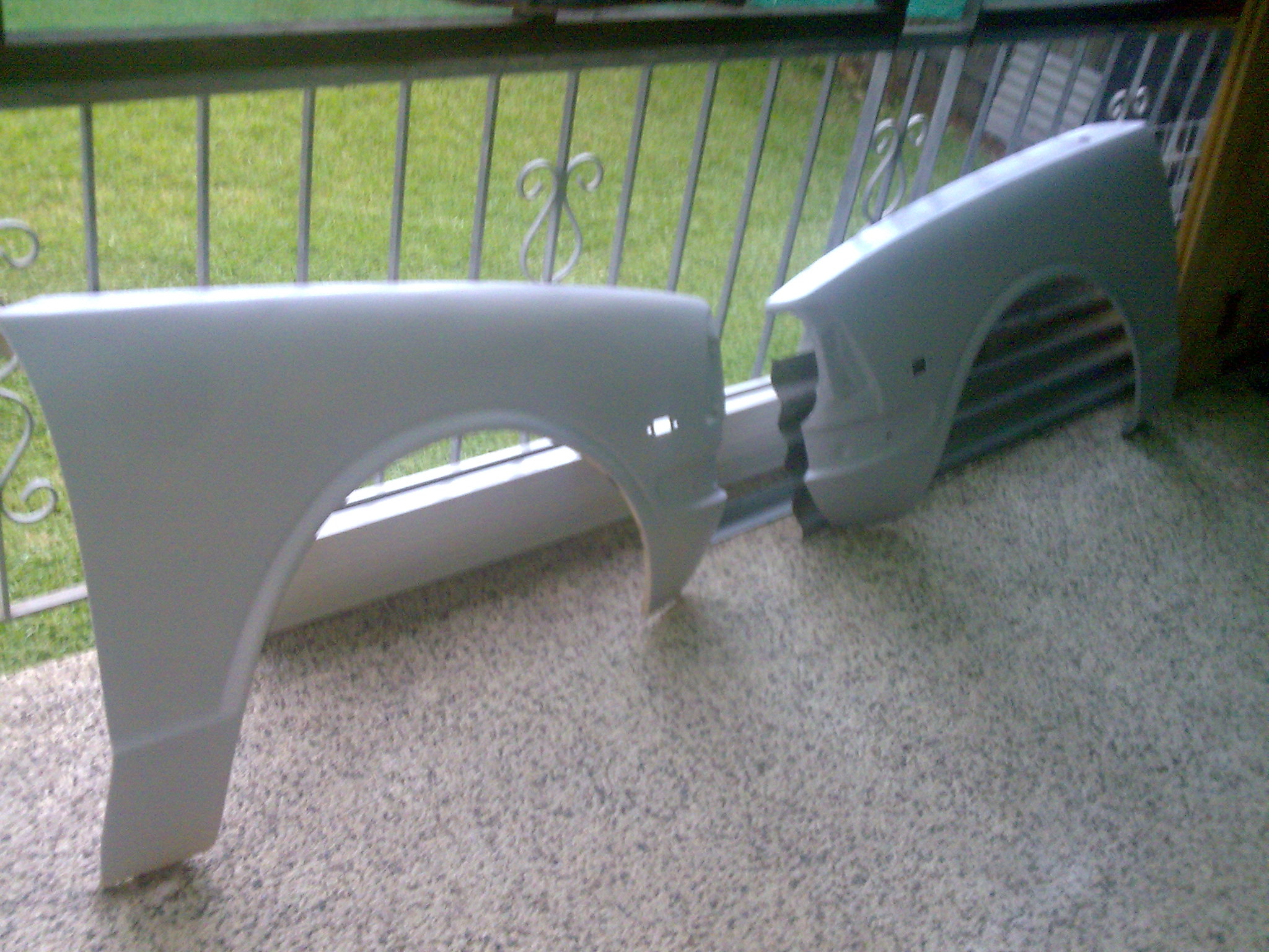

got the guards in high fill as well
hows the clearance with the handbrake.
tunnel is cool btw, nice work.

the handbrake will need to be located 50mm back
other then that it fits in nice.
