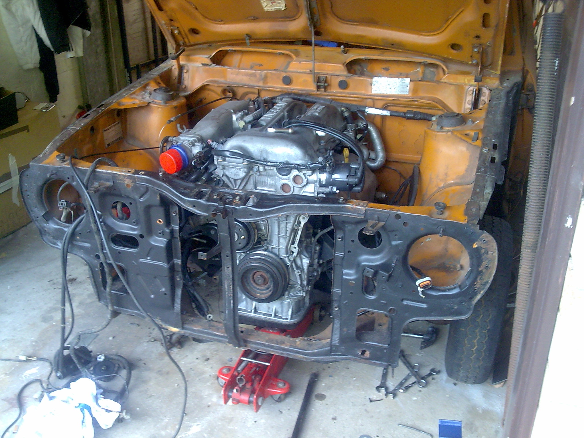

hahaha the car is just sitting there waiting for the diff and coil over conversion kit.

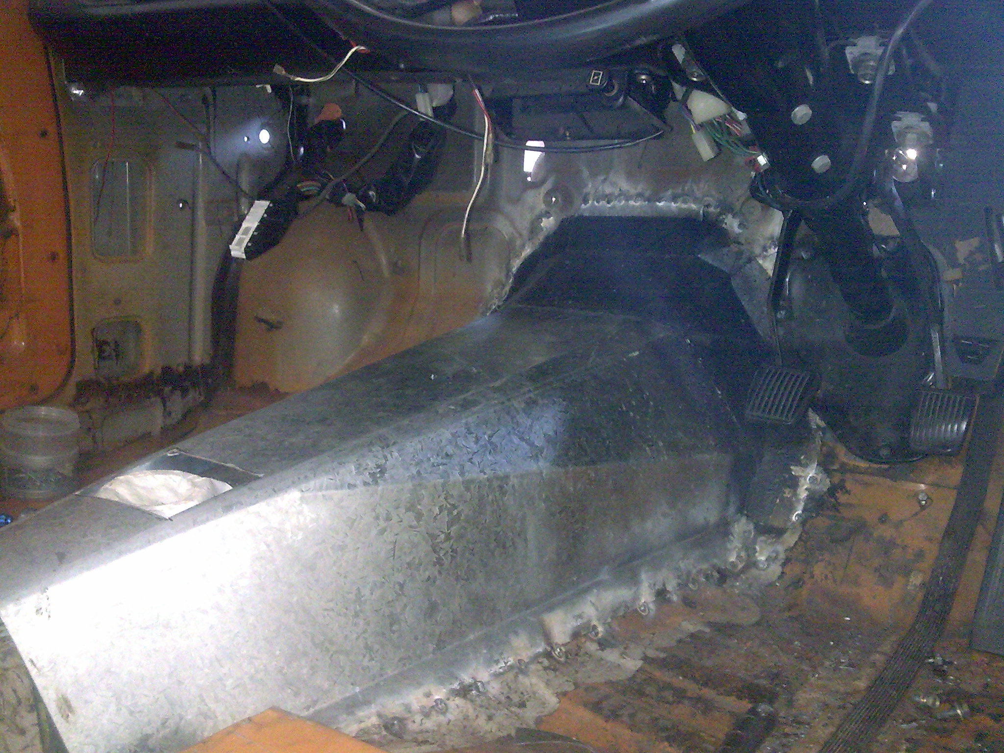

pictures of my gearbox tunnel Spot welded in
Ive made the tunnel like this so i can keep my standard heater.

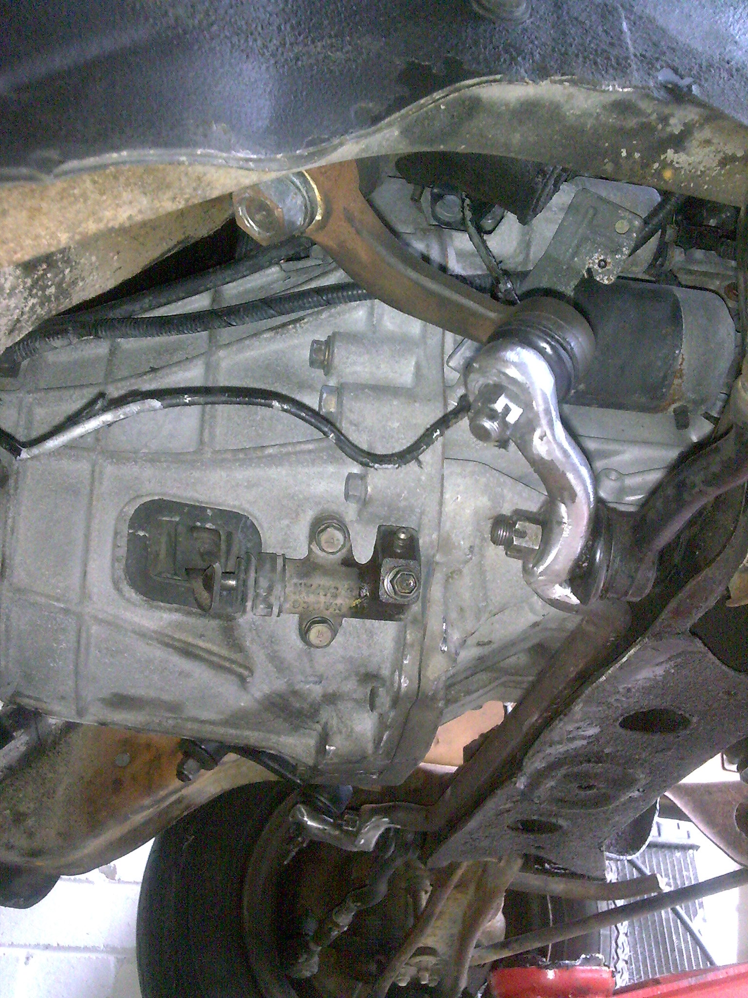

that drag link setup is interesting.
do you have any picks of it out of car?
what will u be doing for steering stops?
seeing as youll be running 17" rims, i would highly recommend using them.
