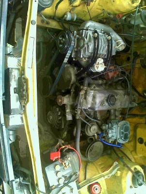

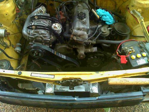

I would have thought boost pressure has nothing to do with the reliability of a supercharger. Isn't it the fact that to get the extra boost traditionally you're over revving the charger, and the teflon can't handle the centrifugal force and falls off?
In your application the larger volume of the supercharger, and the smaller the capacity of the engine, means you will develop higher boost levels than say a 1.6L GZE or a 1GGZE at a lower charger RPM.
I'd get that motor balanced with a big aftermarket pulley like that on the front too, bearings won't be happy about it at all.

i think the teflon coatings start to peel off when there over reved due to the heat caused by it
any ways heaps cool should go good, what sort of mounts are you using? is it a just off the shelf sort of thing? or are they a custom jobbie
