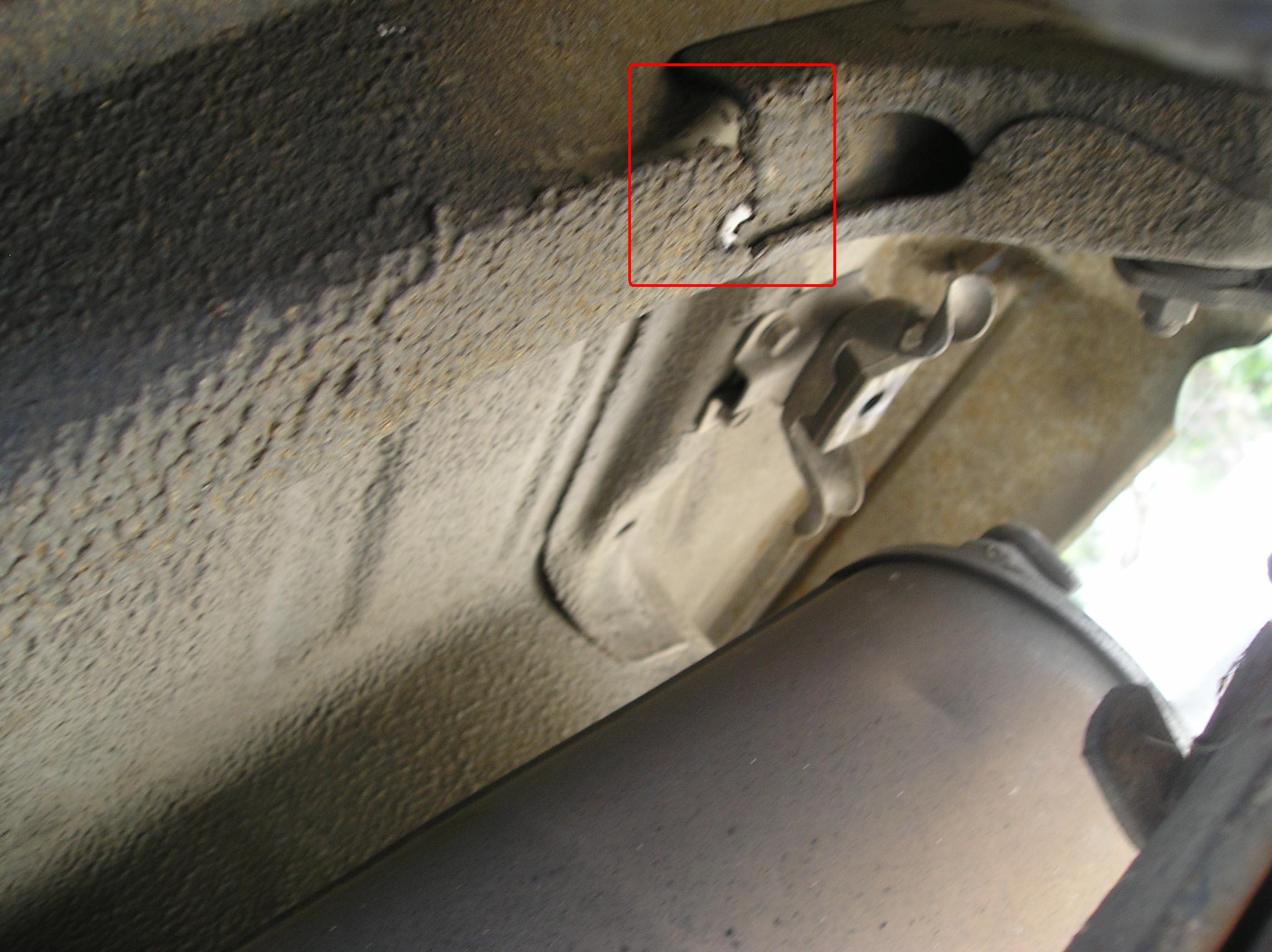

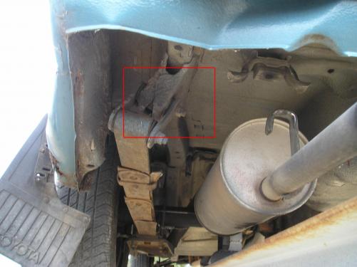

KE30_KE35_KE55 Posted January 24, 2009 Report Share Posted January 24, 2009 I wrecked this ke30 with rear chassis damage, Looking at the weak point of the chassis may help you decide how to improve your chassis. Quote Link to comment Share on other sites More sharing options...
philbey Posted January 24, 2009 Report Share Posted January 24, 2009 I'd be crossbracing up that leaf bracket first of all! and maybe a panhard rod style of setup. I really don't think you'll see any benefit from whacking in a couple of braces here and there, other than a strut brace. You're talking about a lot of effort for benefit you wont see on your self proclaimed daily driver. As for the foam, you're getting mixed up between chassis stiffening and collision protection - the foam is/would be used to absorb any collision energy, not to stiffen the chassis. Quote Link to comment Share on other sites More sharing options...
