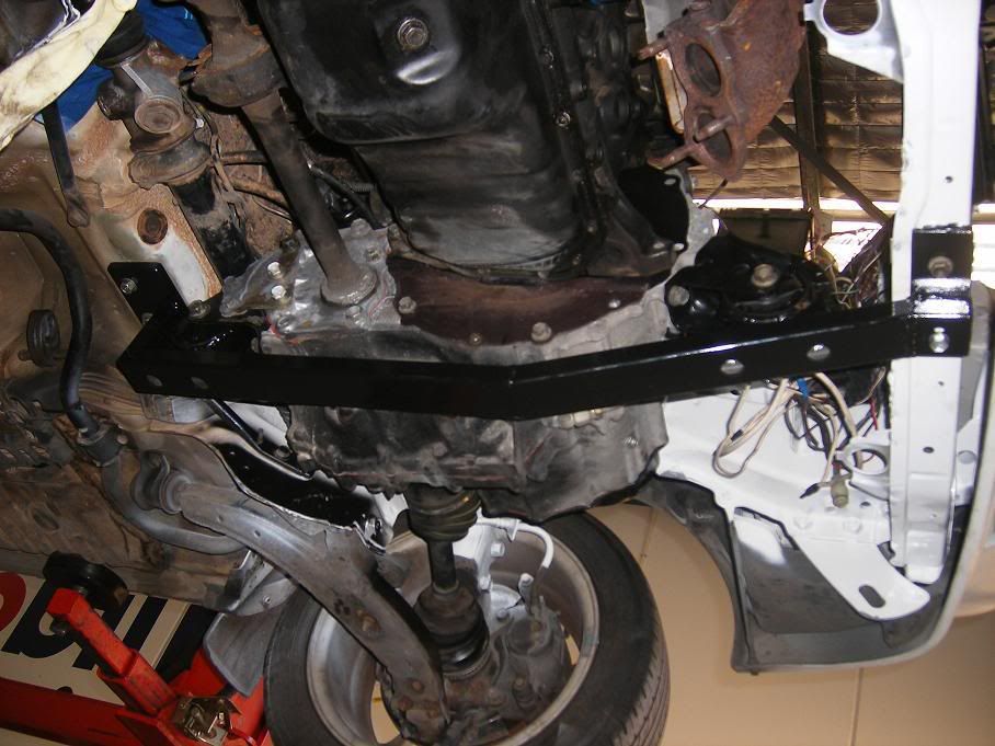

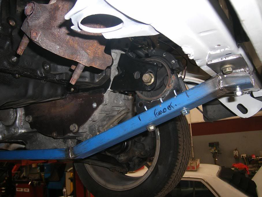

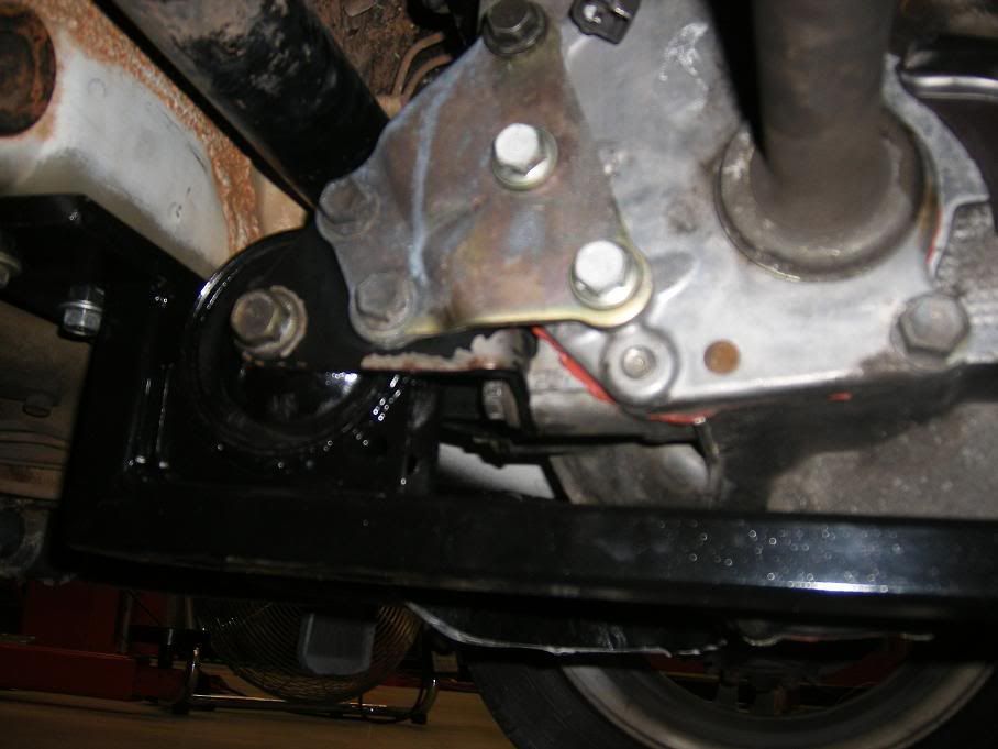

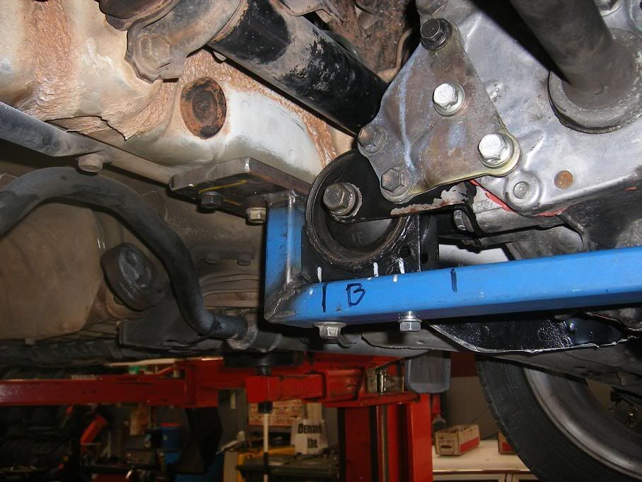

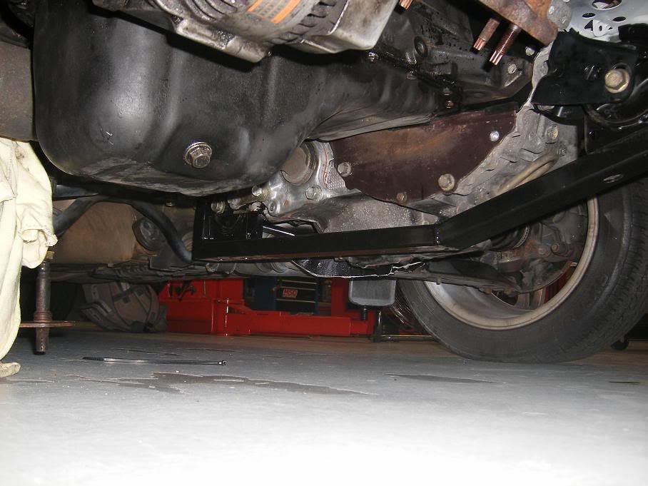

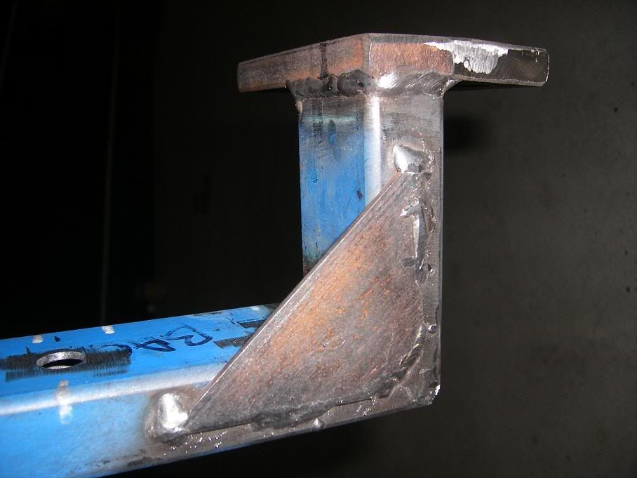

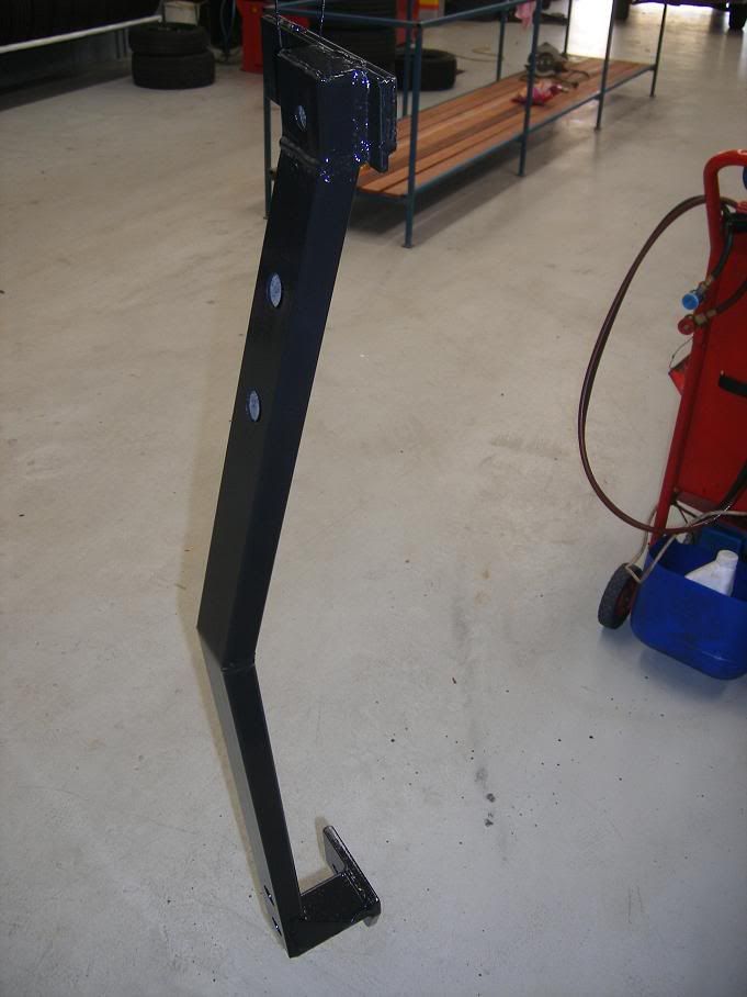

cuzzo Posted January 28, 2009 Report Posted January 28, 2009 Impresses with the crossmember. How did you work out exactly where the motor should sit? Quote

damo101 Posted January 29, 2009 Author Report Posted January 29, 2009 Impresses with the crossmember. How did you work out exactly where the motor should sit? i just put a bit of wood between the alternator bracket and the radiator support panel to hold it there, than checked that the sump was sitting level. Quote

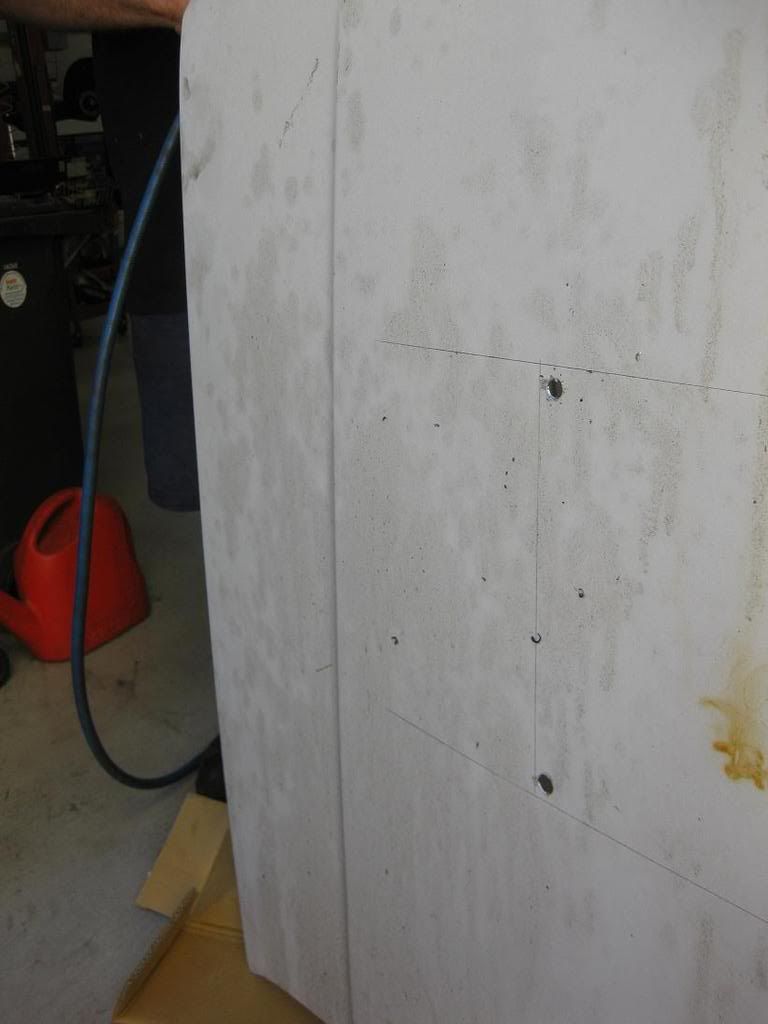

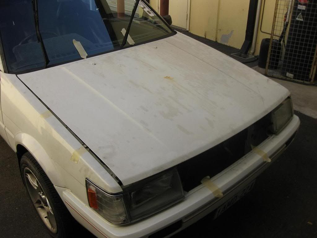

damo101 Posted February 9, 2009 Author Report Posted February 9, 2009 thanks to "chrisandliz" for the spare bonnet.. Quote

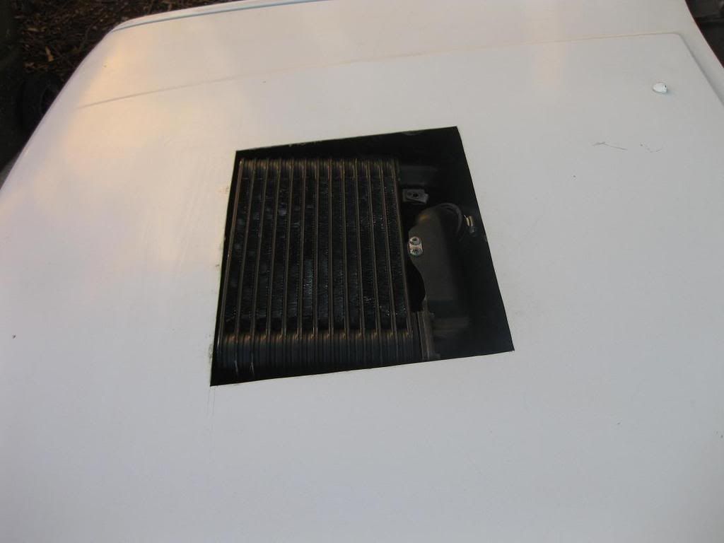

chrisandliz[RL] Posted February 10, 2009 Report Posted February 10, 2009 very very nice what scoop are you gonna use? Quote
quadeyquade Posted February 11, 2009 Report Posted February 11, 2009 i think he said ae101 scoop... also this car is awesome. seen it in real life and all. makes mine look shit :) Quote
damo101 Posted February 13, 2009 Author Report Posted February 13, 2009 yeah i will use the ae101 scoop.. so much fun to drive around.. Quote
