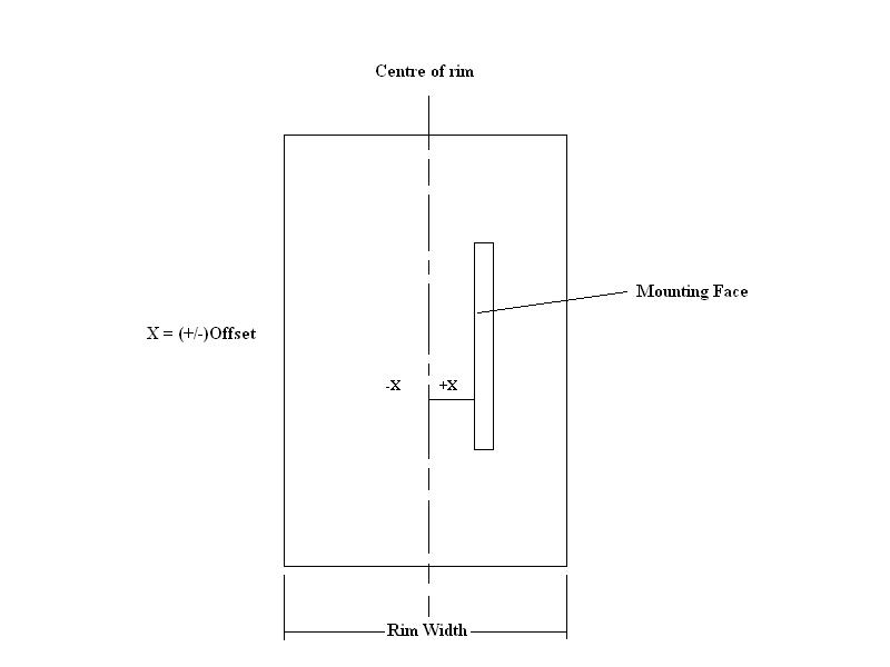

can any one on here tell me how i measure offset ?

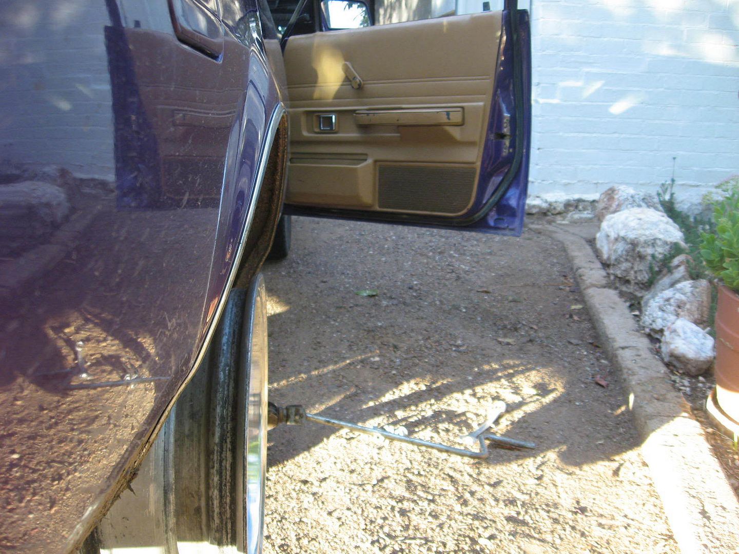

i restored the one in the pic tonight.. took me about 2 hours lol but come up real nice, had a heap of gutter rash and a small crack on the inside that i tig welded up.
can't wait to get some decent rubber on them

To find offset, measure entire width, lip to lip. Find the centre (divide the lip to lip measurement), measure how far the mounting of the face is from this centre, that is your offset.
I'll draw it out for you if that doesn't make any sense to you..
na your right matey thanks for that ay :lolcry:
there roughly 18cm wide...so what does that mean there offset is 9cm ? or am i doing it wrong?
ah i see a bit better now lol.. well they fit snug any ways.. there about half an inch from the gaurds
i just measured them then and i got about 2cm.. what does that mean?
