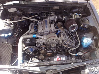

So ive been searching around, vn series 2 sounds like the way to go. Theres a ke70 on ebay at the moment with a series 1 or 2 auto in it. Also seeing as tho the commodore and falcon manual gearboxes are both "t5's" does anyone know if it's possible to get a falcon t5 and change the bell housing to a commodore one?? A mate has 2 or 3 manual EA to ED falcons at his place. Also found a v6 powered ke70 "track car" on youtube that seems to steer pretty good.
V6 ke70 video
