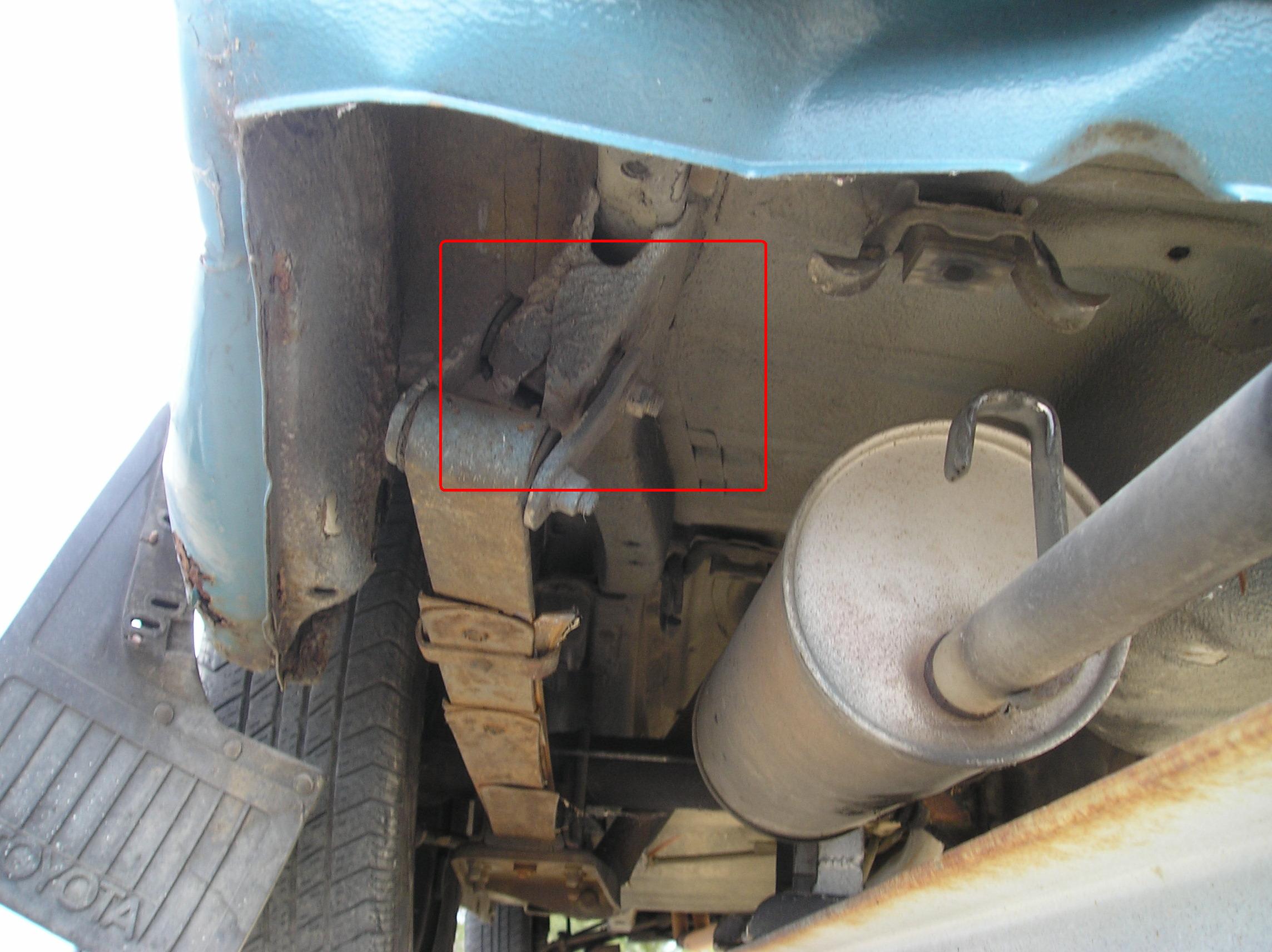

IT-depends how bad it is bent if it is like the one in my pic its stuffed, If it is just a little bit bent put it on a rack or similar and straighten it yourself endless chains work well. Have a go.
^^^^ ouch
And I doubt you would want to be attempting your own chassis repairs without decent skills mate :P
Ive done it once or twice with race cars, big chain, heavy set tree, and back/drive the car away in the direction needed.
Then get the porta-power in there (or simply a bottle jack if you need to) and press and bang till you get it straight enough.
I wouldnt exactly trust that sort of repair in a road car though.
