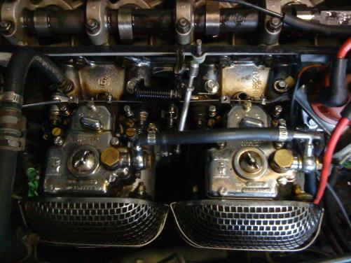

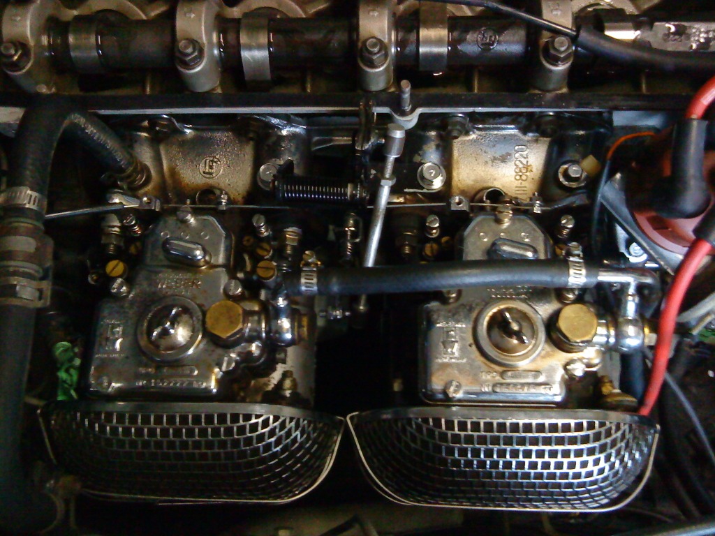

hey mate, seems to be coming along nicely, could you please get some closer pics of your accelerator linkage?? and did you buy those spark plug leads new or were they already on it??

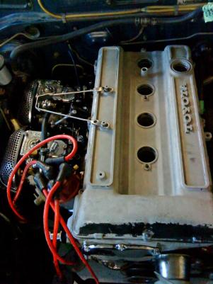

Wiring done... or so my mate thinks. Has to check some diagrams to be sure.

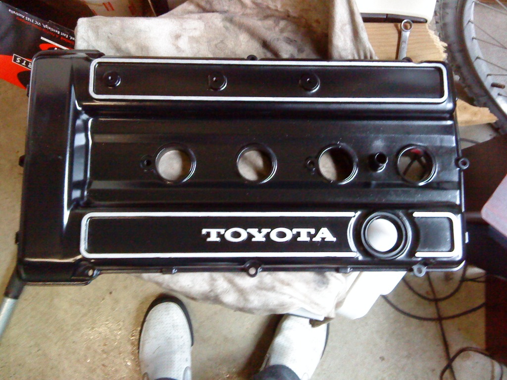

Rocker cover all painted and on

For toyota_ae71 - Hope that picture helps and the leads were already there.

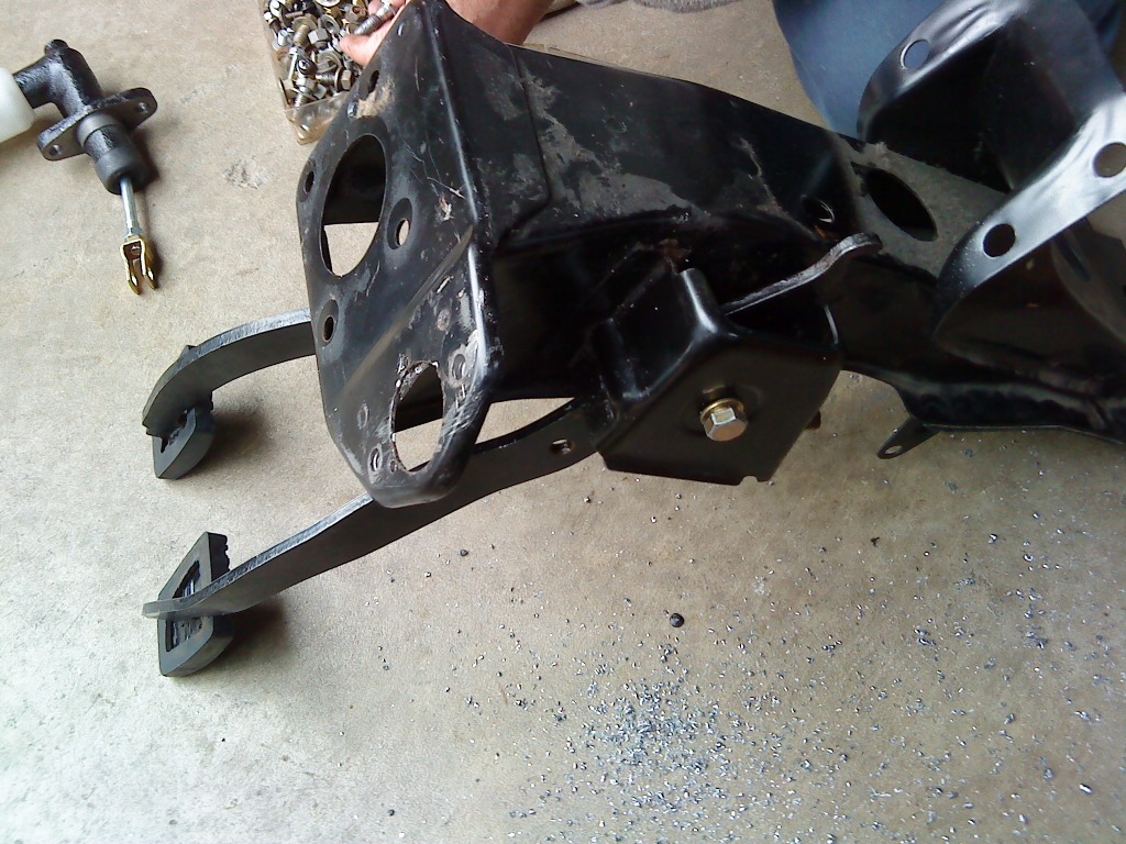

Big thanks to kangaroosa for his hydraulic clutch post, made my life a lot easier. The most annoying part of the whole exercise is getting the pedal box out and then back in. I think that they never intended for you to remove it. Have the pedal box in place and just have to tighten up all those bolts they have put in to nifty little places that require you to have hands the size of a small child but with the strength of a gorilla.
Next job is to mount and wire in an electric fuel pump. After that provided there are no unforseen f ups i should be done.
Picture of pedal box out just to show that i had victory over the bloody thing
You've just given me an idea. Before i do a pedal box swap, i think it might be an idea to set the box up for an hydraulic clutch before it goes into the car and just have the hole plugged while i'm getting around with a cable clutch
