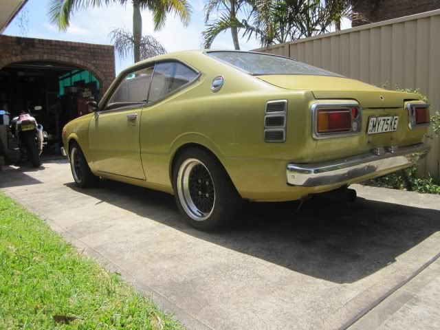

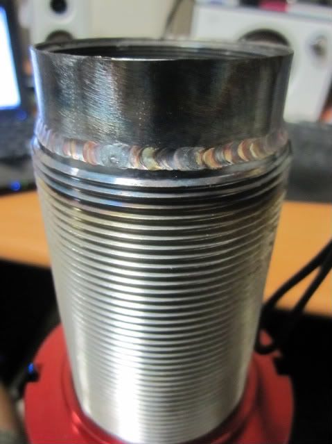

Small update, had some time to work on the car.
Had a friend cut and shut my struts by 40mm and weld the HSD coilover sleeves onto my ae86 struts.
Went with 5kg springs and KYB MR2 Rear shocks.
Also have xt130 control arms in, should really get off my ass and sell the sigmas. Had to do a at home wheel alignment was shocked how much toe there was after changing the arm.
Wheels are back on as i had clearance issues with stock rims, RCAs and LCA combo. I decided to swap the rims around as the offset works better without any guard flaring.
Took the car for an extended drive, pretty funny watching people trying to look for a done up car when you give it a little boot.
(holy shit photobucket is slow for me today)
Now I'm running a little positive camber.. maybe time for some NRCAs or a set of strut tops
Time to wire up my lights and indicators.. going to be fun.
nice ride height, i didn't know you were rebuilding an old landcruiser ;) lulz jk looks good mate!
nice work mate, our rides are almost identical haha, but is a ke30 two door
can i ask where you got your strut brace from
