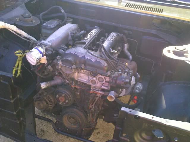

getting ready to get the engine out, swap the crossmember and suspension.

Engine in its final resting place

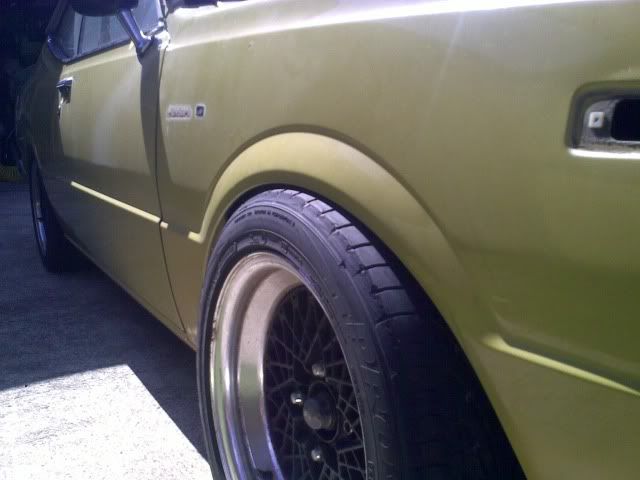

Got all the suspension swapped over and everything stripped out of the old shell ready for the tow truck to scrap it.
Have to run the stock wheels till i mod the new guards

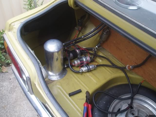

Put the battery box in, need to get a bit of rod and flatbar to hold the battery inplace
and i put the fuel setup in just need to trim the wiring and get some more fuel hose.
