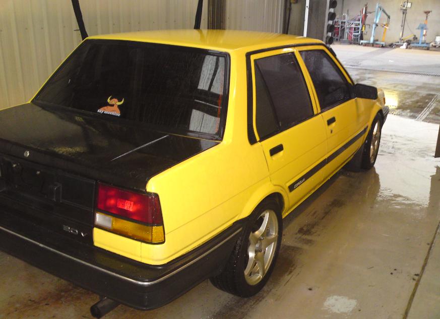

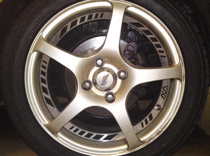

hey all just bought this on ebay last night for 1125 bucks! fully mod plated 4AGE 20V silvertop 112fwhp... sard fuel reg 2.5 inch exhaust pod, surge tank bosch main pump and carby lift pump... ssl king springs and bronze racing rims...
only needs front and rear engine mounts and rego and ive got a wicked daily while the ca18 ae71 is off the road doin bodywork, diff, suspension, paint, brakes etc etc list goes on... enjoy!

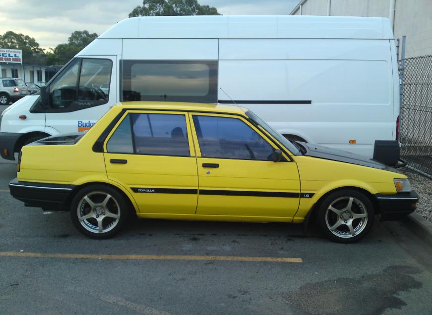

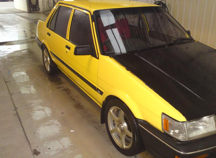

Looks like your running twincam front struts which means that the front hubs, bolts, brakes, driveshafts and steering have also been changed. Looks good mate? Got any plans for it apart from been a daily?
Mountings all look factory. Did the sedans ever come out in twincam format?
Yes, Not here though.
Ahh ok. Just looking at the towers, don't look like they'd been redrilled to suit the twinky strut tops.
But then again, i havent seen the 3 bolt pattern that the Sinkys use.
My twin-cam has a 3 bolt strut tower. The all do from what i've seen.
Could be Camry or Celica front struts....
All AE82's have 4 holes punched, SOHC use 3 bolt struts and DOHC use 4 bolt.
Ahhh i see!
Thanks for clearing that up Trev
wow can't believe this has been brought back to the top, suspension is all stocko apart from springs, onnly plans i have are new shocks and get it running better, made 101hp atw with 10:1 afr's, running very rich
