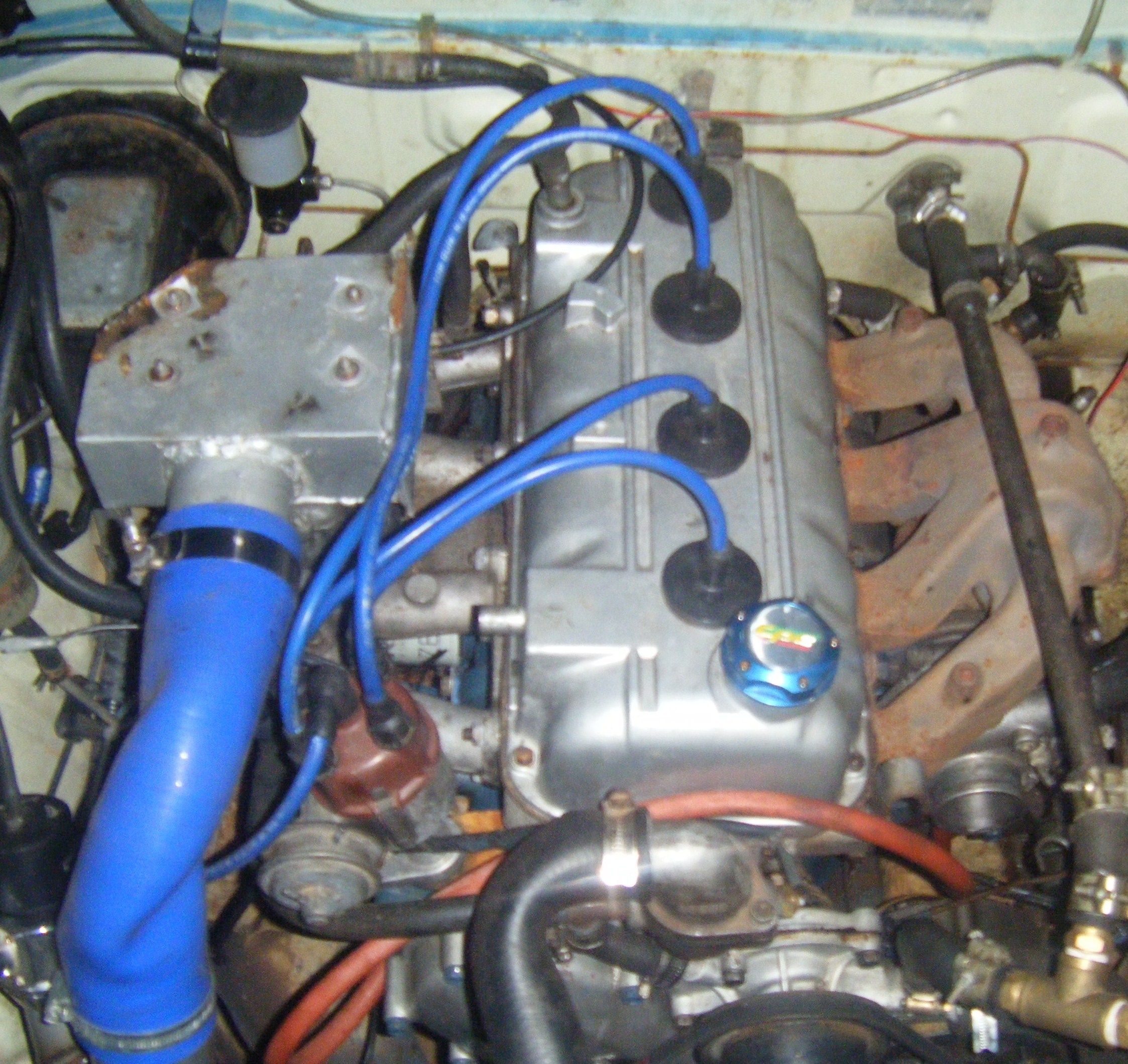

Here it is all in and ready to go, (I hope lol)
Doesn't look very tidy yet but i will tidy it up soon
I just wanna drive it :) haha
