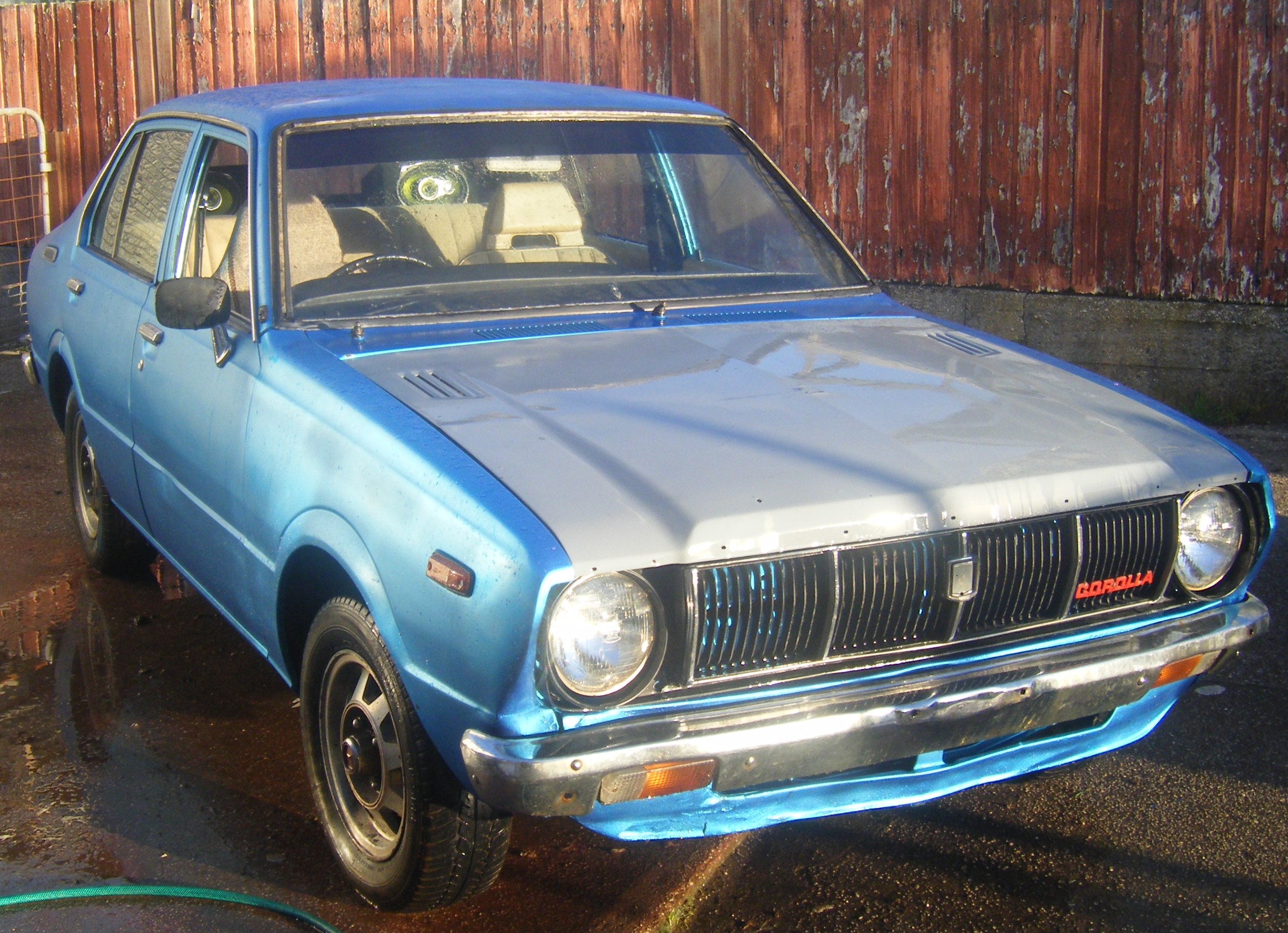

So the day i bought it (The cream one)
Not so long ago..

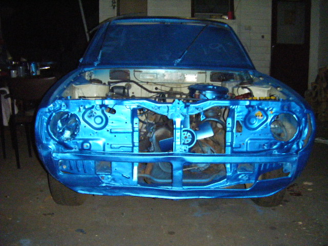

And what it looks like at the moment. (colour looked good in can but its a bit bright on such an old car i think :bash:)
I tested the lights and bumpers out to see how they look against the custom metallic blue

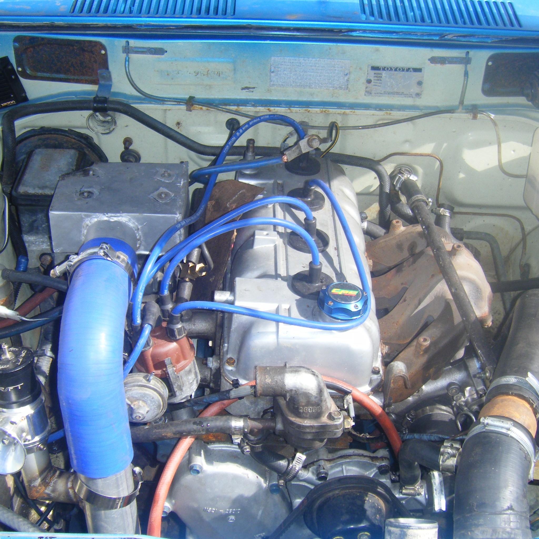

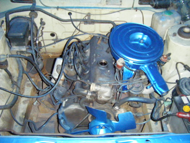

I put the exhaust and tailshaft on today. Yesterday i finally got the gearbox & crossmember in.
Also cable tied heaps of the wires in my engine bay. looks alot better.

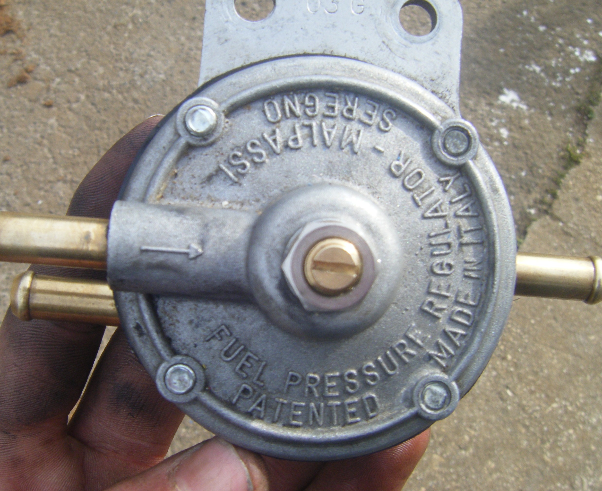

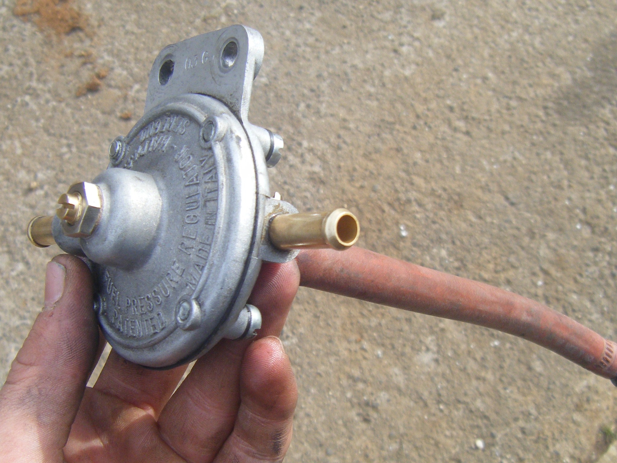

It is a external fuel pump, its also alot louder than i expected too lol.i've set it up now and it does its job well. yea casey gave me the malpassi rising fuel rate too, but i can't figure it out. i'll put a pic up and can someone please label what pipe plugs into where? sorry but i've never mucked around with anything like this before. cheers :lolcry:

got to love the mallpssi regs there so strong for there age
Do you have the fuel pump mounted on some sort of rubber mount?
If its hard mounted to the car it will be noisey as hell.
As reg, looking at the first pic:
right hand side is fuel in (from pumps)
left hand side LOWER goes to the carby
left hand side UPPER is the (post butterfly) vacuum/boost refernce
and the one out the bottom is the return line, which goes back into the surge or fuel tank.
:lolcry: you've even got some of my old Ortach (fuel line).

Yeah it has the rubber thing in between the pump and bracket but i havent actually mounted it to the car yet.
Whoa thanks so much TAZ. Now the regulator makes sense. I'll have to try it out first thing in the morning.
