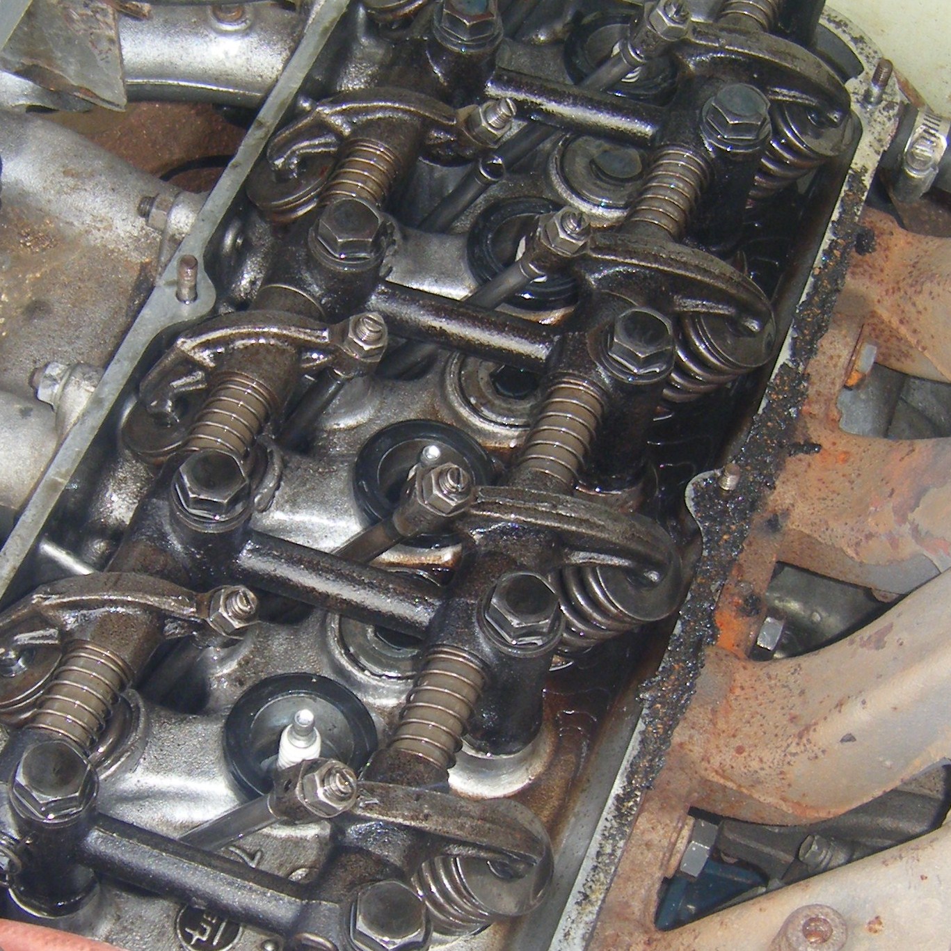

Today i started the rolla and there was an extra noise coming from the rocker cover.
This is what it was
The pushrod had fallen out of the rocker, she's all fixed now though.
Click on the pic to enlarge and you'll see it better.
Also the rocker cover gasket was ripped and torn, also leaking. So i'll buy one soon.
Did you pull the pushrod out to check it didn't get bent?
Yeah i made sure of that before i put it back in.
