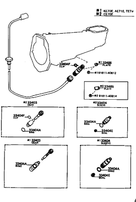

My mate did a 4A-GE conversion in his KE70 and he used a T-50 but he's got my old K50 speedo cable on it and it's out according to his GPS. It may sound really odd but there may be a difference between cables???
  • Replies 33
  • Views 12.1k
Its more likely got the wrong cog in the gearbox, for a different final drive ratio. There is a small cog in the box (on the speedo drive I think) that sets the relative number of turns for a different final drive ratio. This is most likely your problem. You have to order the right cog from Toyota or try to find a compatible one from another box. Luckily I have a 4.3 diff and jdm t50 from an ae86 so my speedo is spot on.
Was his car a manual or auto ke70 to begin with? From memory, the auto had a 4.3:1 final drive, and I think manuals had 4.1. AE71 Manuals are 3.9 so unless you have a 3.9 diff installed your speedo will be out (assuming you used an ae71 t50).
