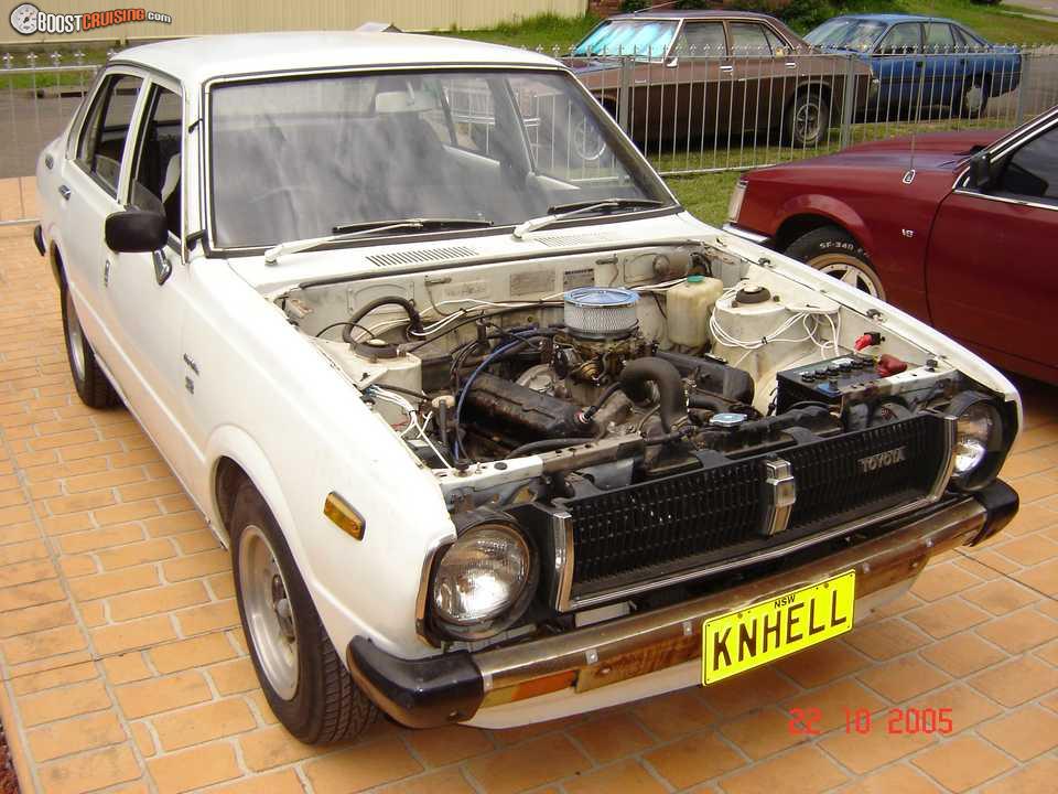

Madtoy: what car have you got a 308 in? KE30 or KE70? what did you have to do to get it in there? just engine mounts, gearbox mounts and custom tailshaft? firewall mods at all? i read in another thread you said it could be done for around a grand.
Cheers, calvin :faq:
calvin.......ive got 308 into ke30,just modify front x-member,no firewall mods needed...I'm thinking of making a kit to sell........and yes $1000 will get u going...the power skids are amazing.....just an update,ive recently run 12.79secs with 185/60/14s,huge amounts of wheelspin...I'm currently fitting 15x7 weld racing wheels with 235/60/15 ET radials....all under standard wheel tubs!!! ive also discovered a very cheap way to make cal-tracs(like tramp rods) which bolt straight to underside of leaf springs,and mount to front of hanger using a fabricated bracket!!!! These arms prevent diff twisting and stop axle tramp,using pintarra parts...thats all I'm saying for now! but i think alot of rear wheel drive yota boys will be happy with my solution...keep you all posted.............madtoy
sounds wicked mad toy. how far forward does the 308 sit madtoy?
also those times, is the engine stock???
powerskids sound fun :ninja:
........it sits half inch off firewall and i run twin thermos...no room for a flex fan....radiator mounts under front rad support...everything sits behind grill and bumper for a factory look...my engine runs solid cam,vn style efi heads and 750 carby....
