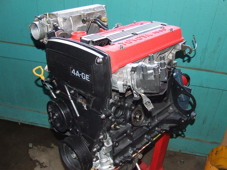

got the old 4k and k40 out, turned out the welsh plugs where all stuffed, ohwell :P
got the new tailshaft and t50 in, worked out i have an AE86 gearbox x member and took me a bit to get my head around,
just waitning on my Exeady cushion button in 212mm to come in and my 20v flywheel to be machined, got some arp flywheel bolts too

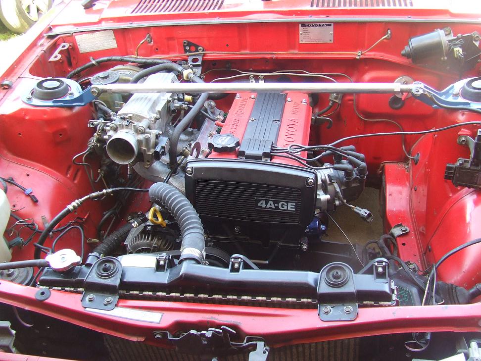

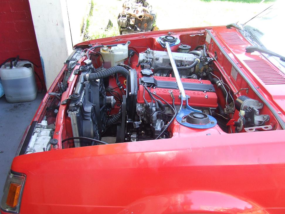

4age in, all fresh parts from my hookups ^^^^^^^^
just about to drop it back down on the ground,
gotta do wiring, fuel sys, coilovers and exhaust now, getting there, pics tomorrow

it cost me $1200 for a engine, no clutch, no leads, come with a rwd loom, box, near bare parts car for engine x member, ecu, radiator pipes, coil and ignighter, and thats about it, cheap yeah, but i have spent over $2500 just in little parts, every thing adds up.
its a 100kw smallport btw
