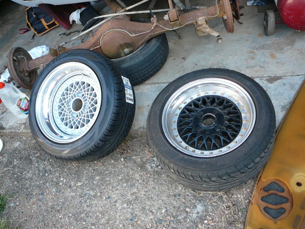

mungi mods Posted June 3, 2010 Report Share Posted June 3, 2010 (edited) 2 x new 6061 heat treated outers , welded , polished , valved and tyred :P now awaiting fitment :abuse: other pair are getting welded now coming to a 20v ae71 soon :D should fit under 100% *e7* stock guards with 205/50/15's.................. Edited June 3, 2010 by mungi mods Link to comment Share on other sites More sharing options...
NIZLAH Posted June 3, 2010 Report Share Posted June 3, 2010 jealousy is an evil thing...... better weld those rims to your hubs Matt otherwise I may snake em lol...... Link to comment Share on other sites More sharing options...
LittleRedSpirit Posted June 3, 2010 Author Report Share Posted June 3, 2010 2 x new 6061 heat treated outers , welded , polished , valved and tyred :P now awaiting fitment :abuse: other pair are getting welded now coming to a 20v ae71 soon :D should fit under 100% *e7* stock guards with 205/50/15's.................. Schwing! Link to comment Share on other sites More sharing options...

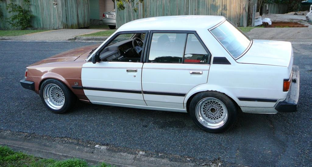

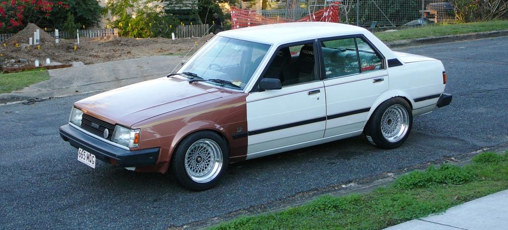

LittleRedSpirit Posted June 5, 2010 Author Report Share Posted June 5, 2010 (edited) Ta dah! Edited June 5, 2010 by LittleRedSpirit Link to comment Share on other sites More sharing options...
mungi mods Posted June 5, 2010 Report Share Posted June 5, 2010 A LITTLE ROLL and she'll be SWEET !!! Link to comment Share on other sites More sharing options...

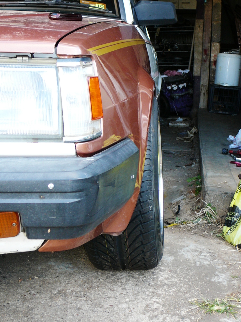

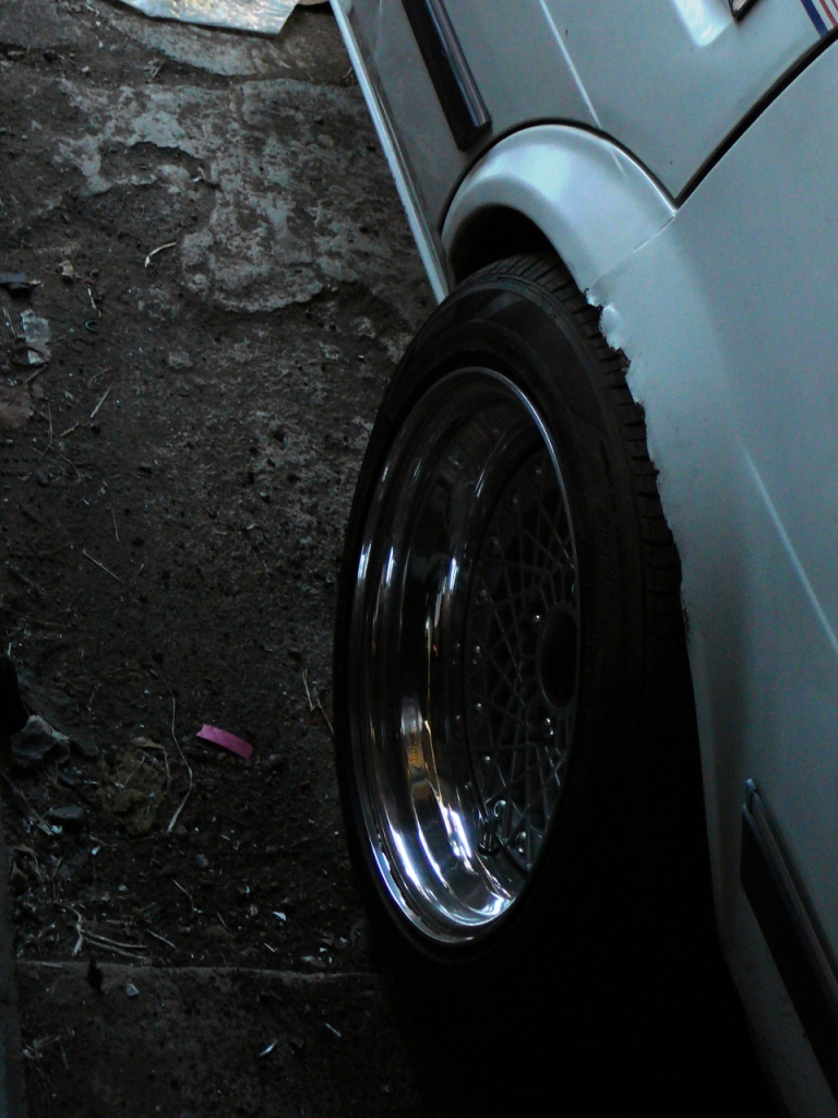

LittleRedSpirit Posted June 5, 2010 Author Report Share Posted June 5, 2010 A LITTLE ROLL and she'll be SWEET !!! The front didn't scrub once I bent the corner out a bit. The rear barely scrubbed. Needs some metal welded in to fill it up in the rear gaurd lips, but it wont take much work to cover. Also i did my sums, the wheels are 15x8 front and rear and the G3 centre pair are -8 offset, they were on the front. The G2 pair are -6 offset and are on the rear. I should point out that the car has xt130 lcas in it that widen the front track 10mm a side. You could fit 15x8 -20 without them dead easy. Link to comment Share on other sites More sharing options...
