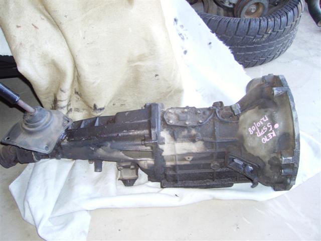

November 11, 200917 yr Author comment_390345 Thanks for the info on the oil leak guys, how do i contact toyota? just get in touch with a dealer or something? pardon my ignorance!! oh and i picked this up today from rick at toyoland for 275 bucks!! Report
November 11, 200917 yr comment_390350 Every Toyota dealership will have a genuine parts department somewhere in the building. Go down for a visit or just give them a call. :S Report
