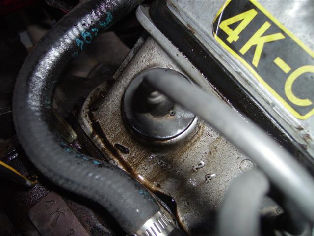

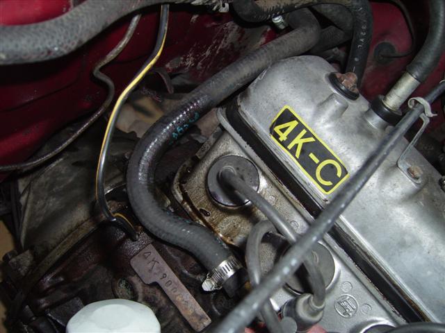

OK so i washed my engine the other day to try and track down my oil leaks and this is what i found a few days later...
how do i fix this?
