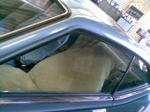

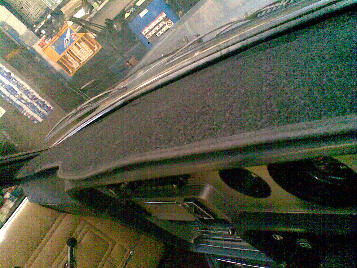

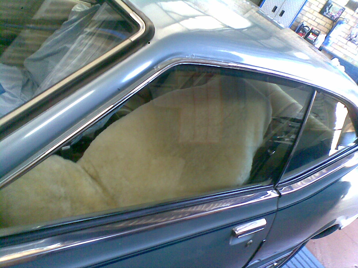

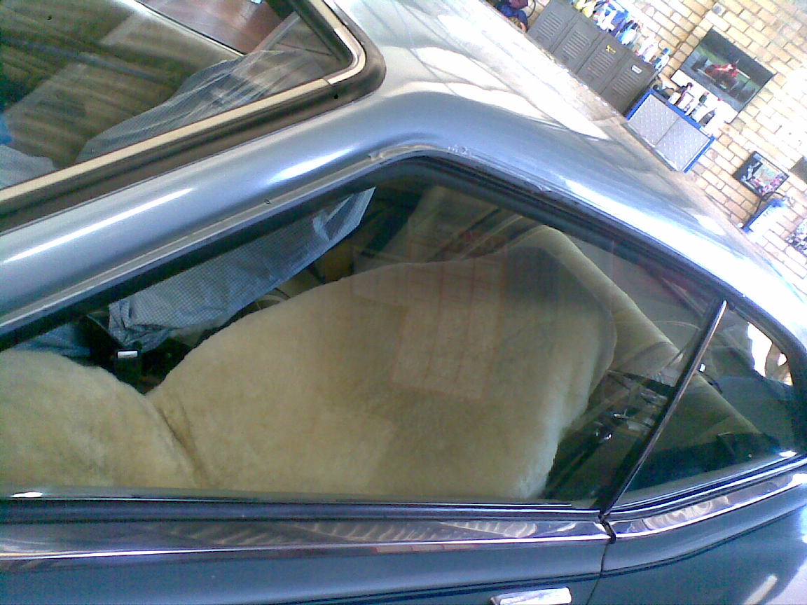

Hey Josh. Another small update for you! Got some chrome guard moulding today and fitted around the window gutters. Also fitted a dashmat today as well. Here are some quick pics.
Also next thing to do is redo the chrome locking strips in the front and rear windscreens.
Before
After
Dashmat
That the clip on gutter strip or you just buy the stick on type?
I would also like to know that, if its something you can readily buy then i may be interested in trying some. if its not the actual trim, does it seem like it would come off easily? ie while driving
Thanks
At the last Classic Jap show in Bris I spoke to an old man with the stick on type. They seem really good and he's never had problems. Plus they don't have the rusty clips. I'd say also good cause you can clean behind them better.
Yes guys that is the stick on type of chrome moulding. I got it from Supercheap and it's about $20 for five meters and it was enough to do both sides of my coupe with a little left over. It's not too hard to apply and seems to be stuck on pretty damn well and is easy to clean behind.

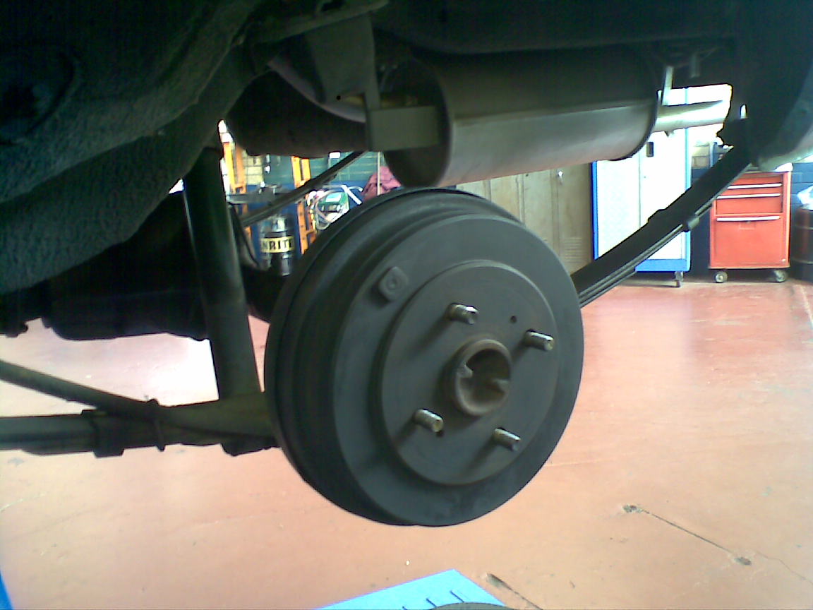

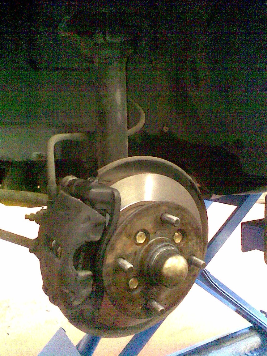

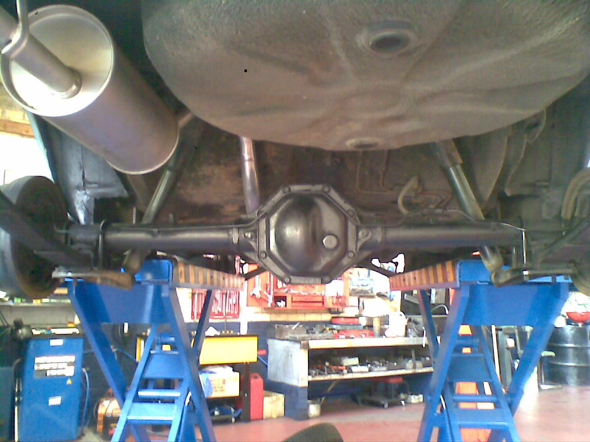

Also made some more progress today. Took the discs off so that they could be machined and obviously re-packed the bearings while i was at it and also got new bearing seals. Got some new Bendix pads for the front as some fuddy duddy fitted DB1086's instead of DB1088's. Also gave the calipers and and caliper brackets a quick coat of satin black. Today i also cleaned up the rear shoes and drums and readjusted the handbrake. Also painted the drums satin black.

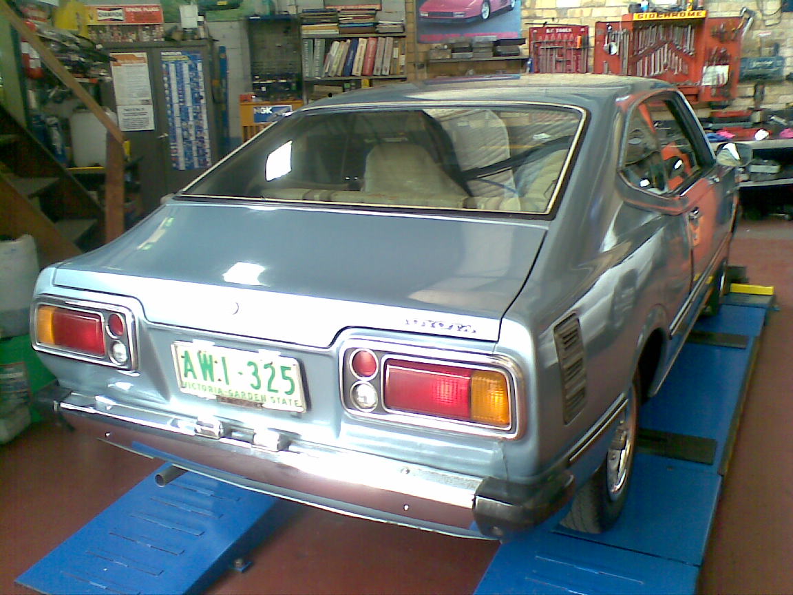

BIGGEST NEWS YET - i got the RWC today and i am heading off to Vicroads tomorrow morning to get her registered! :locked:
Here are some pics...
You must be wrapped with the way things went. Congratulations. :n:
Josh :cool:
I'm absolutely wrapped Josh. Not even one thing was brought into question for the roadworthy inspection. I'll have to meet up with you and your old man's rides and we can take some photos one day!
