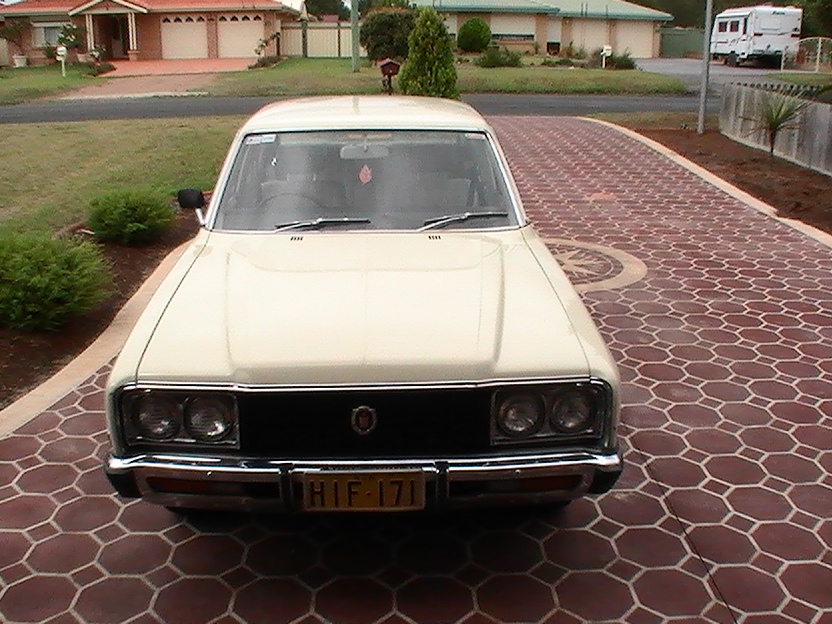

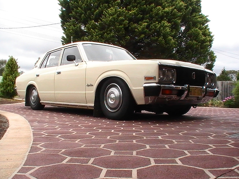

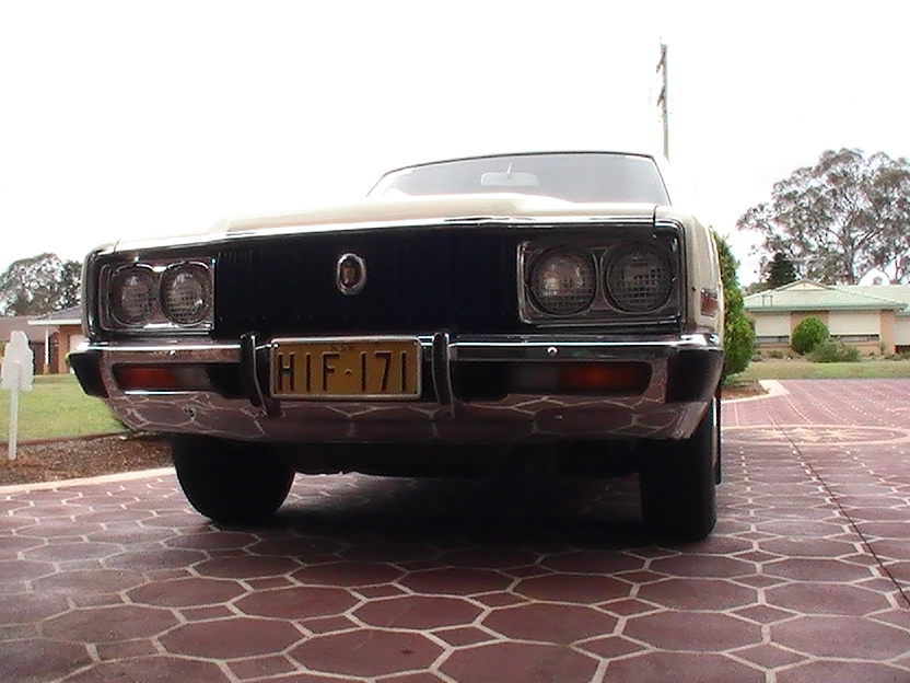

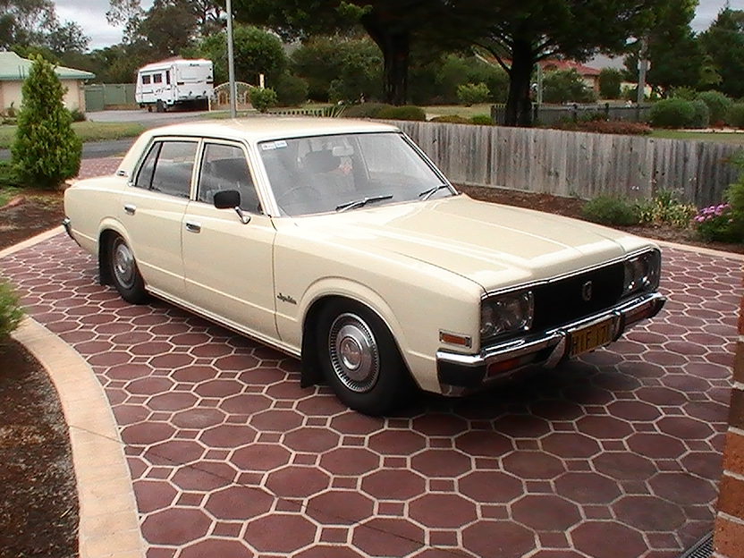

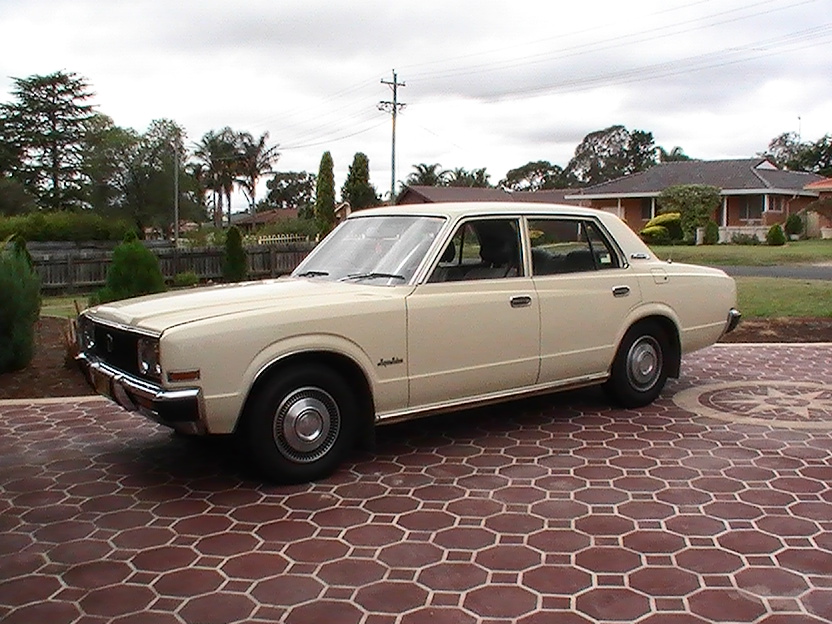

Here is the car guilty of slowing the progress on my conversion to my KE55. But I must say it has been a well worthwhile experience. It is the first time I have ever done a job such as this. It was a tiring one as I had only nights after my job to work on it.
Anyway, it is an 1975 MS85 Crown Super Saloon. It's got all the jizz and jazz you could ask for back in the mid 70's.

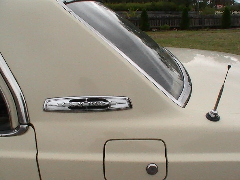

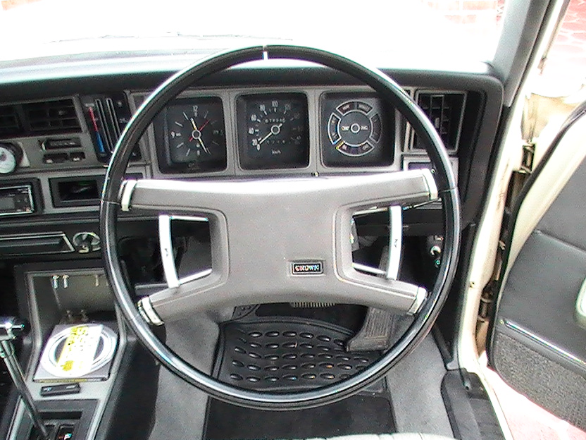

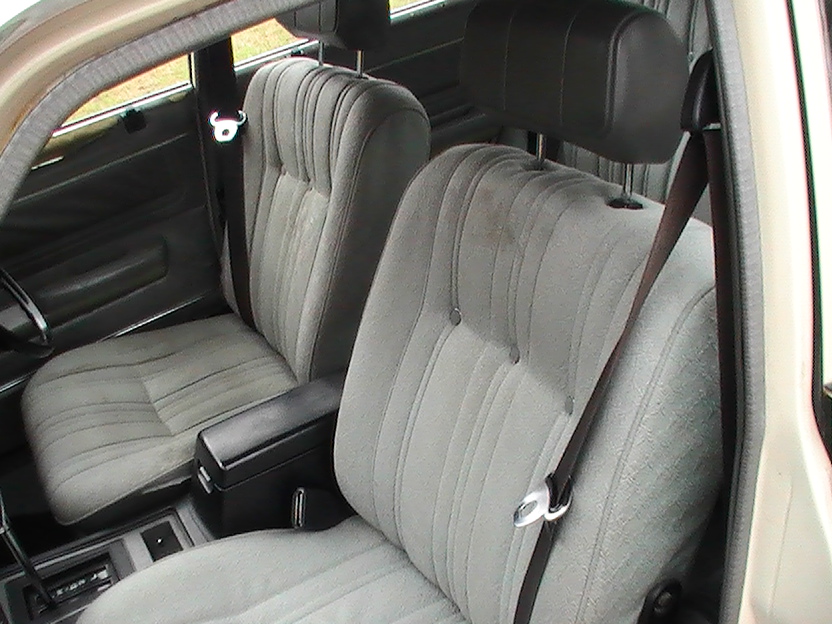

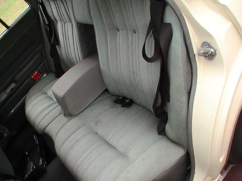

Power windows all round, central locking, power steering(as most crowns have), fully functional and quite impressively cold air conditioning, boot popper, automatic locking once you reach over 45km/h, automatic rear demister, rear passenger radio controls, antenna's for the radio are integrated in both the front and rear windscreens, engine bay light and plenty of stainless steel trims. ;) :y: :thumbsup:

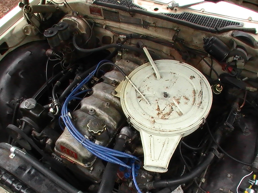

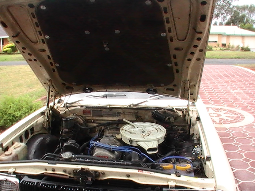

It is powered by an awesome 4M, which has been untouched and is proving very reliable as most old Toyota's do anyway.
There are a couple of other things that I have done to it which don't come standard but I will post them up later.
Anyway let the pictures do the talking. Hope you guys like it. :y:

Dude thats hot as. Hey you wouldn't be able to get pics of the integrated aerial and the engine bay light would you? I'm trying to get ideas of how I'm going to do stuff to my hardtop.
thanks :thumbsup:

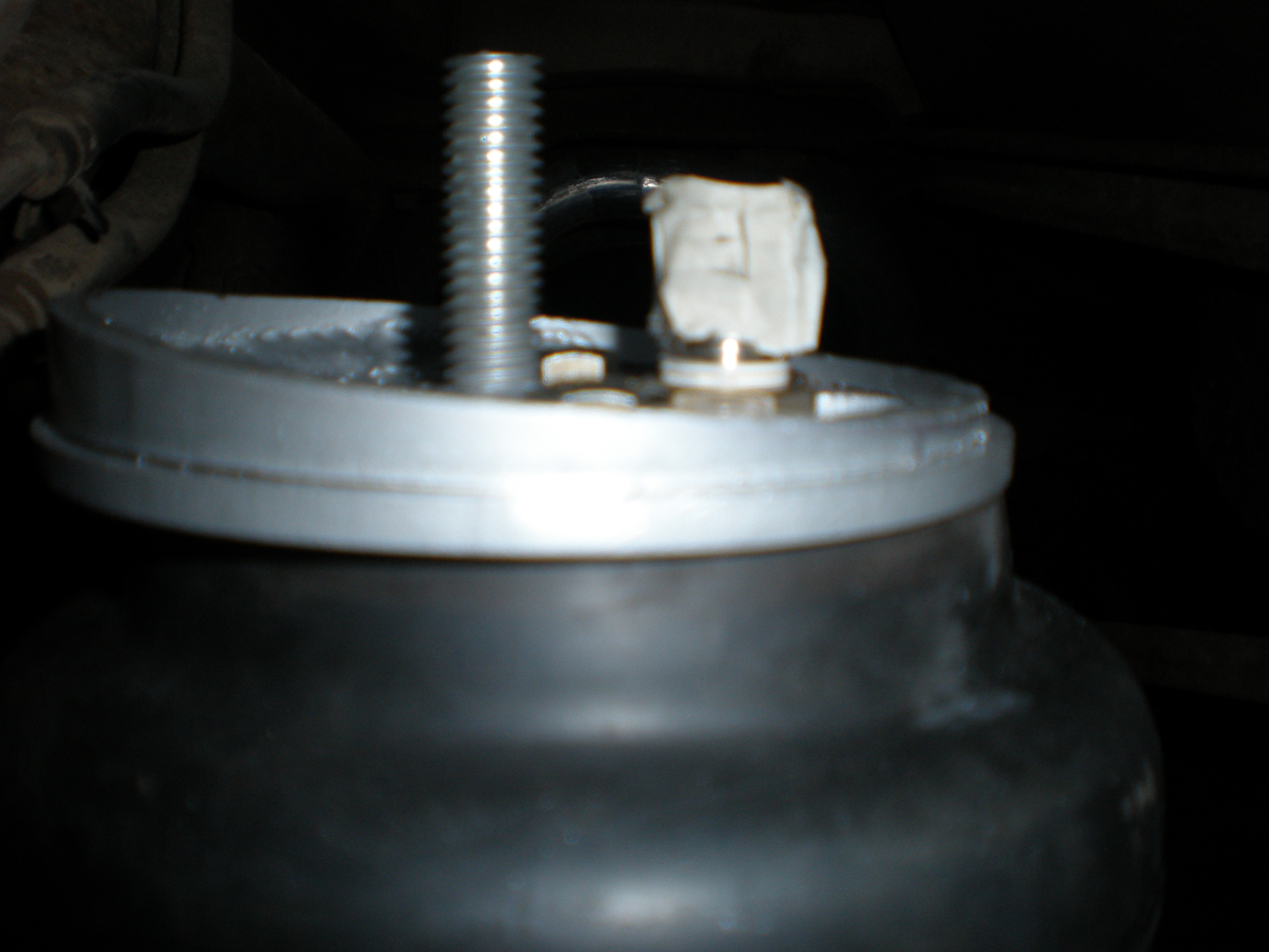

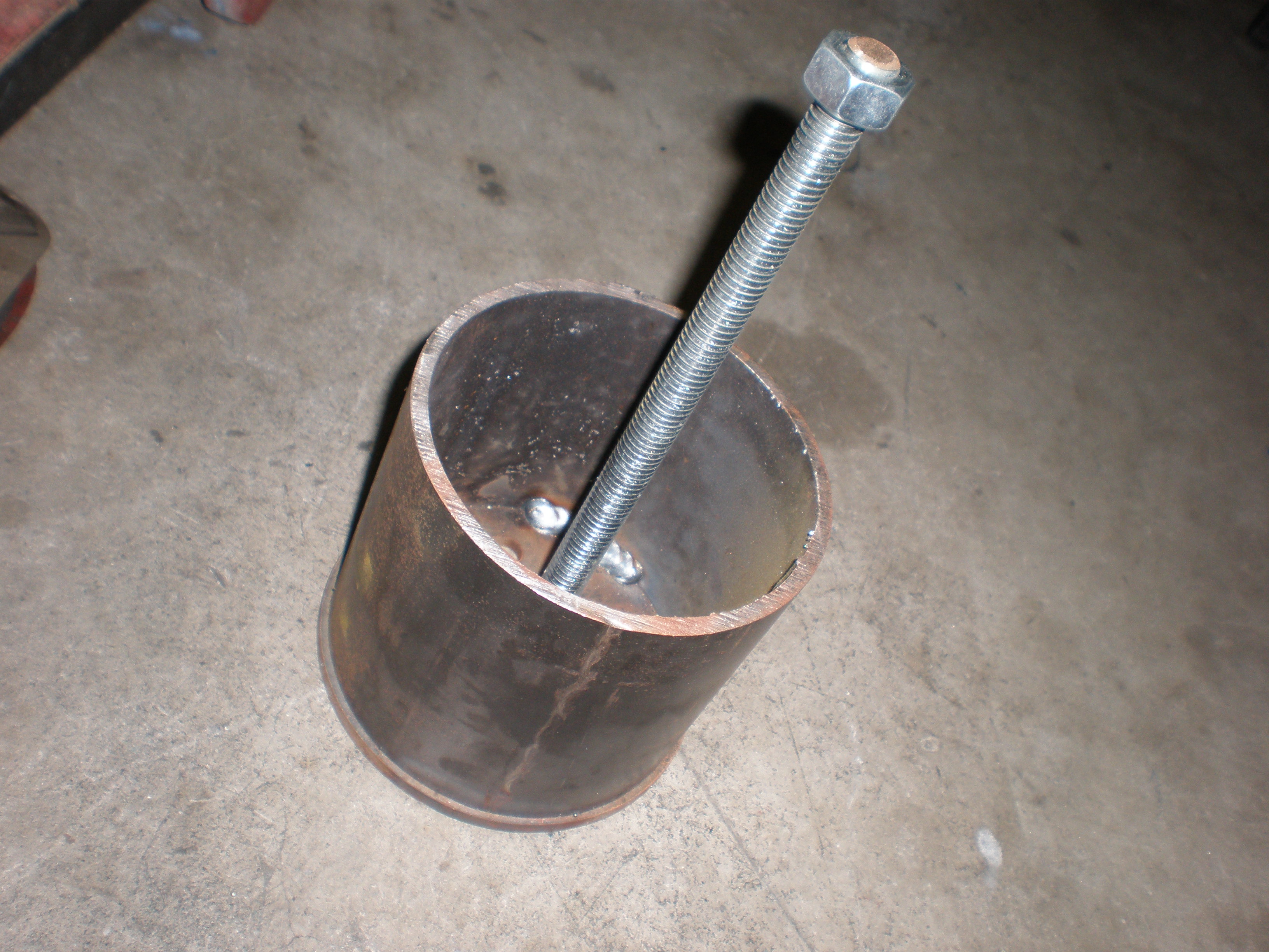

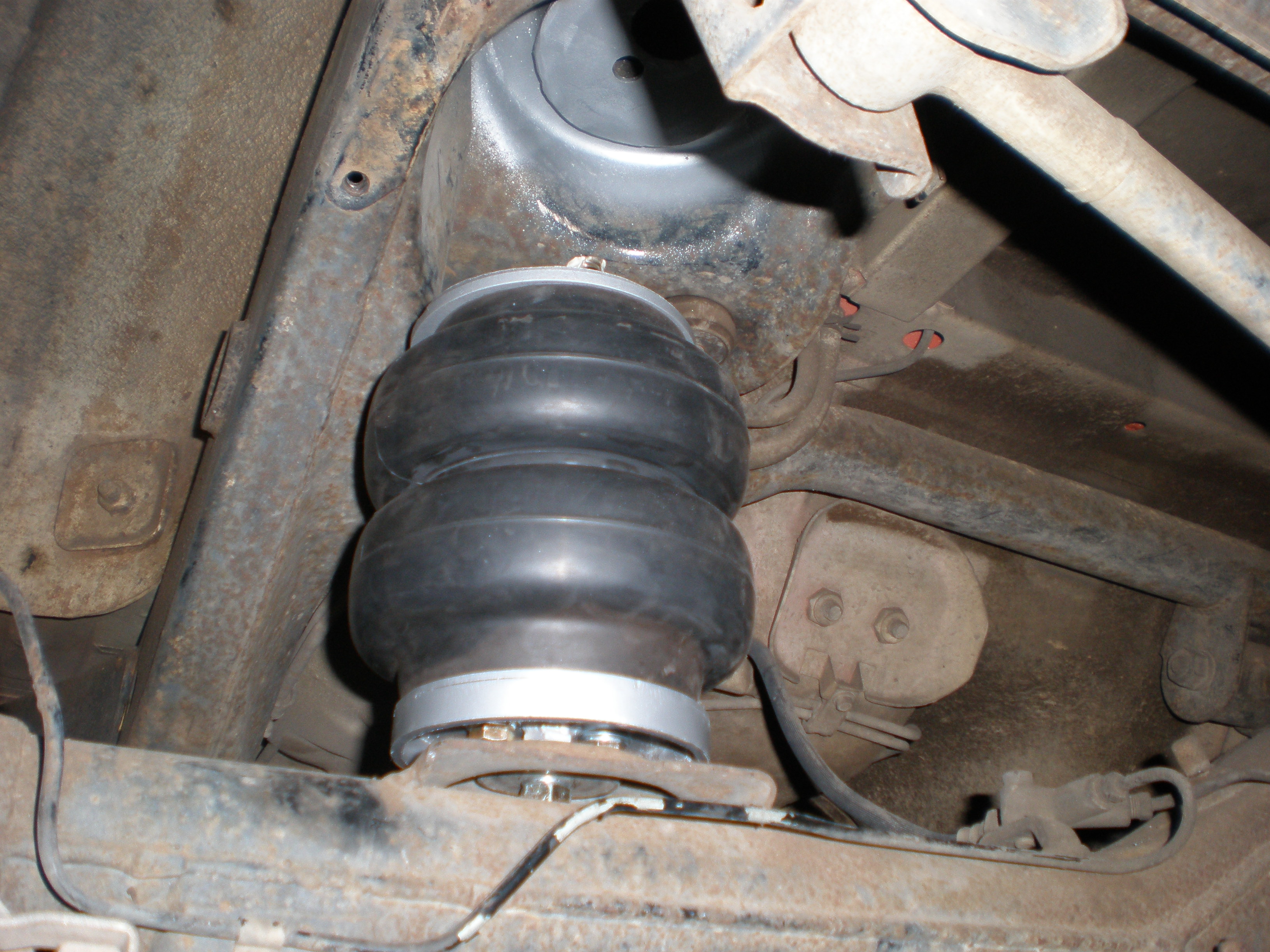

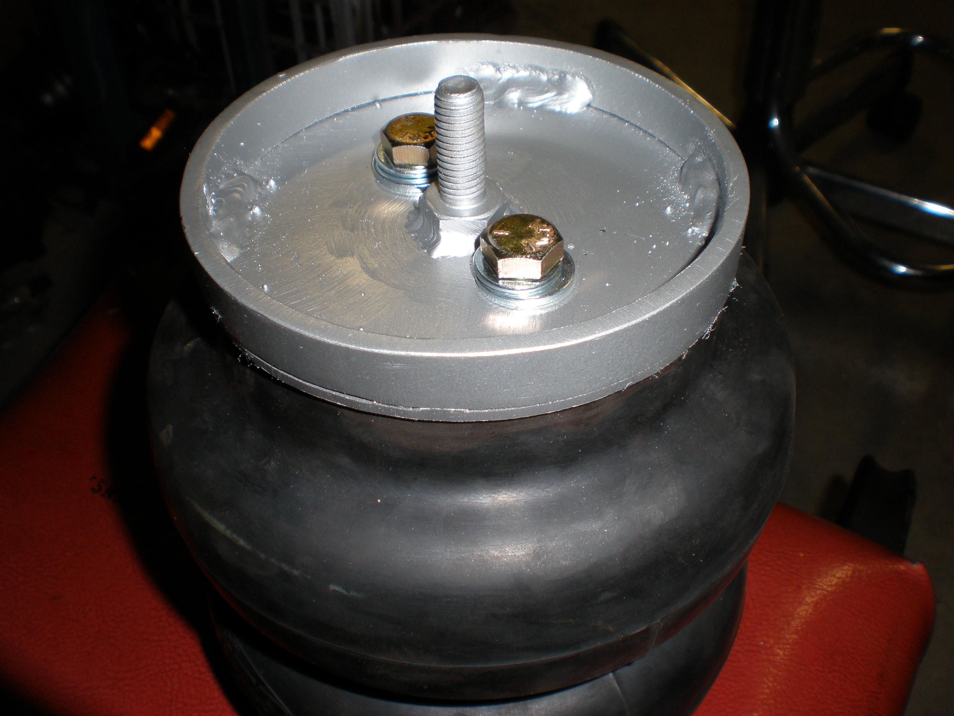

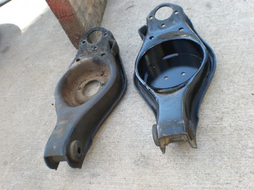

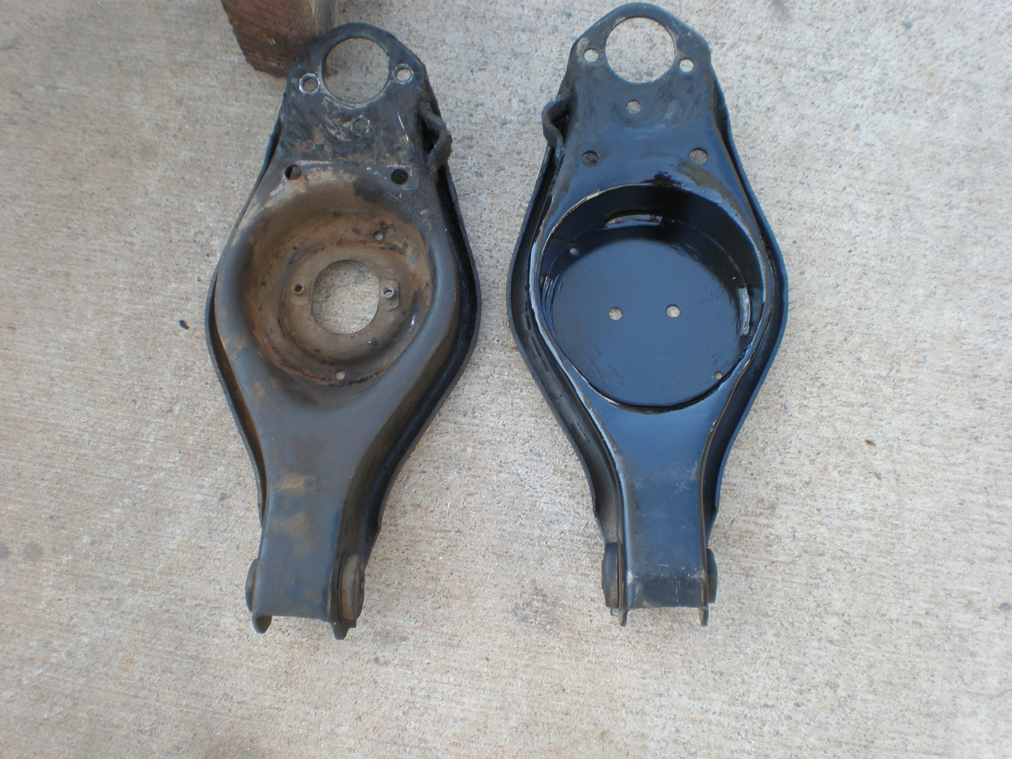

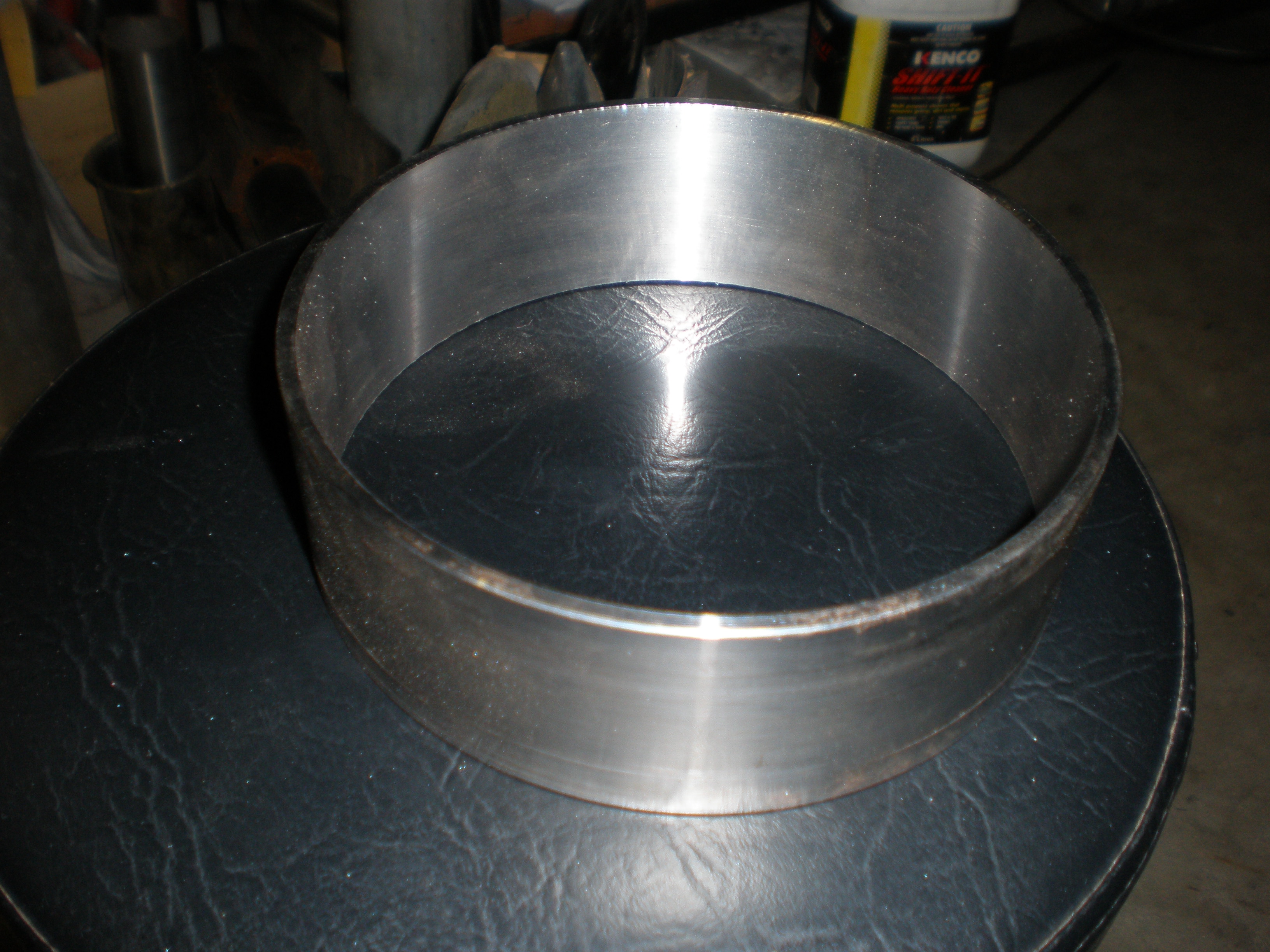

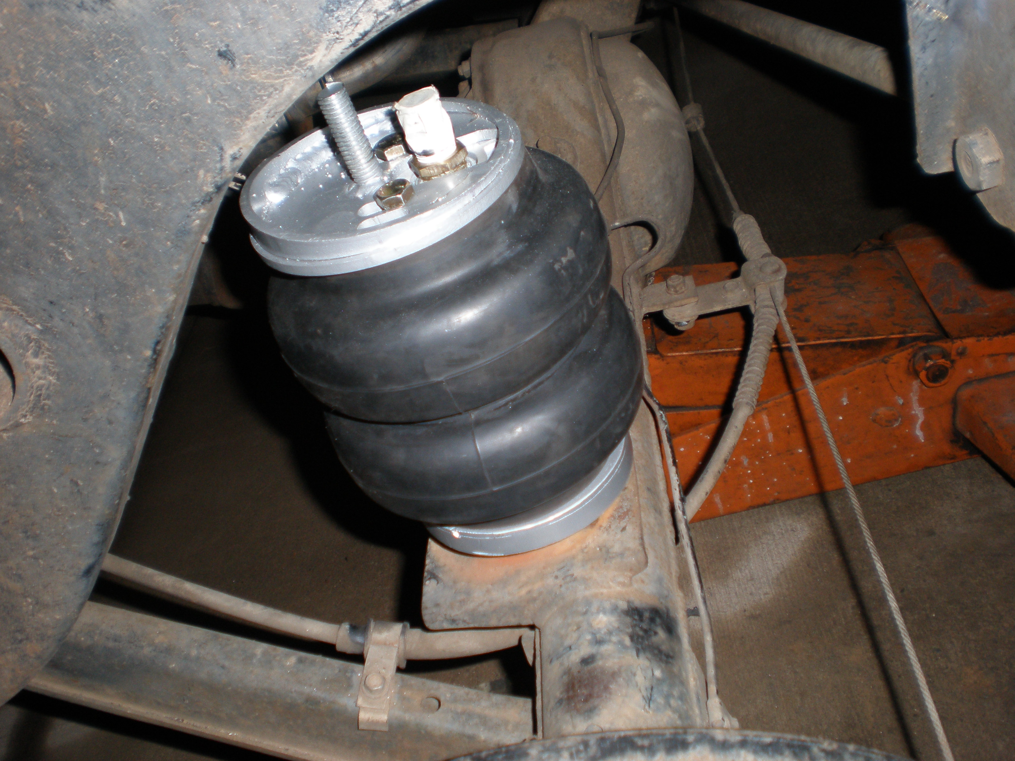

The rear I fabricated top hats which I welded to the inside ring of where the coil spring sits in the top. The top bracket which mounts to the airbag itself is on an angle for a reason. That is one secret with airbags. When the car is at its lowest stance the airbag must be perfectly level top and bottom.
The other particular thing I did was to make sure that if I ever needed to I could quite simply change the coils back over. Nothing needs to be changed.

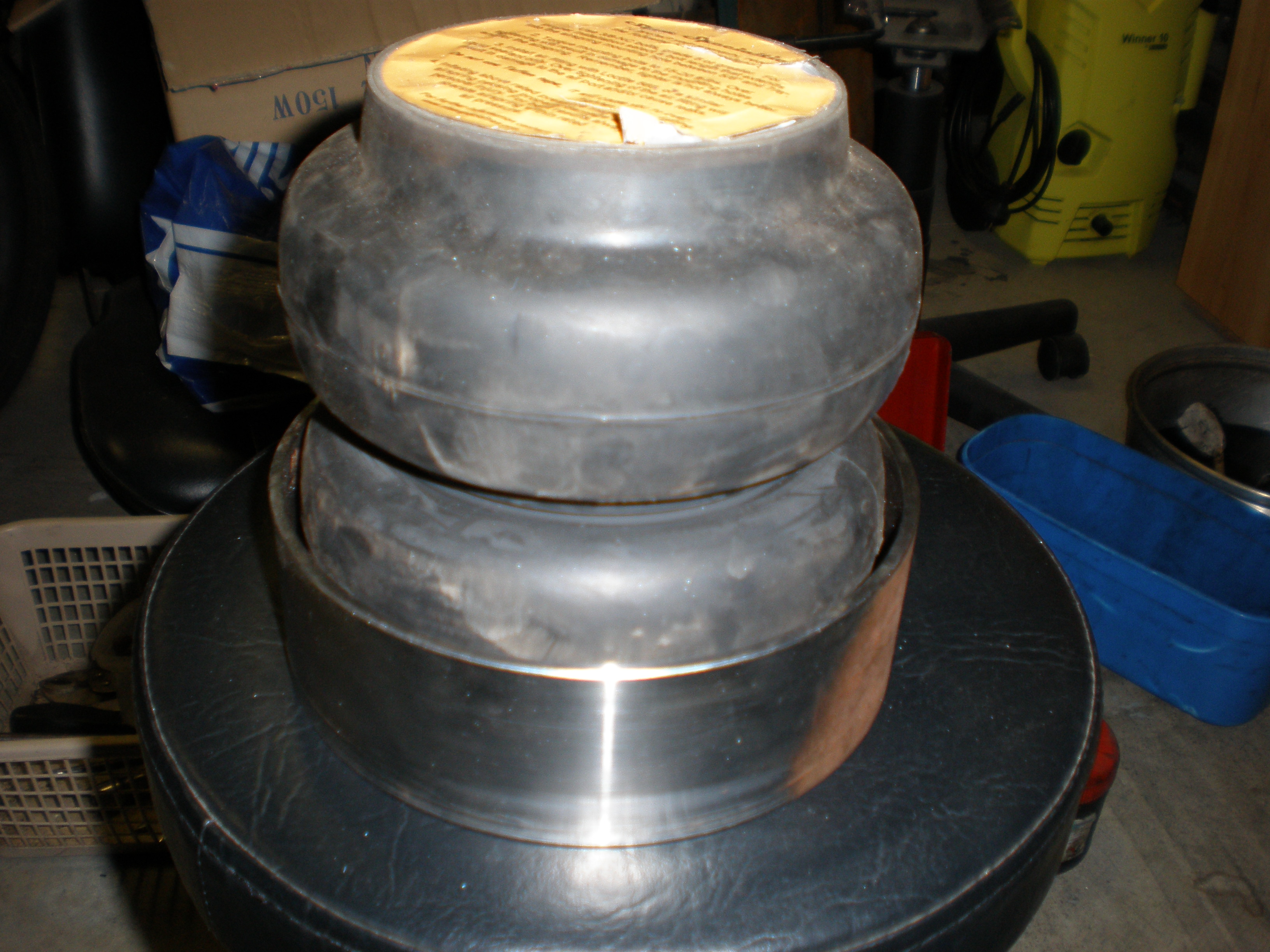

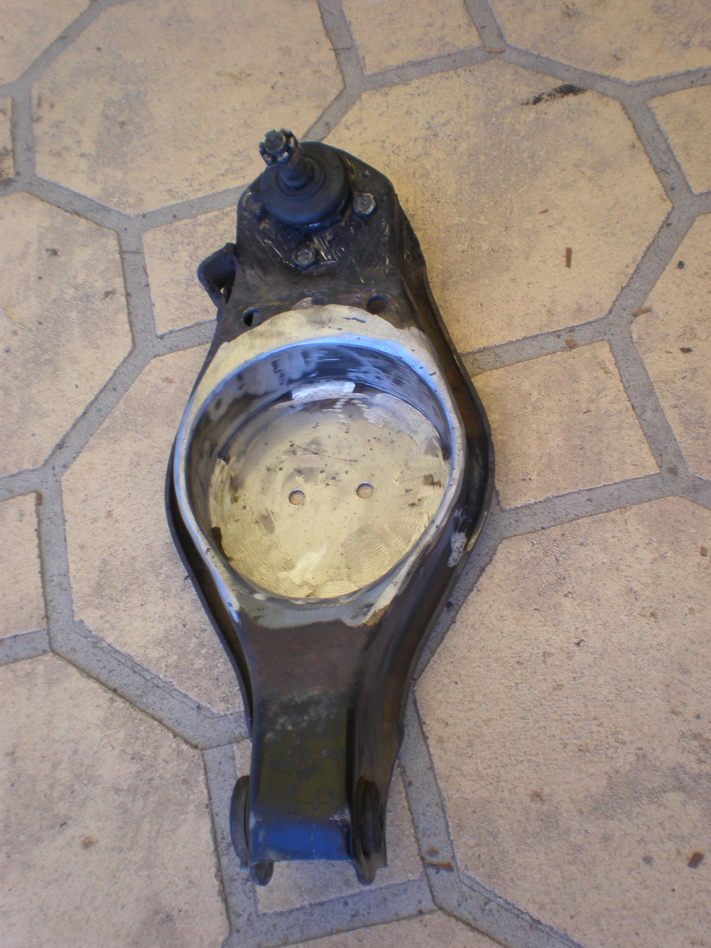

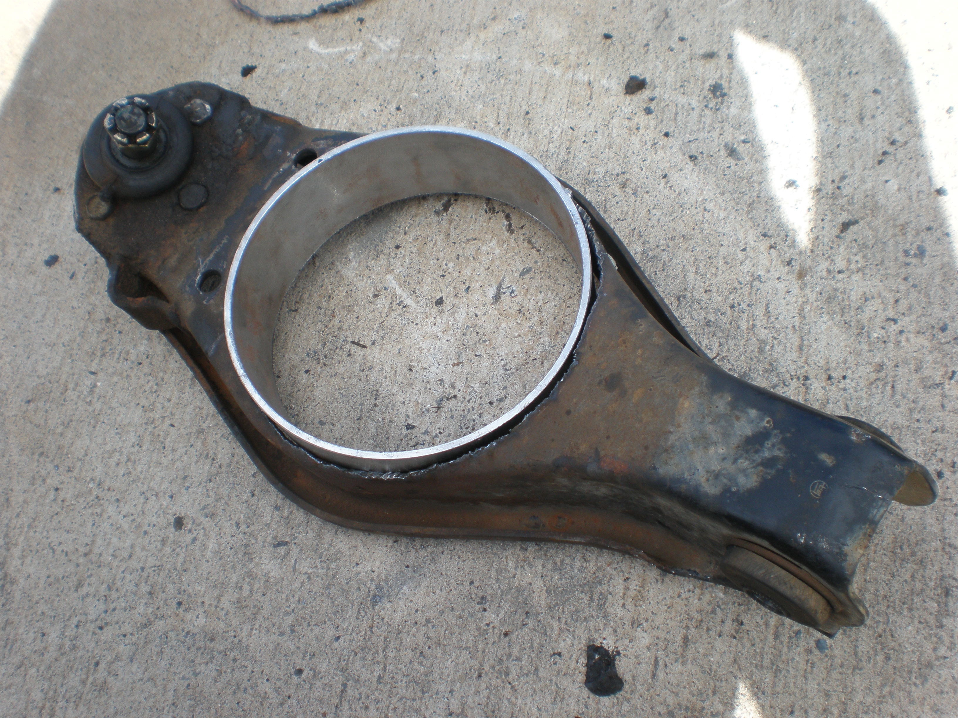

This ring I got machined so that the airbag could fit perfectly inside. This is the beginning of what I did to the front.

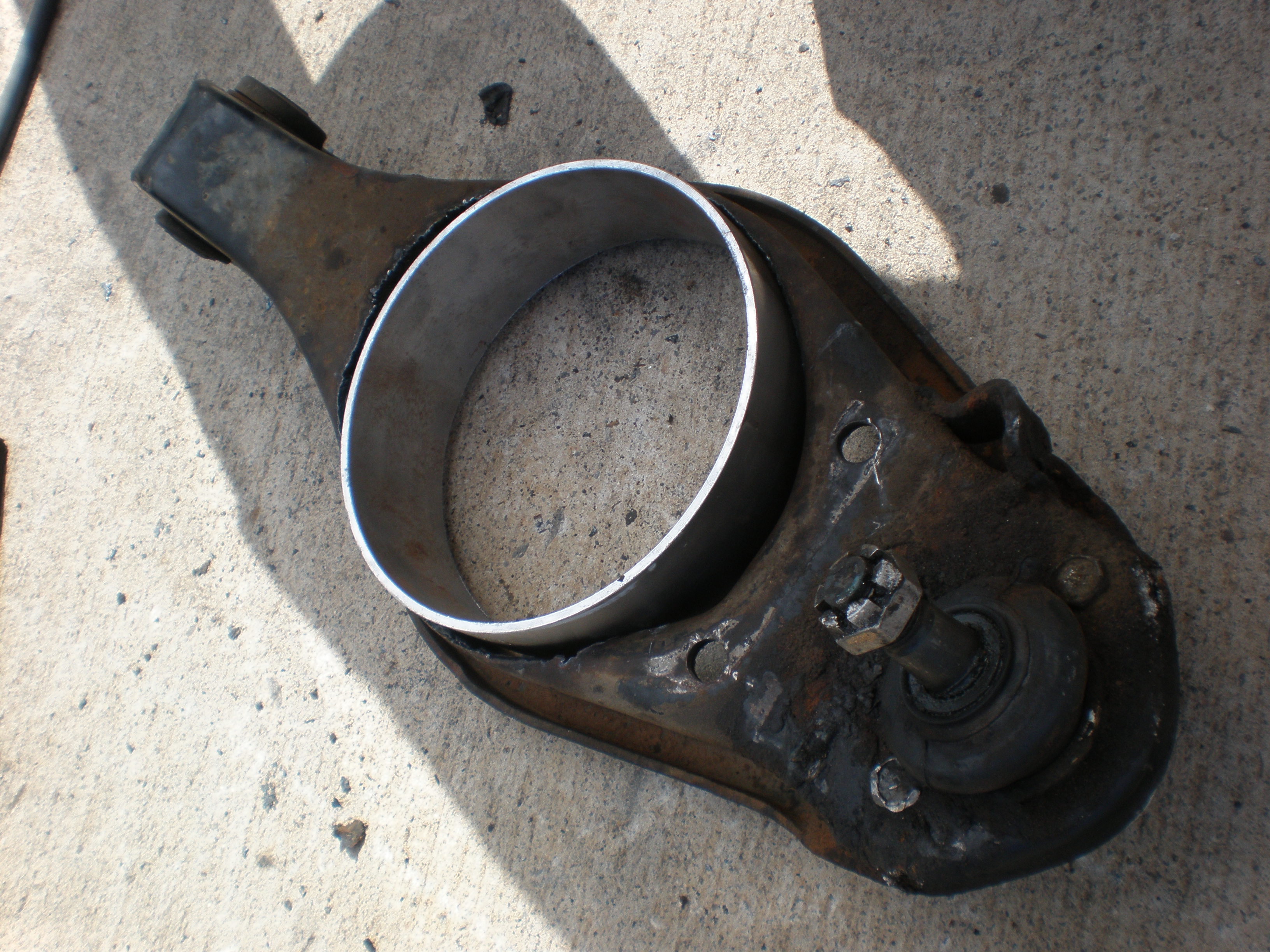

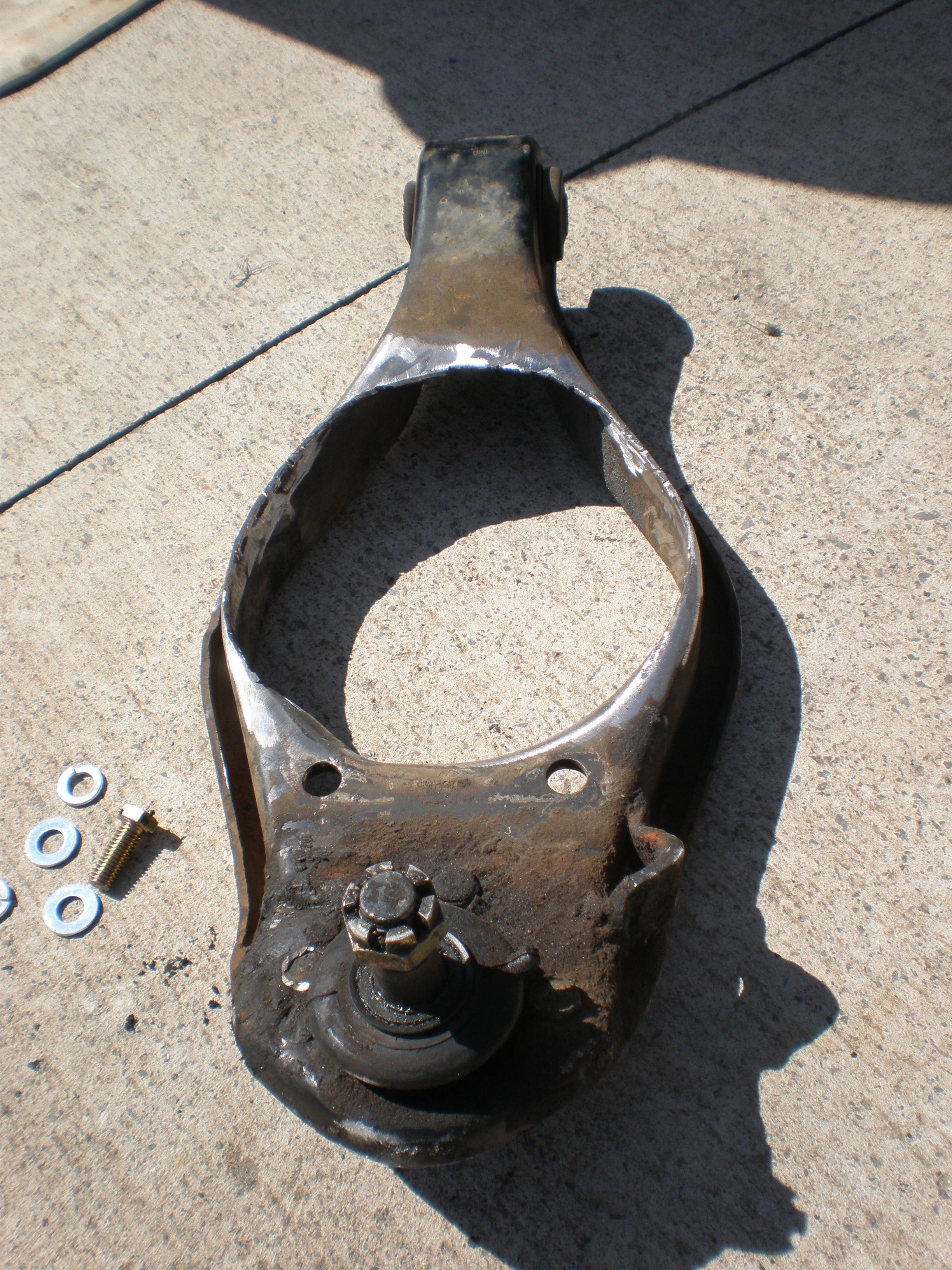

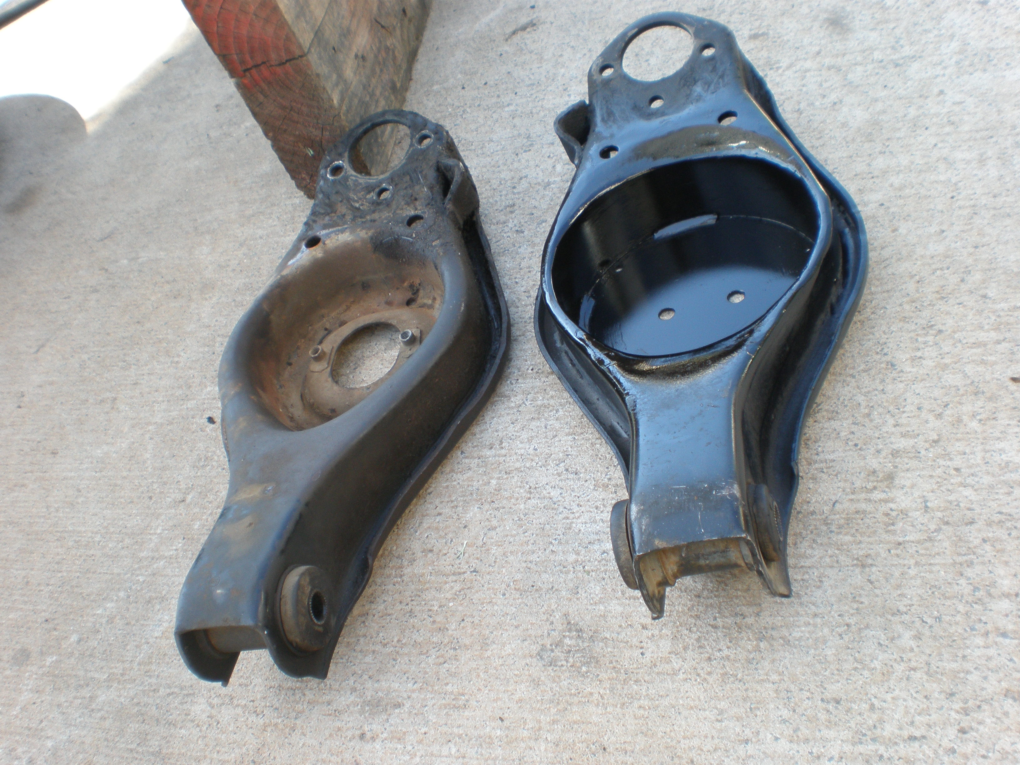

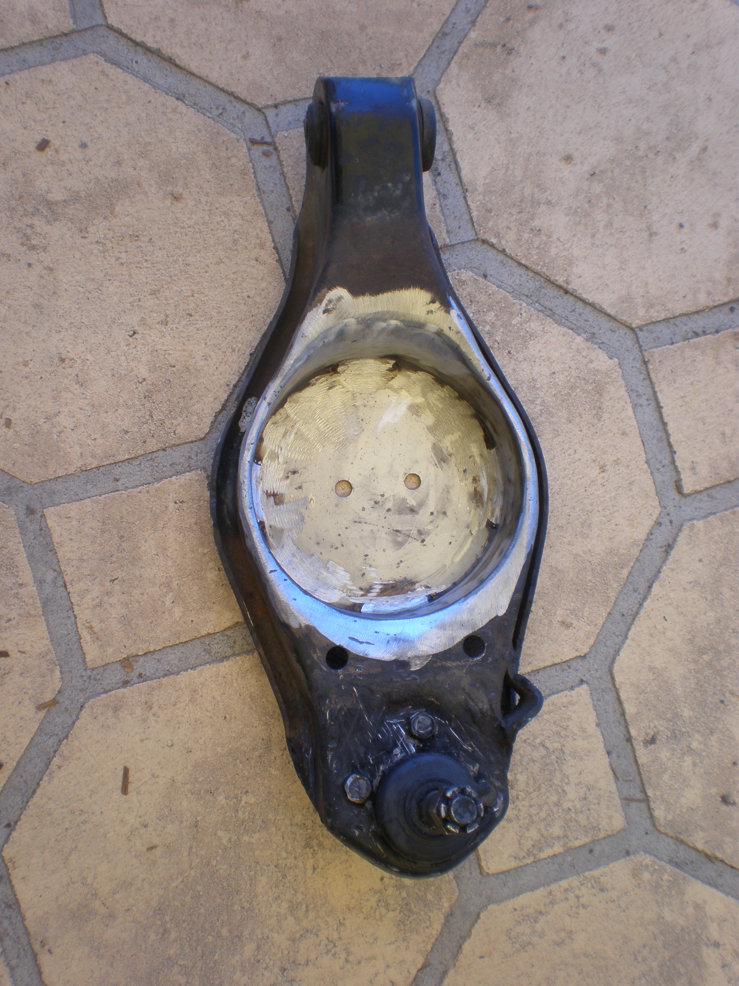

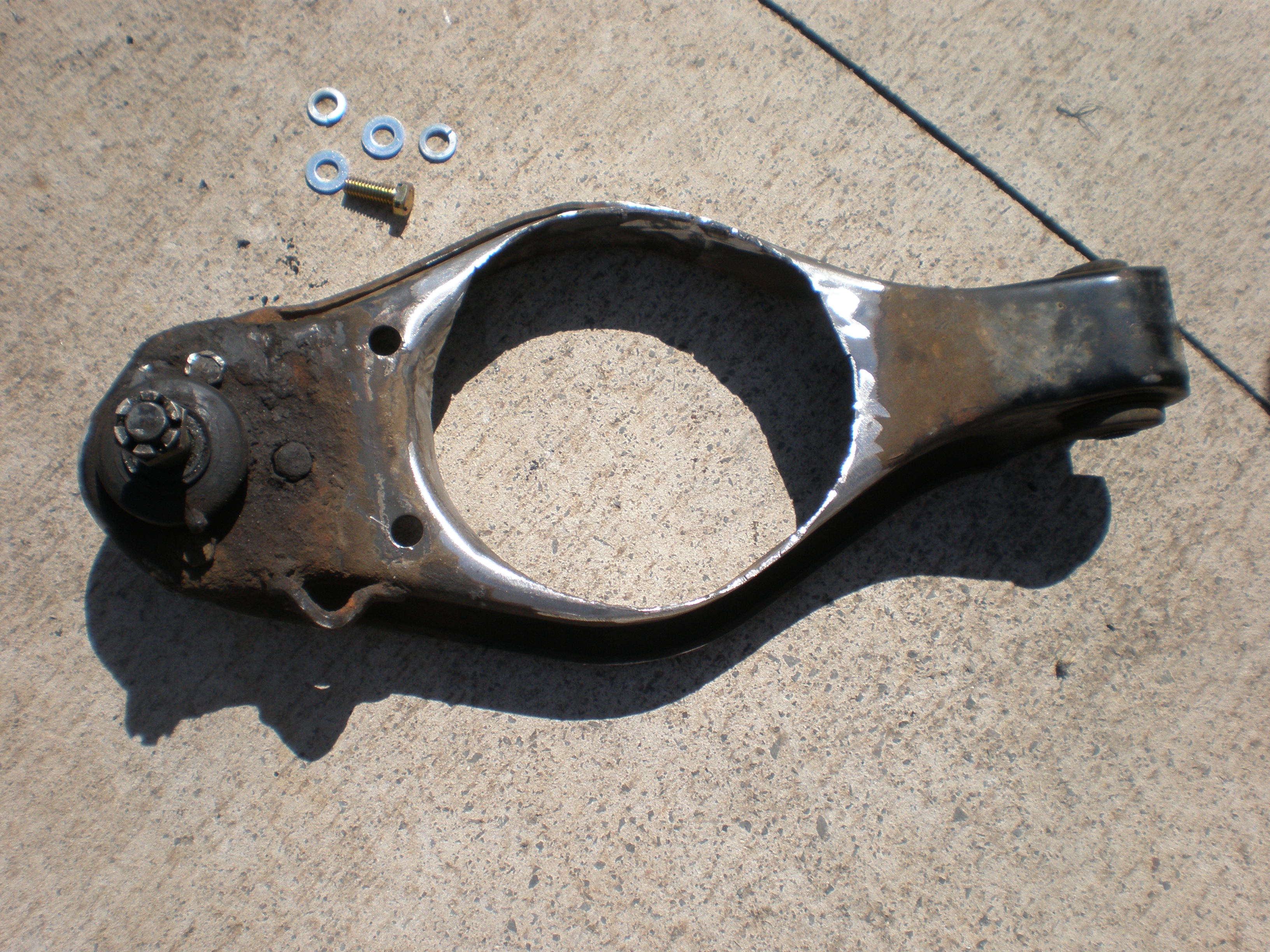

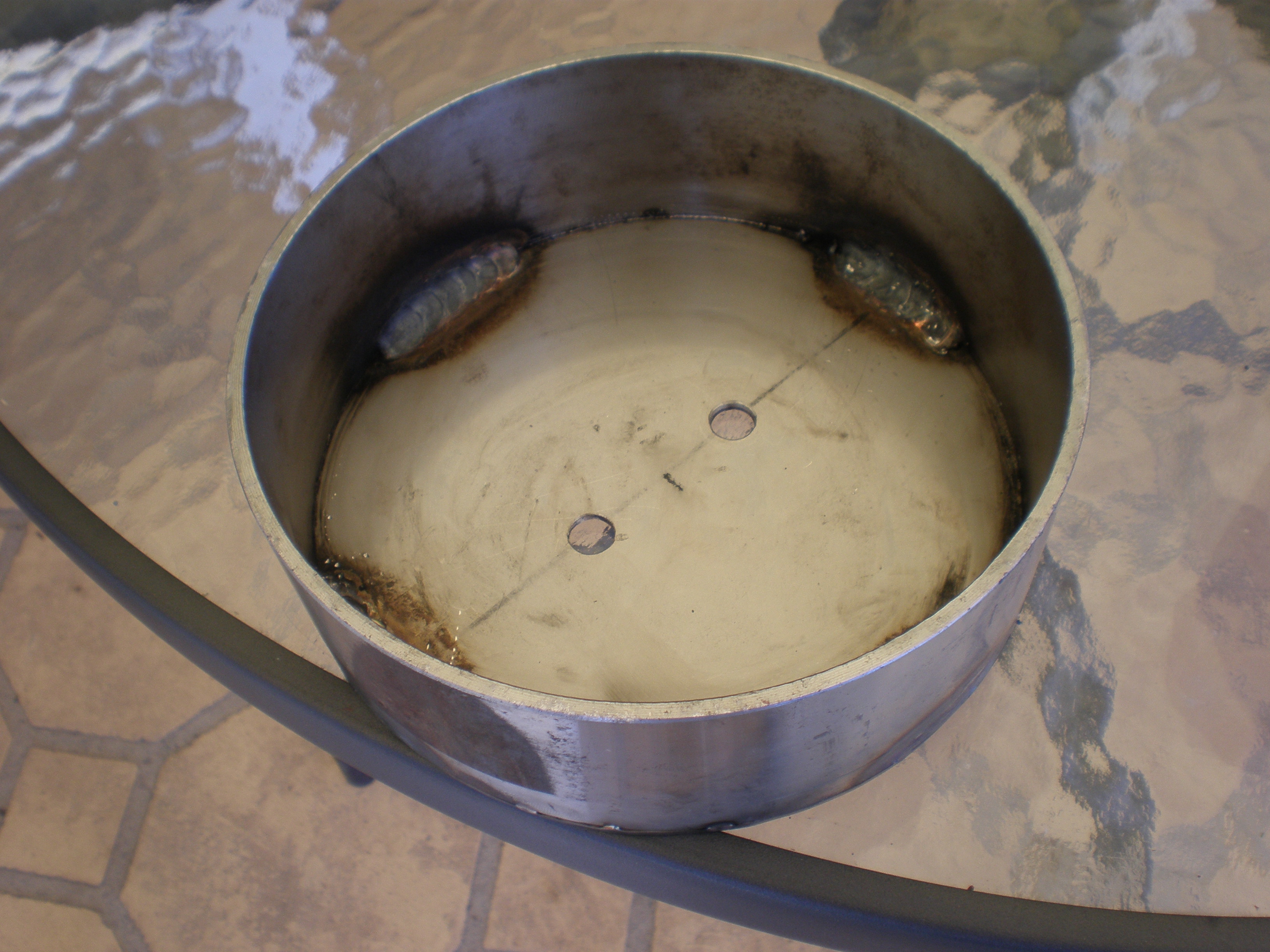

This is what I did for the front set-up. Initially it was hard because I had to start up the plasma cutter and cut a very large hole in the bottom arms. This hole was to suit the outside diameter of the machined rings.
First though I welded a stainless plate on the bottom of the machined ring and drilled some drain holes and mounting holes for the airbag.
The next part was very difficult, because again I had to somehow figure out where perfectly level both top and bottom of the airbag was at its lowest point. Once I got it though I welded in the ring and that was it. Another challenging job was relocating the shocks, but through much thinking and scratching of heads, I figured it out and it works well and is out of the way.
Anyway enjoy the pictures. ;) :thumbsup:

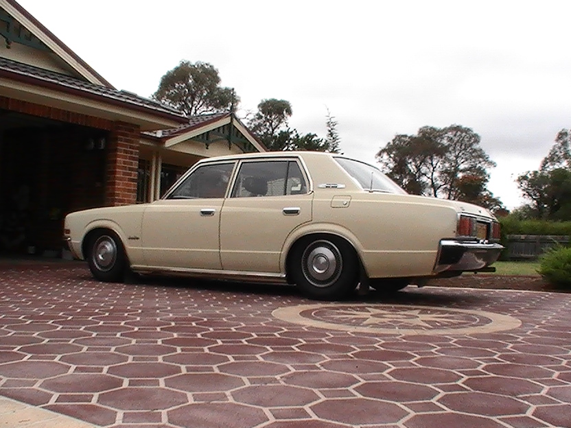

Yes I do have photo's of the crown complete with airbags. But I won't put them up until tomorrow.

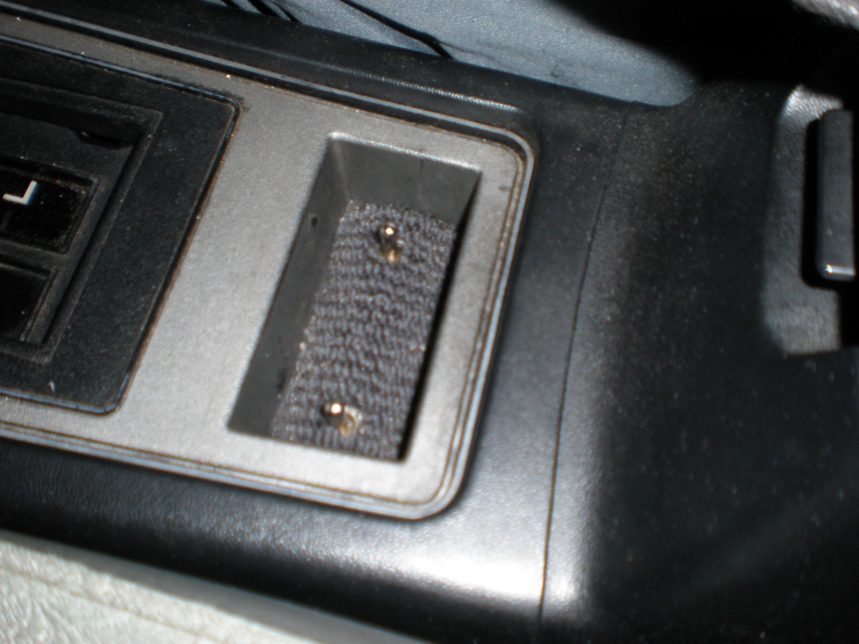

Also about the radio I am not sure if it had self seeking. When I bought the car it had just a cd player in it with a gap above it where the pressure gauges are now. The radio's that used to come in the crown had a tape player aswell. So I was spewing that it didn't have that radio and tape player in it. ;) :thumbsup:

No the 4M does not run hot. It really just runs perfect. Couldn't ask for better.
As for the modifications, one thing I can say is that I have done all of this work in a manner that will allow me to swap everything back over to standard if it is ever needed. Other than that, I also will say that I have done my best to restore the car a little bit in the process aswell as keep it as standard looking as possible.

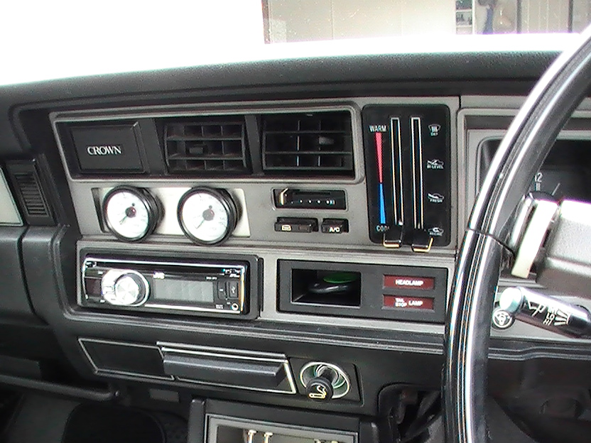

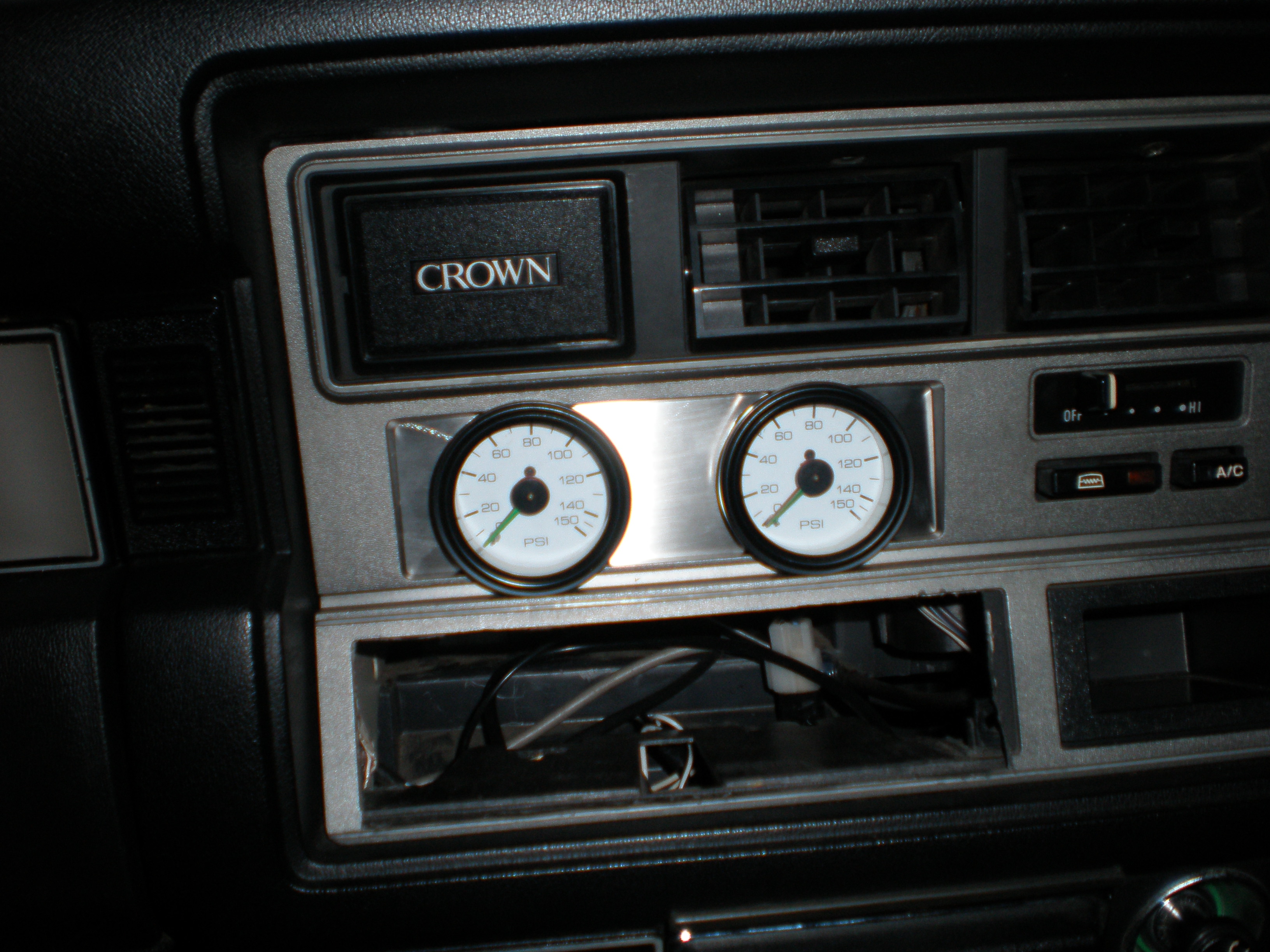

As I mentioned before, the car came with no radio so I had big holes in the dash that I needed to fill up. In the boot there was no panel to cover the fuel tank, so I made one of them aswell. It is hard when you have to try and make do with what you have, and especially when you can't source out the original parts to fit back in.

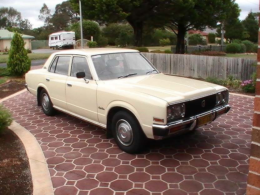

So here are some pictures of the airbags complete and the crown at its final stance.

Oh and by the way. ALL of the photo's that you can see of the Crown itself were taken today. I just didn't want to put up before and after shots straight after each other.
