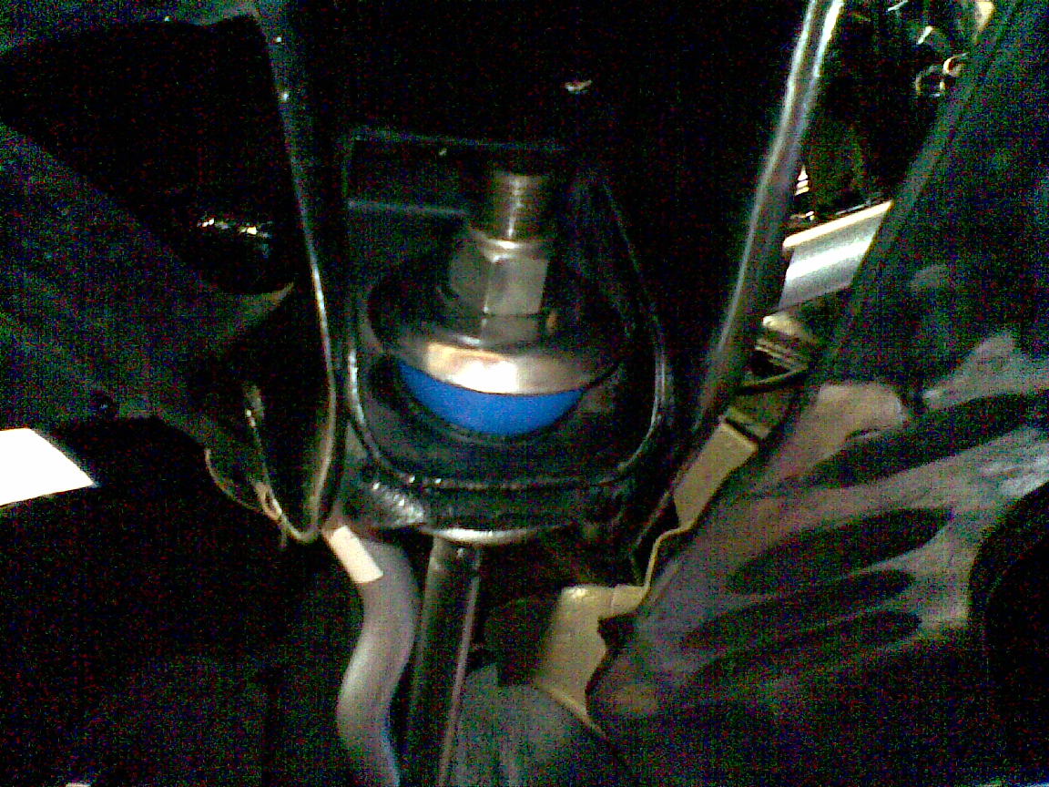

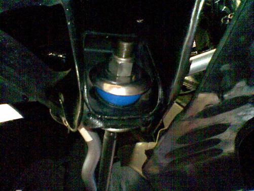

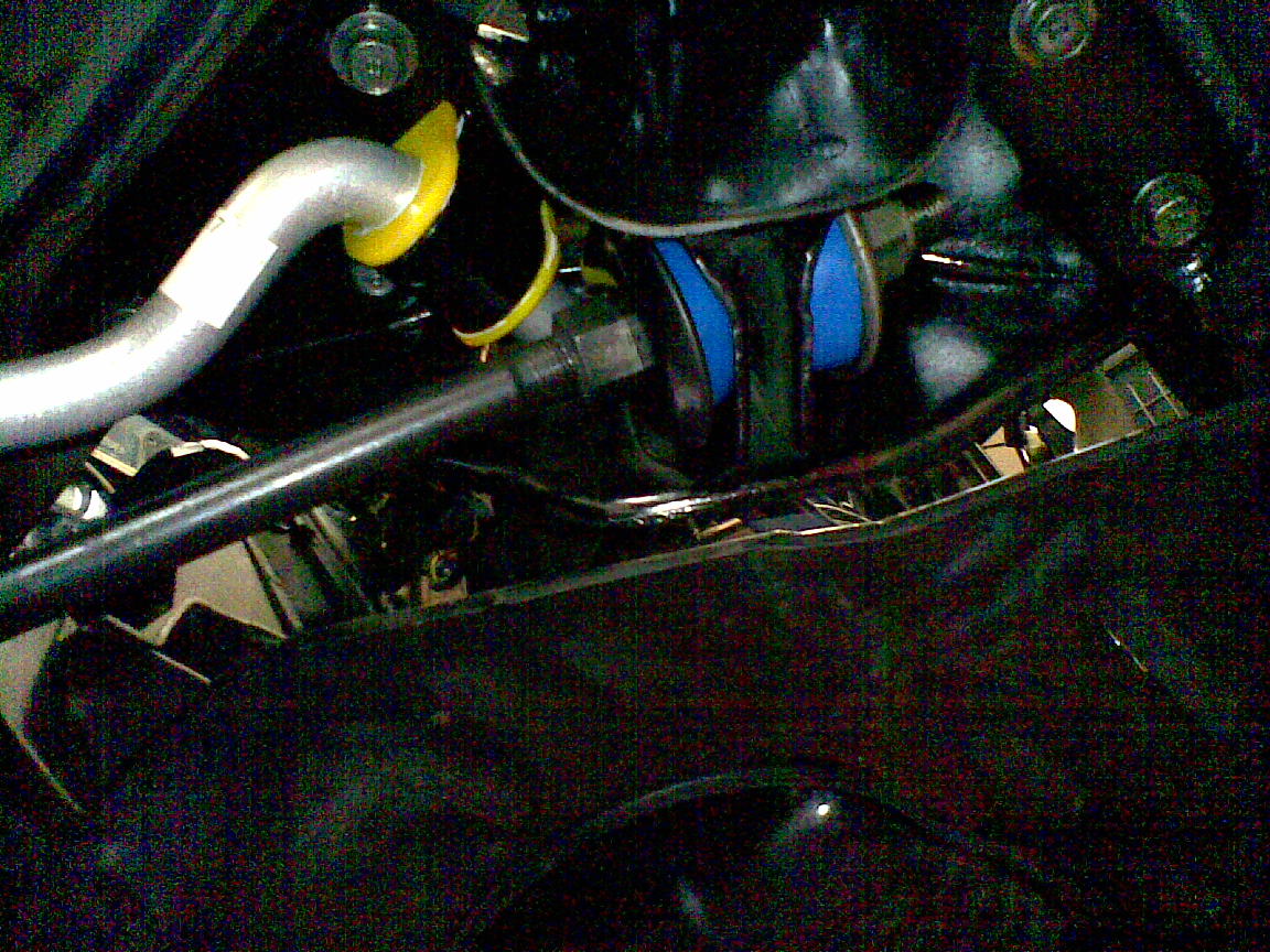

All the suspension gear is now in as well as a whiteline swaybar :blush: Looks really good under the car now as i have cleaned up all the bolts, painted the caster rod brackets and caster rods and polished up some bits and pieces.
