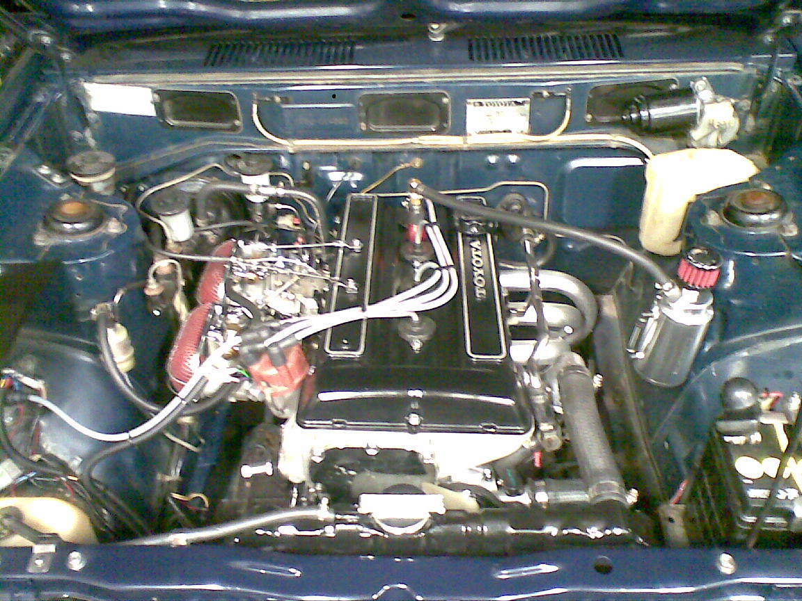

Car is finally on the road. Got the catch can done today. Ended up settling on a 'supershit auto' one. As i really wanted to drive it this weekend rather than taking ages to save up for an awesome one.
Photos to follow tomorrow afternoon after i detail graham to my standards :P But for now here's an engine bay shot from my phone.
P.S I love driving this machine!
