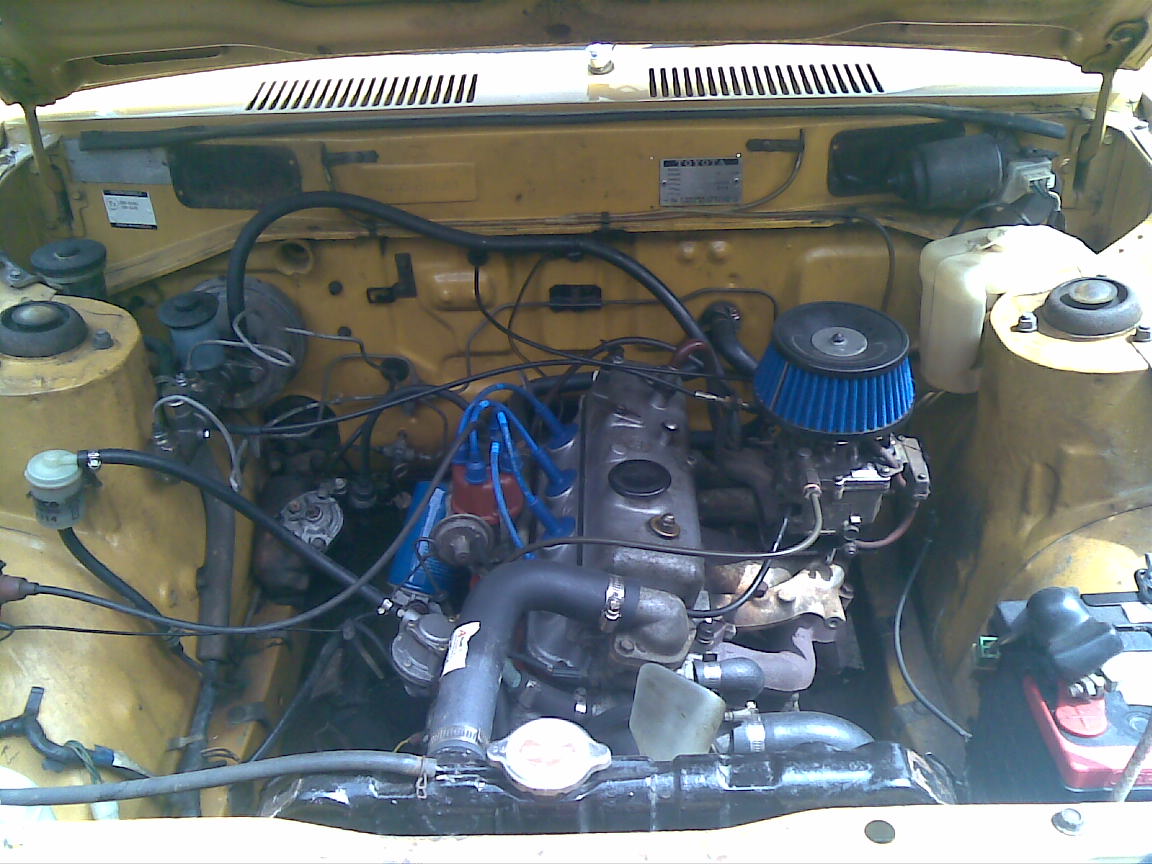

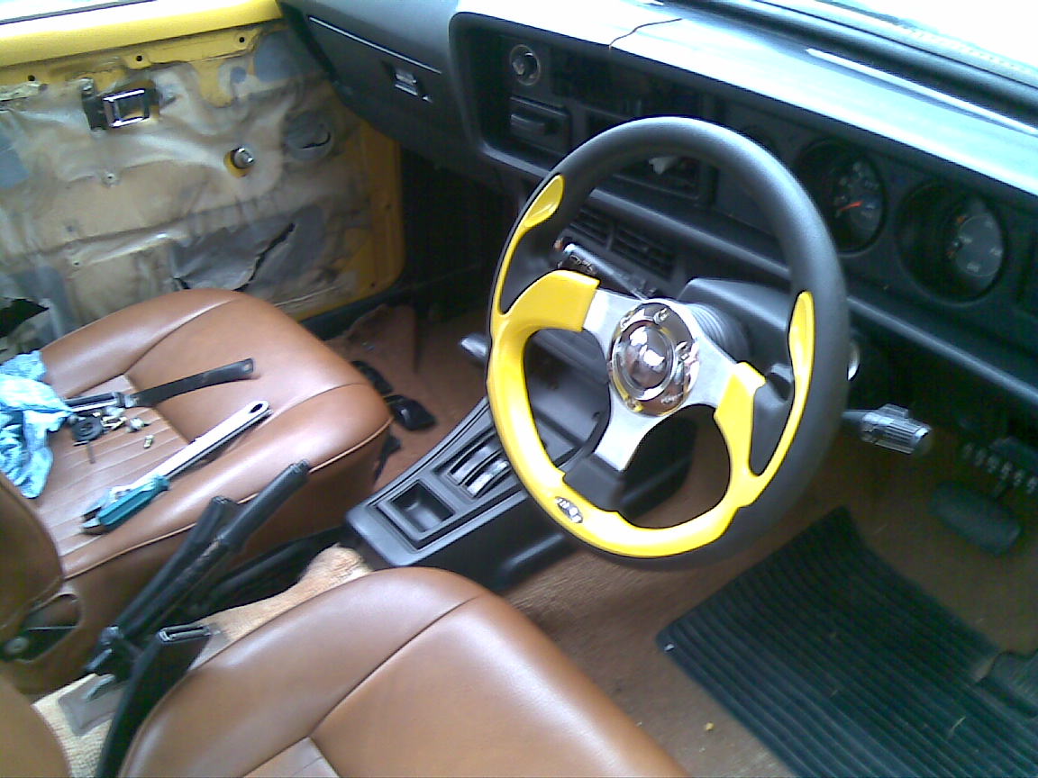

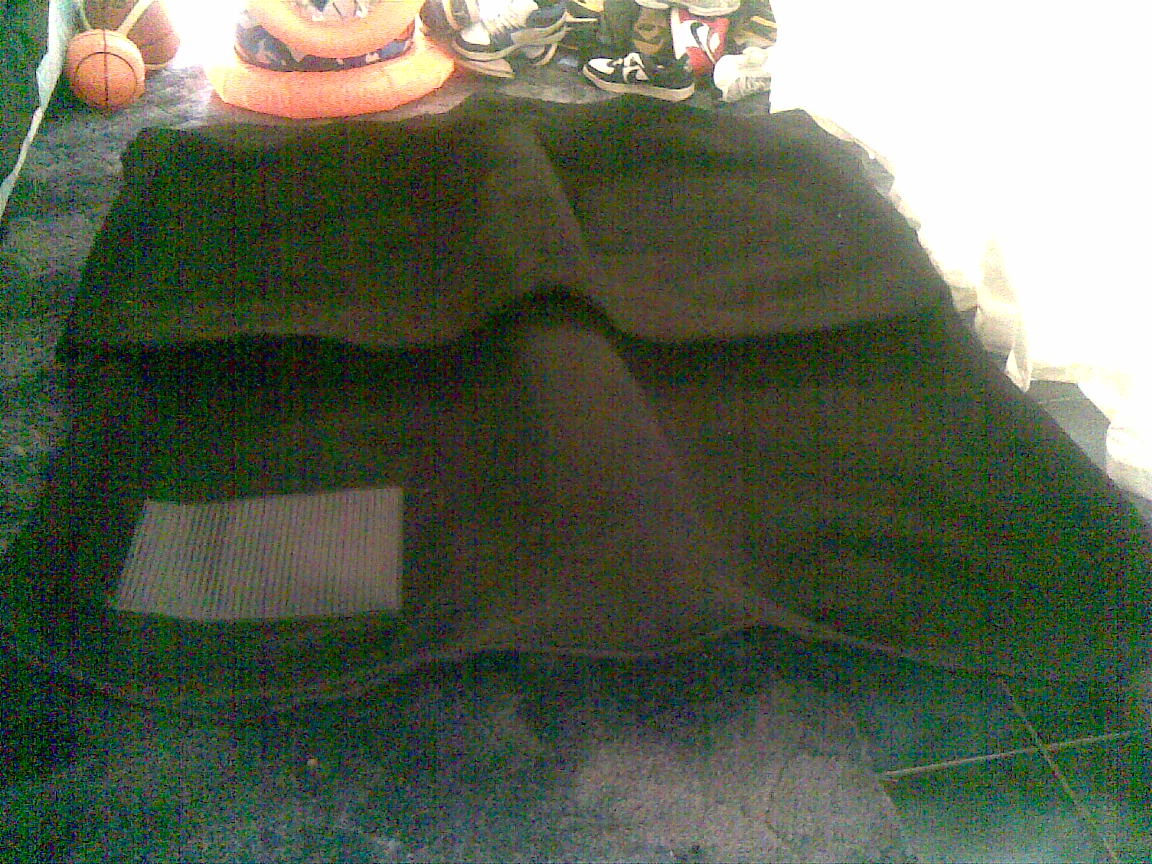

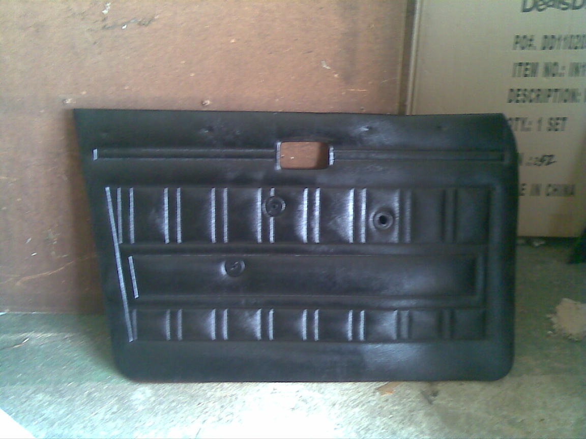

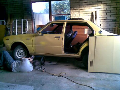

Finn.KE30 Posted February 14, 2010 Author Report Posted February 14, 2010 First update on whats been done, this is just a few pics to show what ive started. think ima make it yellow on outside, lowered, better mags, and tinted windows. and heres a few other things. My sound system is getting delivered aswell. ^ New sporty wheel, feels good :) and door panels off ^ Door panels new colour, was brown. Need one more coat on em tho. Under my hood, only a 3k Auto. Had to get new rear View mirrors, mine were odd ones -.- My carpet waiting to be put it in. Leave some hints or ideas :) Quote

Evan G Posted February 21, 2010 Report Posted February 21, 2010 (edited) do you get insane induction with the pod filter on? also you should run a fan shroud, it cools the engine down more by sucking air from the whole surface area of the radiator not just from were the fan is Edited February 21, 2010 by Evan G Quote

Finn.KE30 Posted March 23, 2010 Author Report Posted March 23, 2010 If i buy new seats, sport race seats for example ;) would i have to get new rails? need to know before i cut the carpet for my current seats, or wait til got new ones :lol: ;) or wont it matter cuz wont be cut much anyway? should i put it in now with current seats or wait? thanks :o Quote
Taz_Rx Posted March 24, 2010 Report Posted March 24, 2010 You can adapt pretty much any seat to the stock rails. So, put your carpet in now and cut some holes for the stock mounts, and then your new seats will still use the same mounts/holes. ;) Quote
