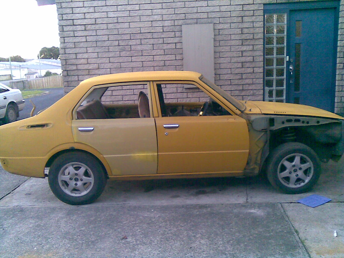

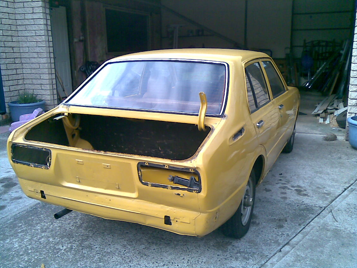

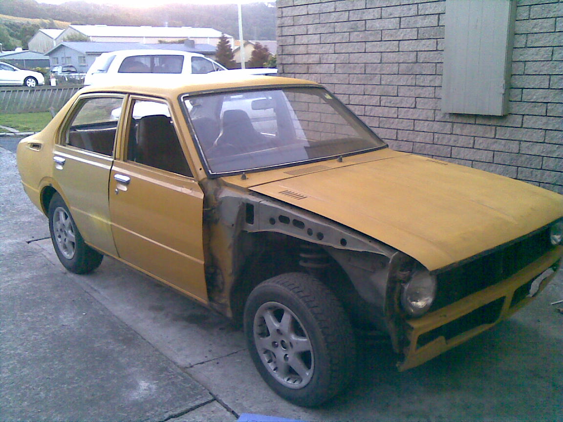

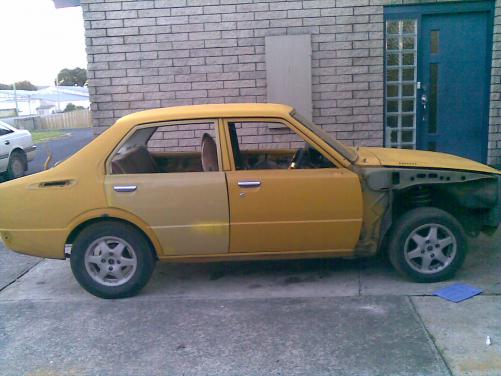

took it all apart yesterdayyy,
wads supposed to start sanding / roughing up and fixing rust today, but it rained. and my shed is full of crap so that stopped a days work :P

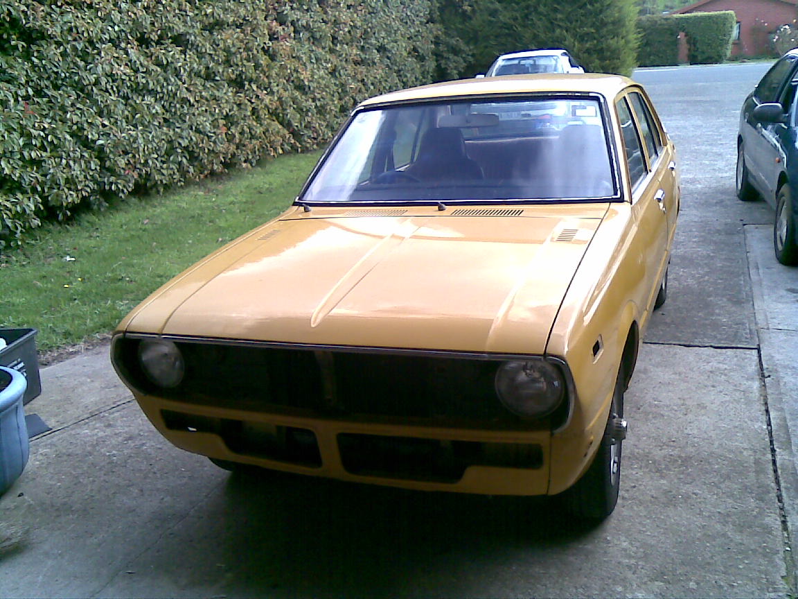

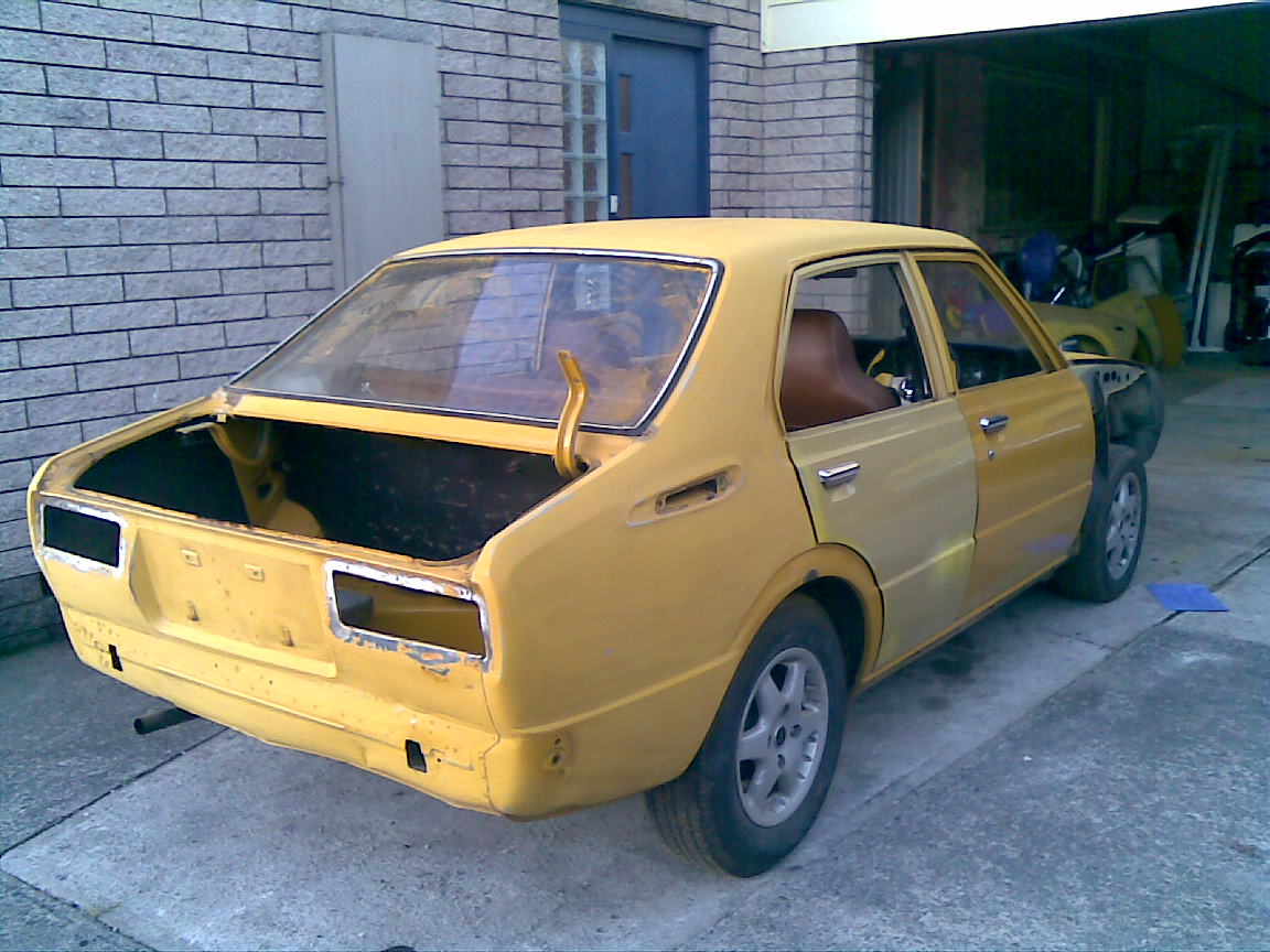

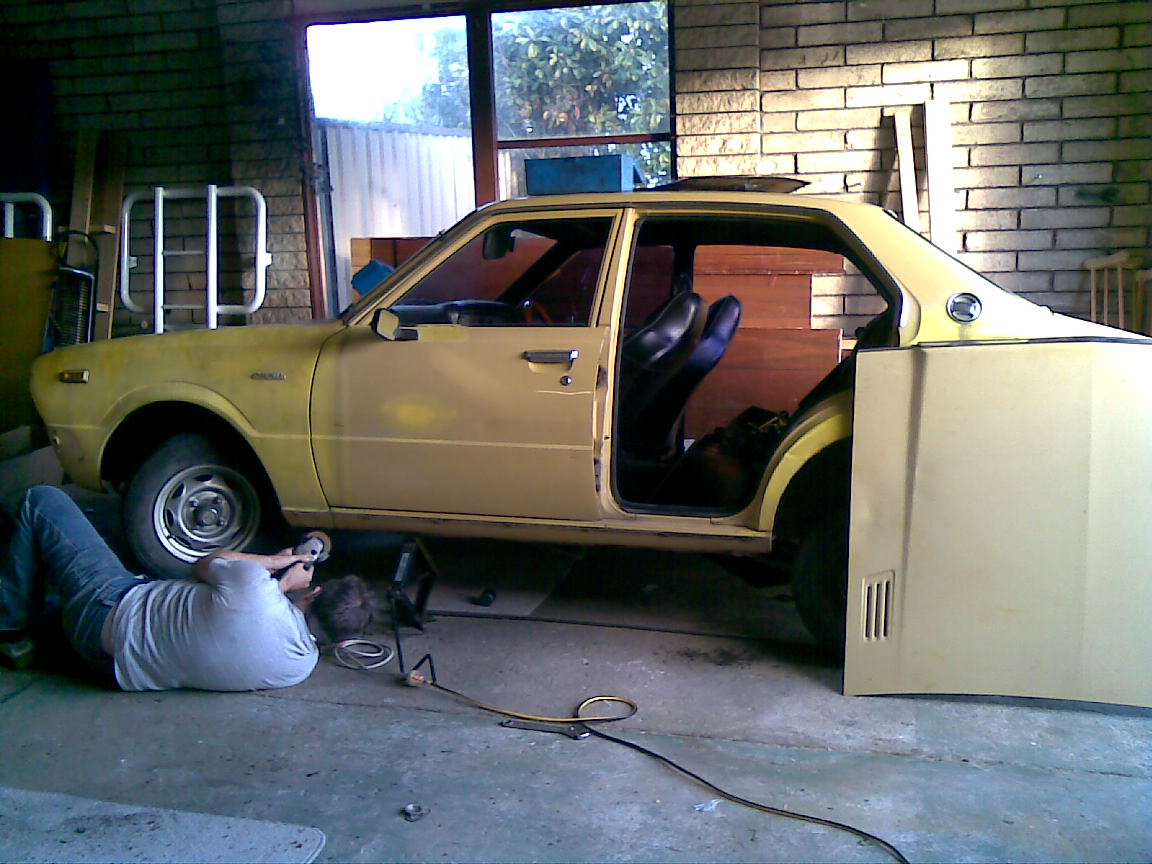

This is so farr.. so far so good i guess
And the parts are off this KE55e which i picked up for 200 bucks :abuse: tell me if u need any parts, and ill see what i got ;D
