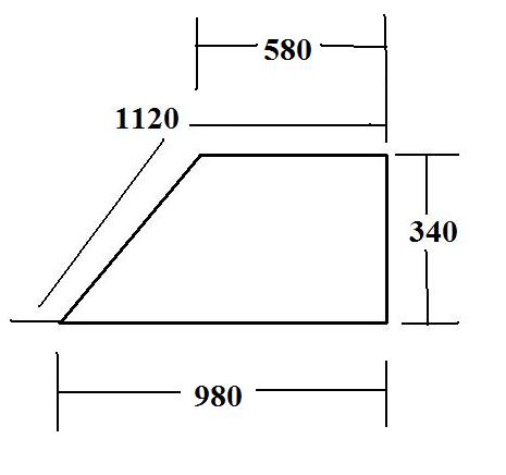

Hey don't know if this helps but from the back corner to the top back corner is 340mm and from that same corner following the window all the way down to the front is 1120.....i'll draw a pic

yeah that might just be enough info that i need
yes please that would be great
ummm....the bottom of the window is roughly 980 and also the top of the window where it angles down is about 580mm from the back corner....update VVVV
If calculations are correct:
The bottom angle should be:
= 40.36 degrees
And the top angle should be:
= 139.64 degrees
Hardtop share glass with the Aussie T18, wagon is not compatible due to lower roof line on coupe/hardtop/liftback. The angles on the wagon/panelvan are the same as the 4 door or 2 door sedan and the doors interchange other than the rear door quarter window shape being different, can swap over window frame if required though.
