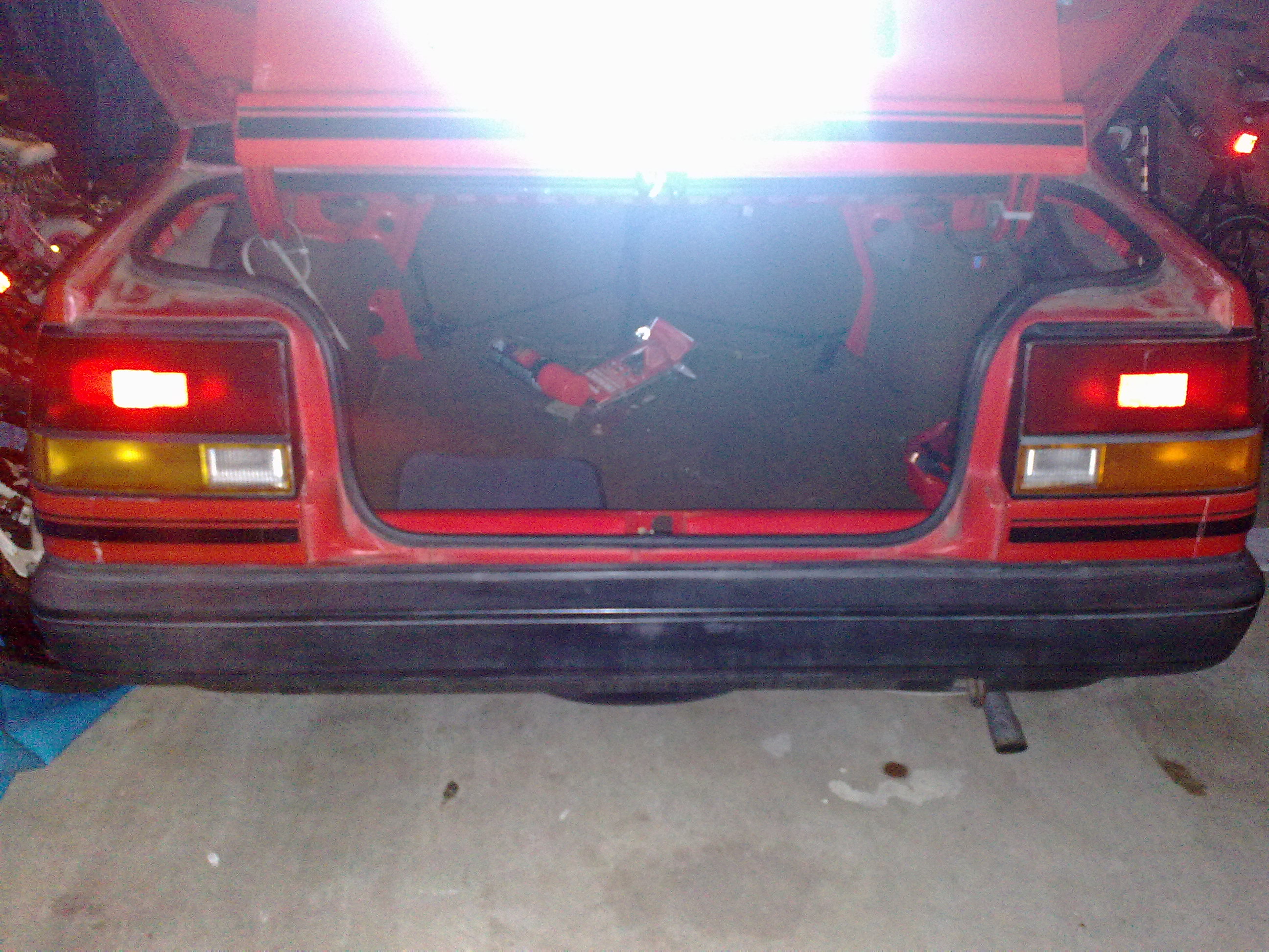

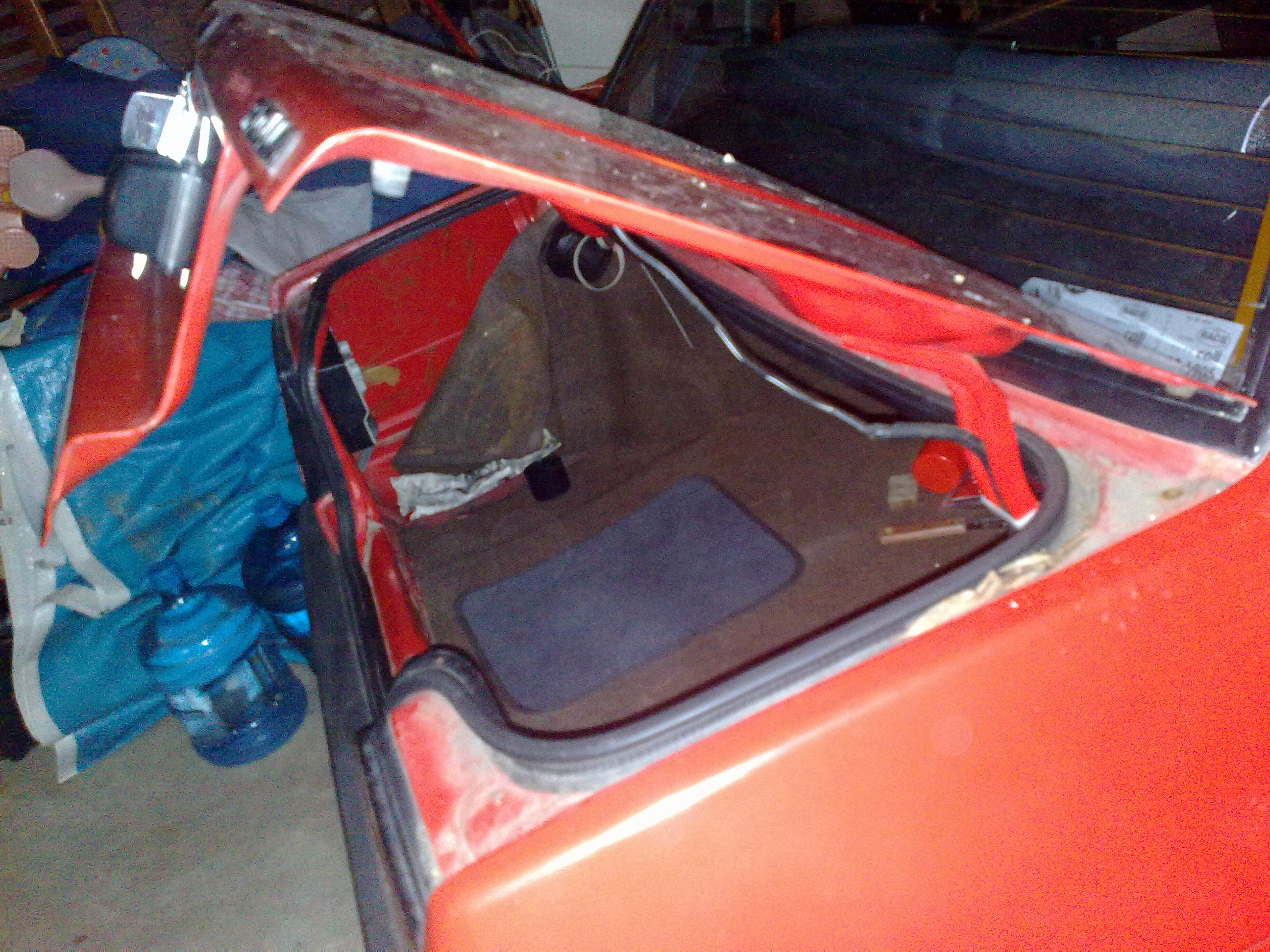

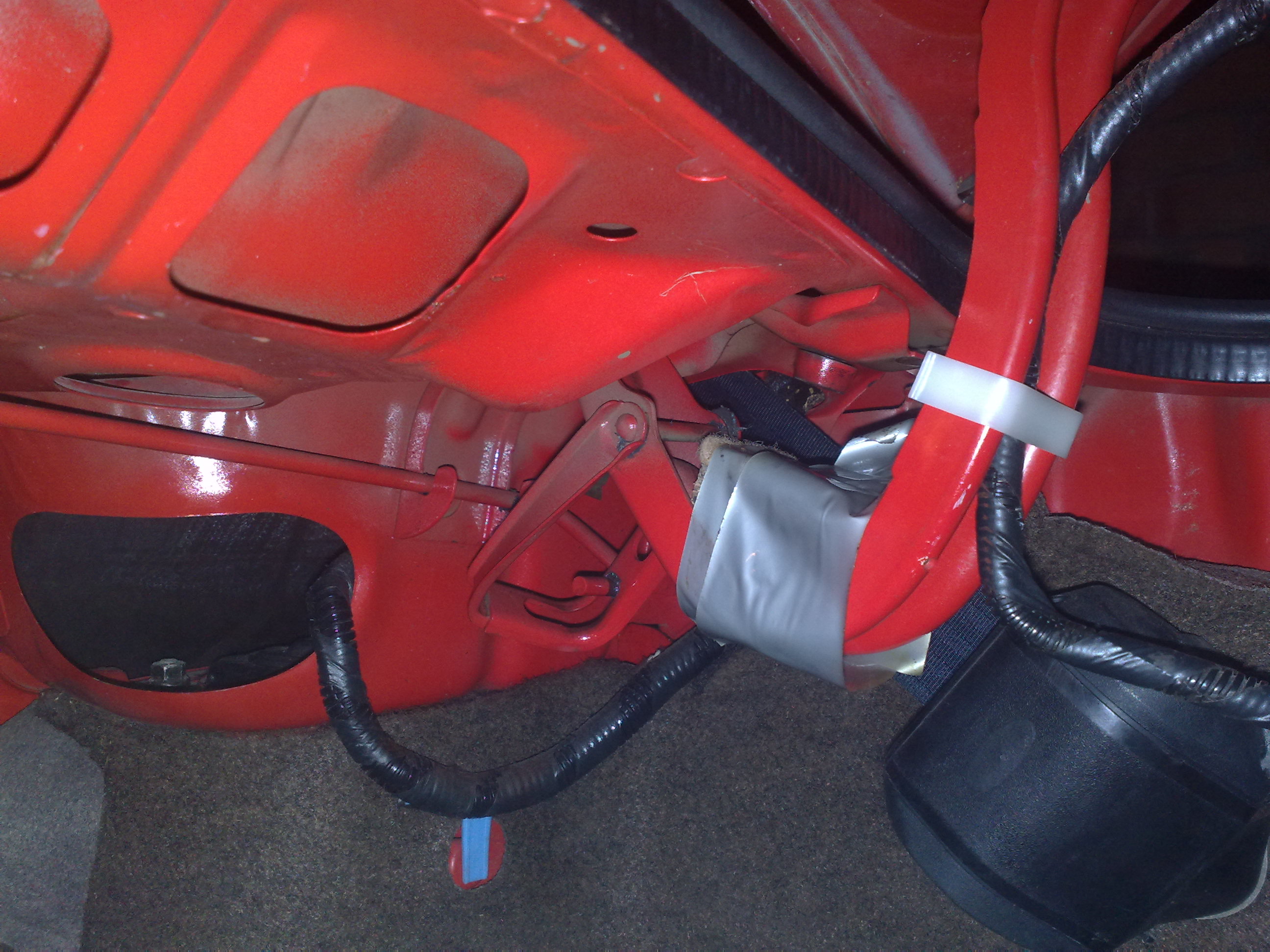

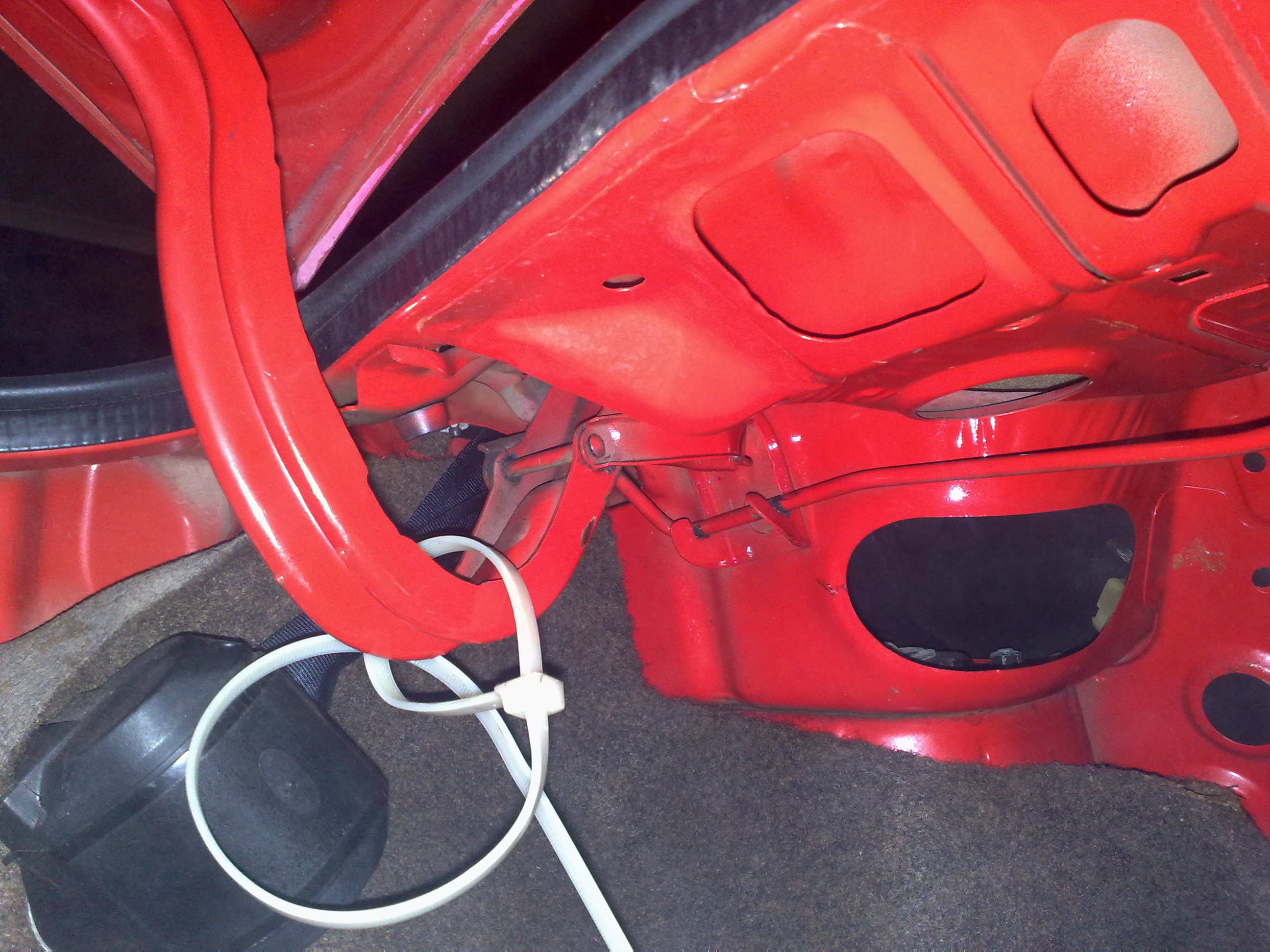

heres sum pics as you can see it wont close and its sumthing to do with the corners of it
soo can anyone help me??? please
G`day mate, its hard to tell from the pics but its worth checking that the latch isn`t actually in the locked position when the boot is open. When you look at the latch it should have a gap that fits over the locking bar on the beaver panel bit. If that gap is not visible, grab a screwdriver/ pliers whatever and simply return it to the open position. Might take a bit of muscle coz its spring loaded.

Does the boot go down to the closed position? or is it jammed up like that on the hinges??
