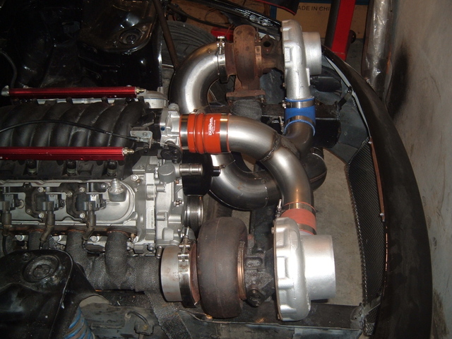

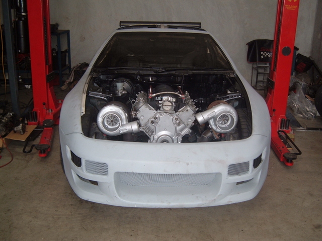

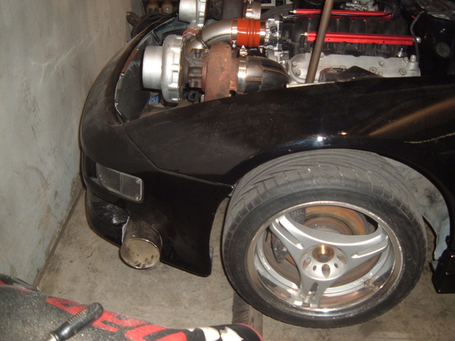

BTW this is another turbo auto I am currently working on:
No BOV's or intercooler, straight turbo to manifold running on methanol.
