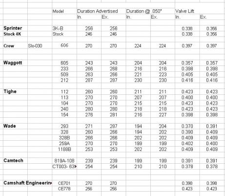

Evan, I hope you are going to put a reground cam in it. Go a Tighe 112. Will wake up an otherwise stock 4k. :D
my machinist gave me a WTF look when i asked if i could send the cam to tighe. i gave him the specs on a tighe 112 and his gonna get a local guy to do it.
i want torque!

hey felix i was recommended a Tighe 104 by Dean from Tighe. reckon that sounds good?

Go for it. :D Will go great in your warm 4k. Should give you a strong midrange to topend.
I found with my old 4k with a tighe 113 (same advertised cam timing, but with a bit less lift than yours) it went hard from 3000-7500 with a similar setup. I ran just under 10:1 CR with 4-1's, some headwork, shimmed valvesprings and a 28/36 DCD.

What would be the best suggested cam grind for a 3k? looking at midrange to topend power..
