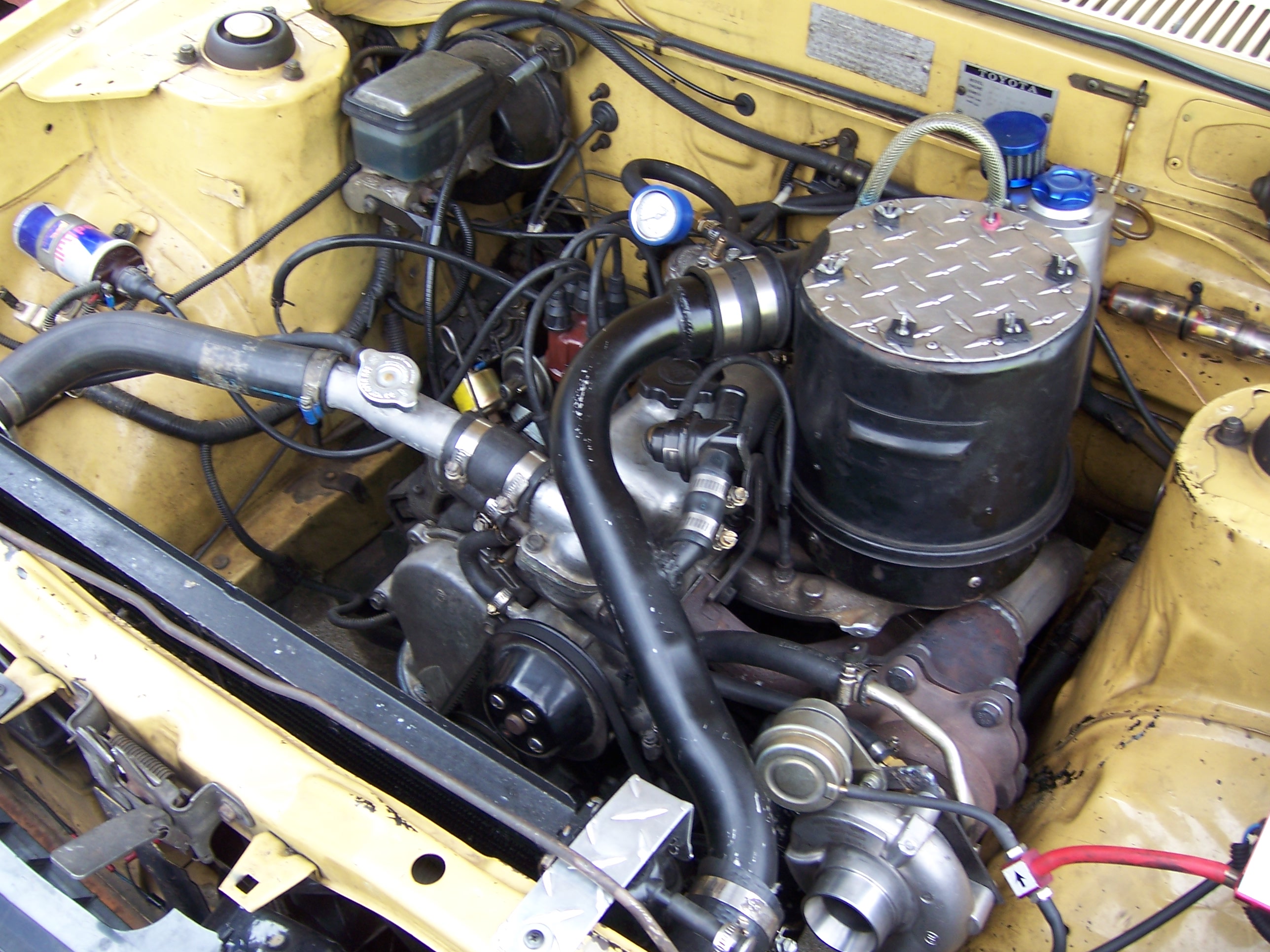

InTrenches Posted May 26, 2010 Report Posted May 26, 2010 who can tell exactly where to install a vacuum gauge along my vacumm line? Quote
Taz_Rx Posted May 26, 2010 Report Posted May 26, 2010 Just on any "post butterfly" (after carby) vacuum source. Quote
InTrenches Posted May 26, 2010 Author Report Posted May 26, 2010 so would way down next to the dizzy be fine? or would it be better to tap into it just under the carby? Quote
Felix Posted May 26, 2010 Report Posted May 26, 2010 You want a manifold vacuum source. You could tee into the line to the vacuum booster for your brakes. Quote
Karllos Posted May 26, 2010 Report Posted May 26, 2010 any of the lines really that are between the (throttle body or butterfly) Quote
Hiro Protagonist Posted May 26, 2010 Report Posted May 26, 2010 You want a manifold vacuum source. You could tee into the line to the vacuum booster for your brakes. As long as you do it before the one-way valve :happy: Quote
Taz_Rx Posted May 26, 2010 Report Posted May 26, 2010 Most 4k/5k manifolds also have a little bolt to block up a hole in the manifold (runner to # 1 or 2). You could also remove that, put in a little fitting and run it as a dedicated vacuum guage feed. Thats where I use to run my boost guage and BOV for the carby setup from. Follow the BOV line to the manifold. :happy: Quote
InTrenches Posted May 26, 2010 Author Report Posted May 26, 2010 Most 4k/5k manifolds also have a little bolt to block up a hole in the manifold (runner to # 1 or 2). You could also remove that, put in a little fitting and run it as a dedicated vacuum guage feed. Thats where I use to run my boost guage and BOV for the carby setup from. Follow the BOV line to the manifold. :happy: very helpful Taz cheers Quote
Grand Master of Awesome Posted May 26, 2010 Report Posted May 26, 2010 ^ coil looks like a redbull can? hahah Quote
Sloth Posted May 26, 2010 Report Posted May 26, 2010 ^ coil looks like a redbull can? hahah Gives the car wings! Quote
InTrenches Posted May 26, 2010 Author Report Posted May 26, 2010 Gives the car wings! it is a red bull can Quote
