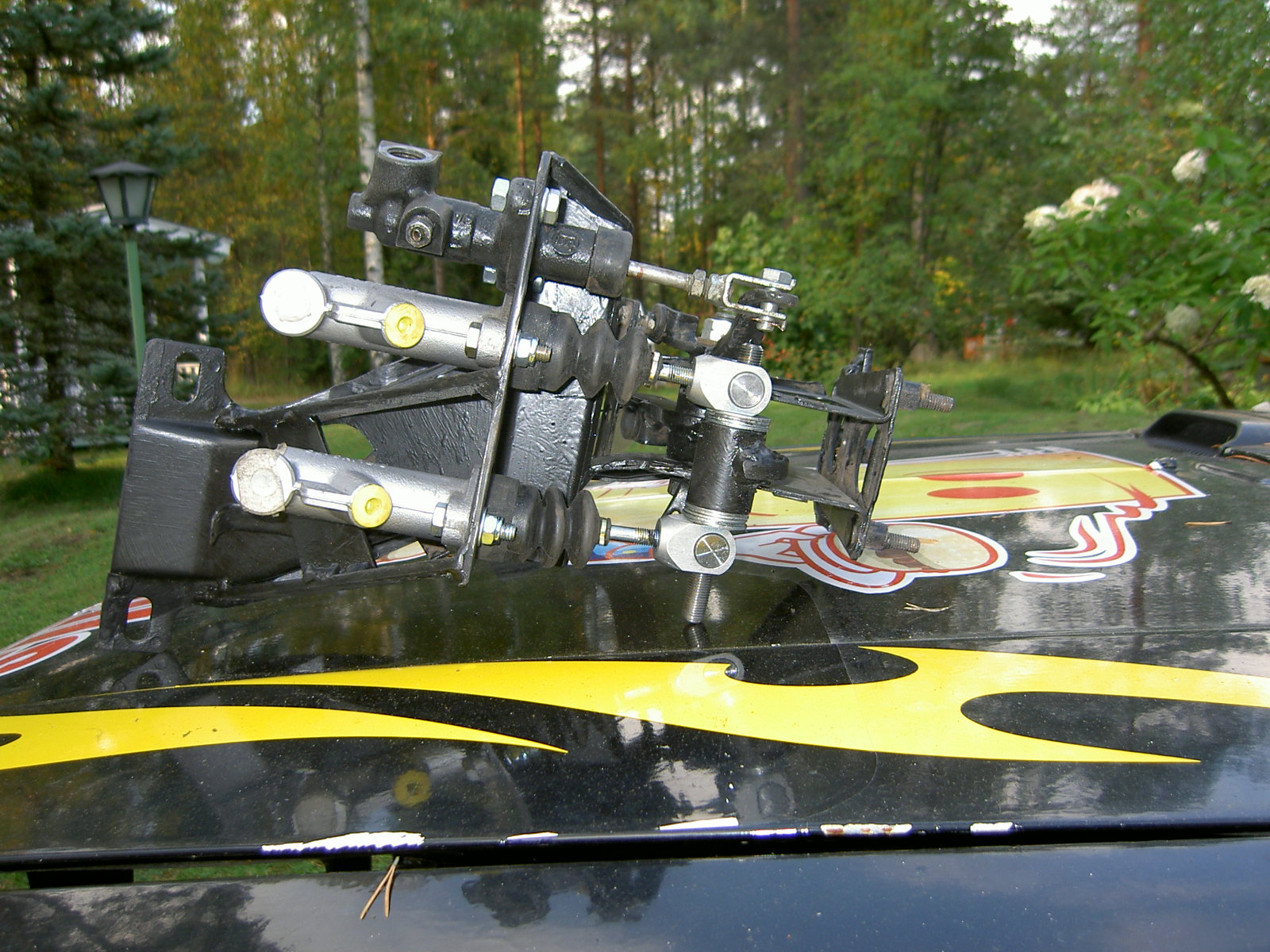

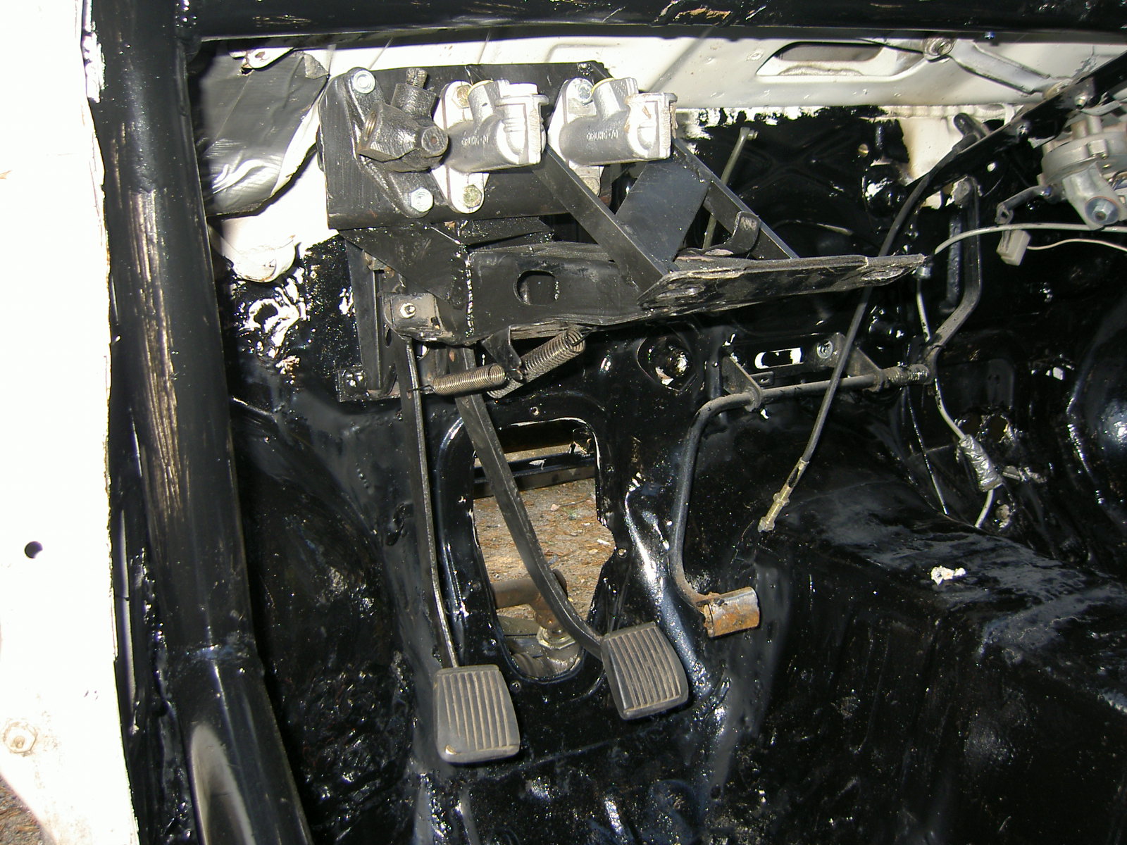

Some progress. Made brake pedalbox and reverse type clutch cylinder mountings.
Rear control arms been made and yesterday tested some 2K liquid urethane for bushings...

nice pedalbox you got there:D
do you have any more pictures of it? I really want to make one for myself!
Yes i have couple, i'll post them later.
Just for notice:On LHD cars you must move windshield wiper motor to passenger side to make room for cylinders.
Edited by Toycrash
As promised.
Edited by Toycrash
