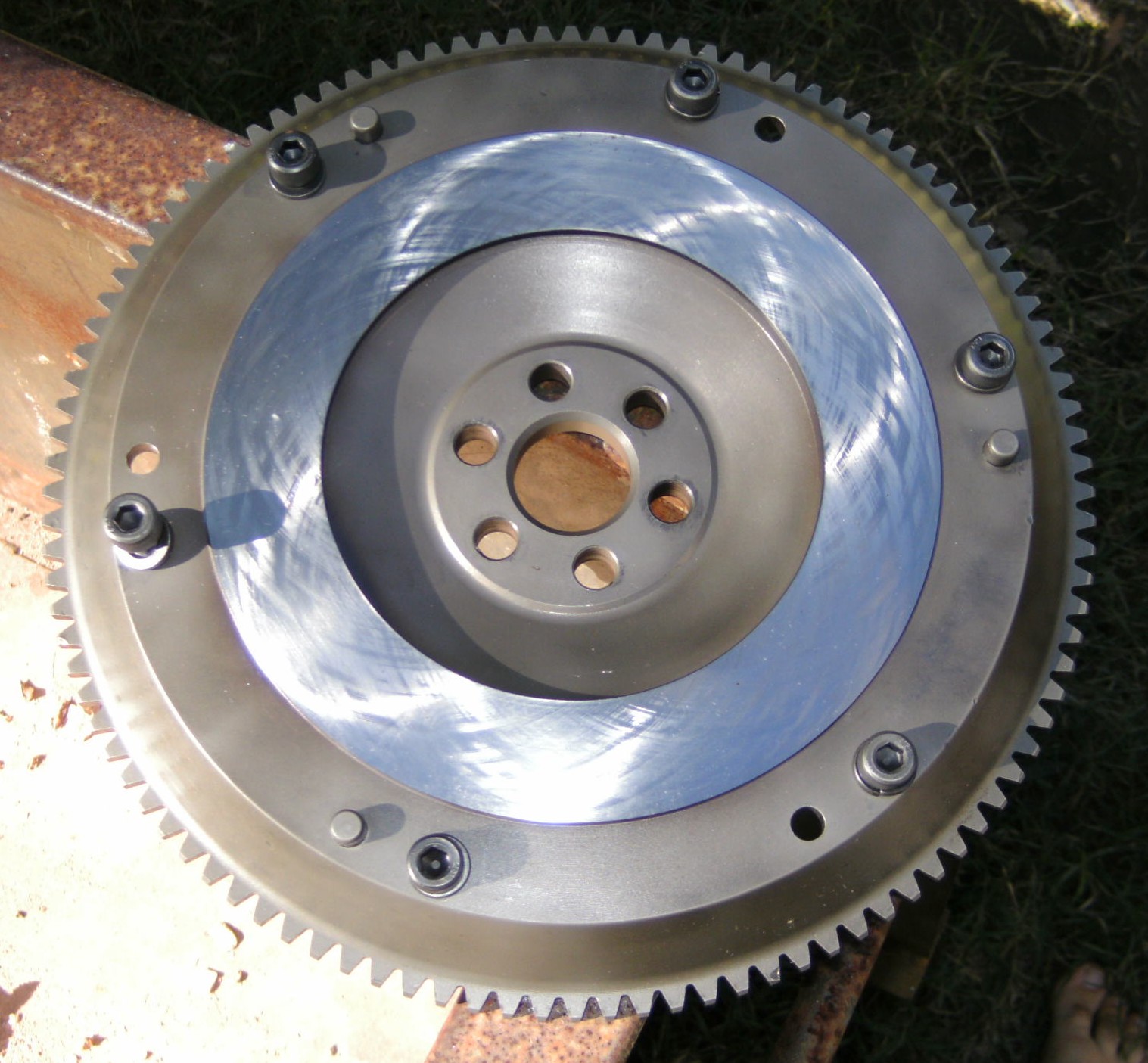

As promised pictures of the flywheel I will be using in my KE15 5K engine build.
It is a JUN flywheel think it is the 3KG one for get exact weight but I didnt go ultra light wheel. The difference between this and ultra light is ultra light one has holes bored through it around the friction area.
You can see they have extra holes drilled for moving the dowel pins for locating the pressure plate problem is they are weld on the back to retain the 3 that are in it atm so I can't move them ;)
So hence I need a late-model pressure plate. And need the early clutch plate to fit early gear box.

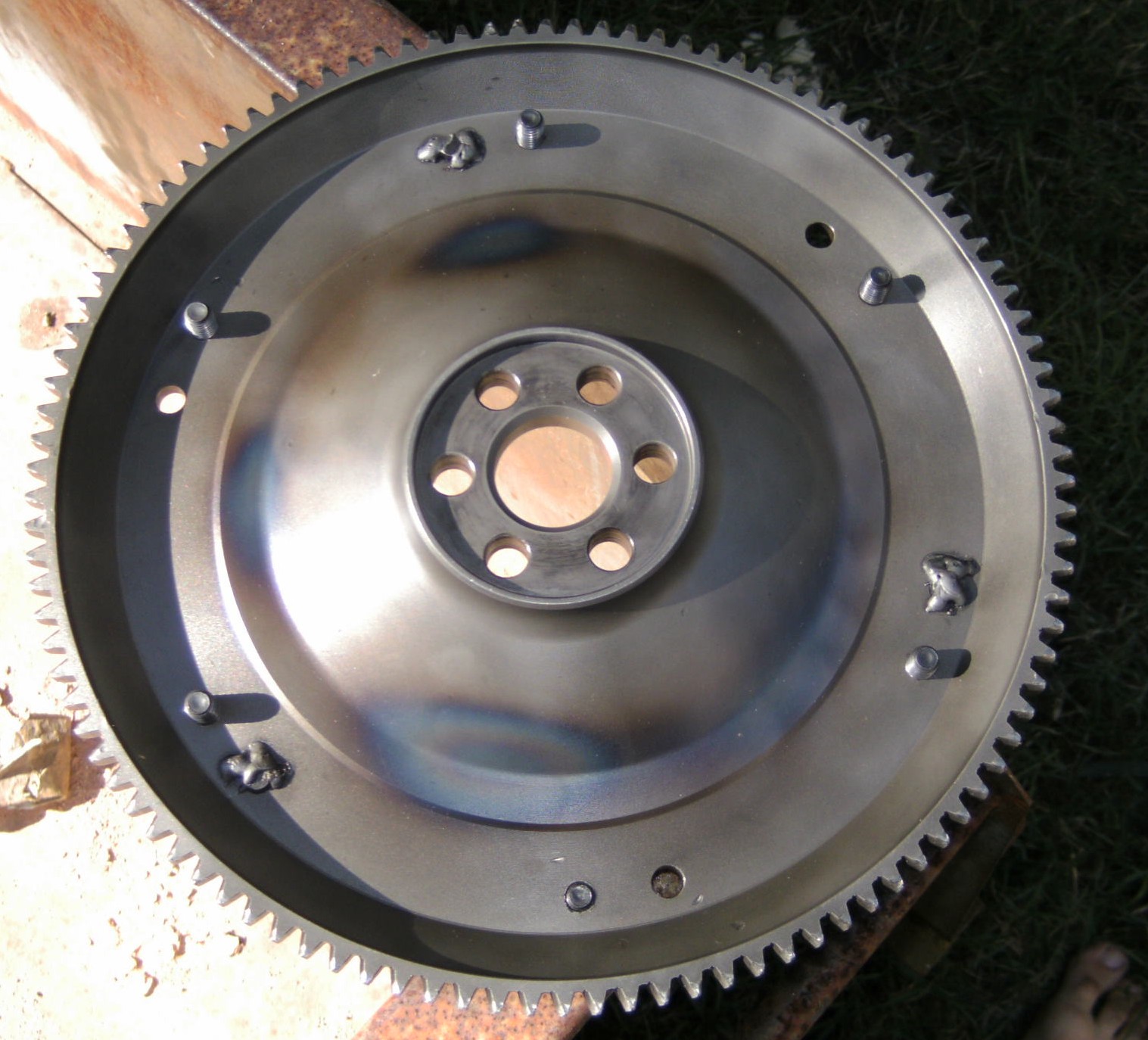

Do you have picatur of the rear of the flywheel? Pretty hawt looking
Here you go there's the back.....This think is thin as and tough as. Has 5000km on it and the friction surface is like NEW.
Back shows some signs of heat but nothing that has killed metal structure.
Can see ring gear teeth are a bit worse for wear but I am in the process of grinding and hand polishing them back to required shape etc at work as I do that for a living a bit so it's a spare time job cleaning it up..LOL
