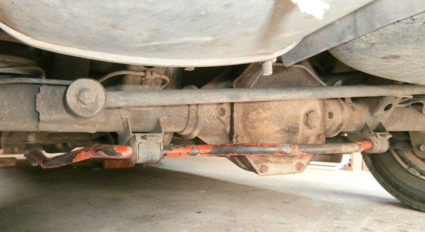

altezzaclub Posted December 16, 2012 Author Report Posted December 16, 2012 Then for my birthday Steve rocked up with a 4.1 diff he'd thrown in the back of his Corona and suffered the oil leak all the way down. We pulled it apart and found no cage on one wheel bearing at all and the oil looked like metallic paint. I said I'd pass on the diff thanks, and while we were collecting springs for the rally car at the wrecker I grabbed photos of the diffs in a couple of Celicas. For $100 I can have an RA40 4.1 or an RA60 3.9. That will get me out of Borgies and into banjo style cases, and if I grab all the arms they will go into the rally Celica when the current bushes are knackered. Quote
